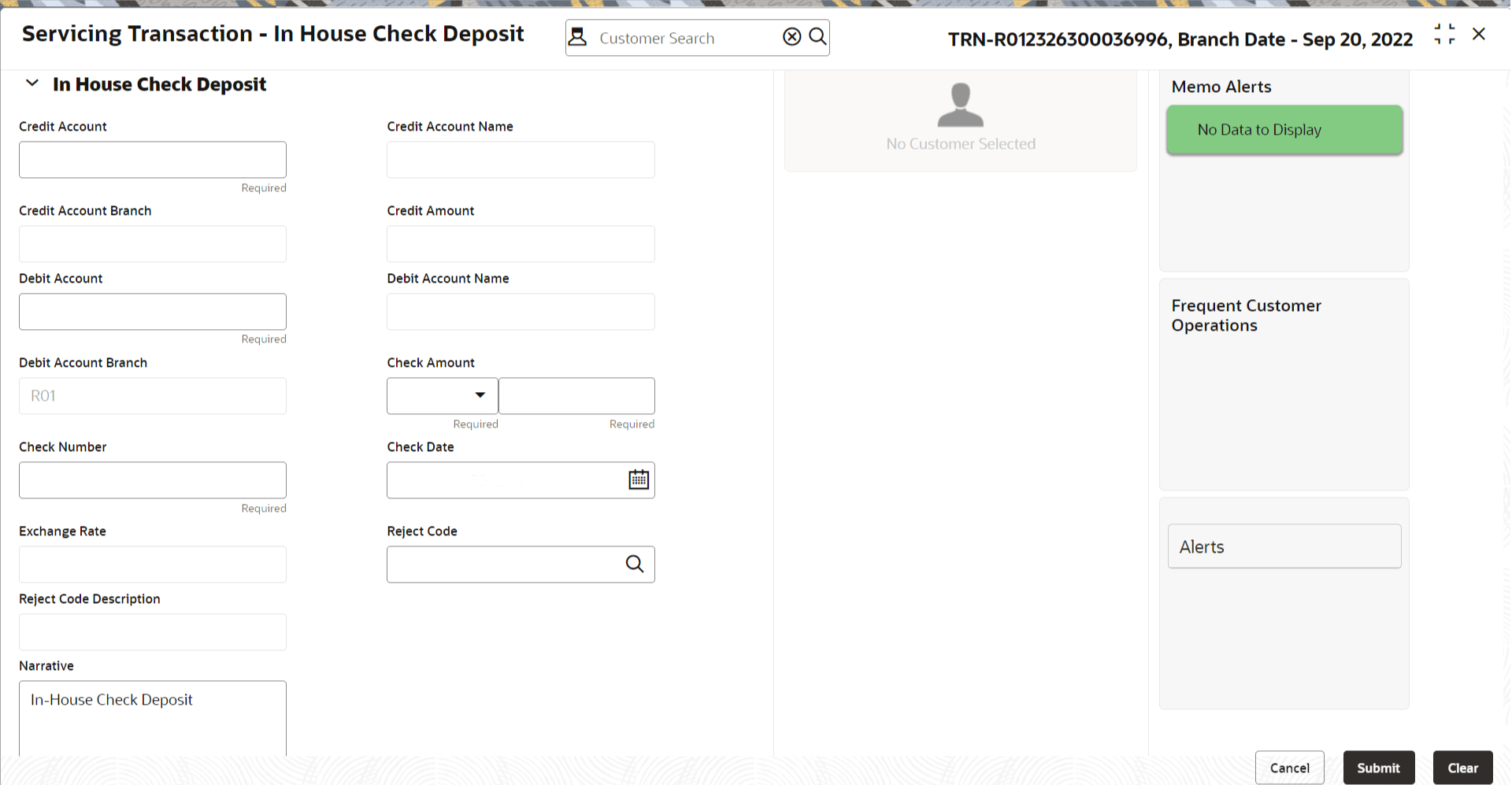

  1. On the Home screen, from Teller mega menu, under Transfers, click In House Check Deposit or specify In House Check Deposit in the search bar and select the screen.
    The In House Check Deposit screen is displayed.
    Figure 3-2 In House Check Deposit
  2. On the In House Check Deposit screen, specify the fields. For more information on fields, refer to the field description table.

  3. Specify the charge details. For information on the fields in the Charge Details segment, refer to Charge Details.
  4. Click Submit.
    A teller sequence number is generated, and the Transaction Completed Successfully information message is displayed.
    The transaction is moved to authorization in case of any warning raised when the transaction saves.
    When user submit, the transaction details are handed off to accounting.
