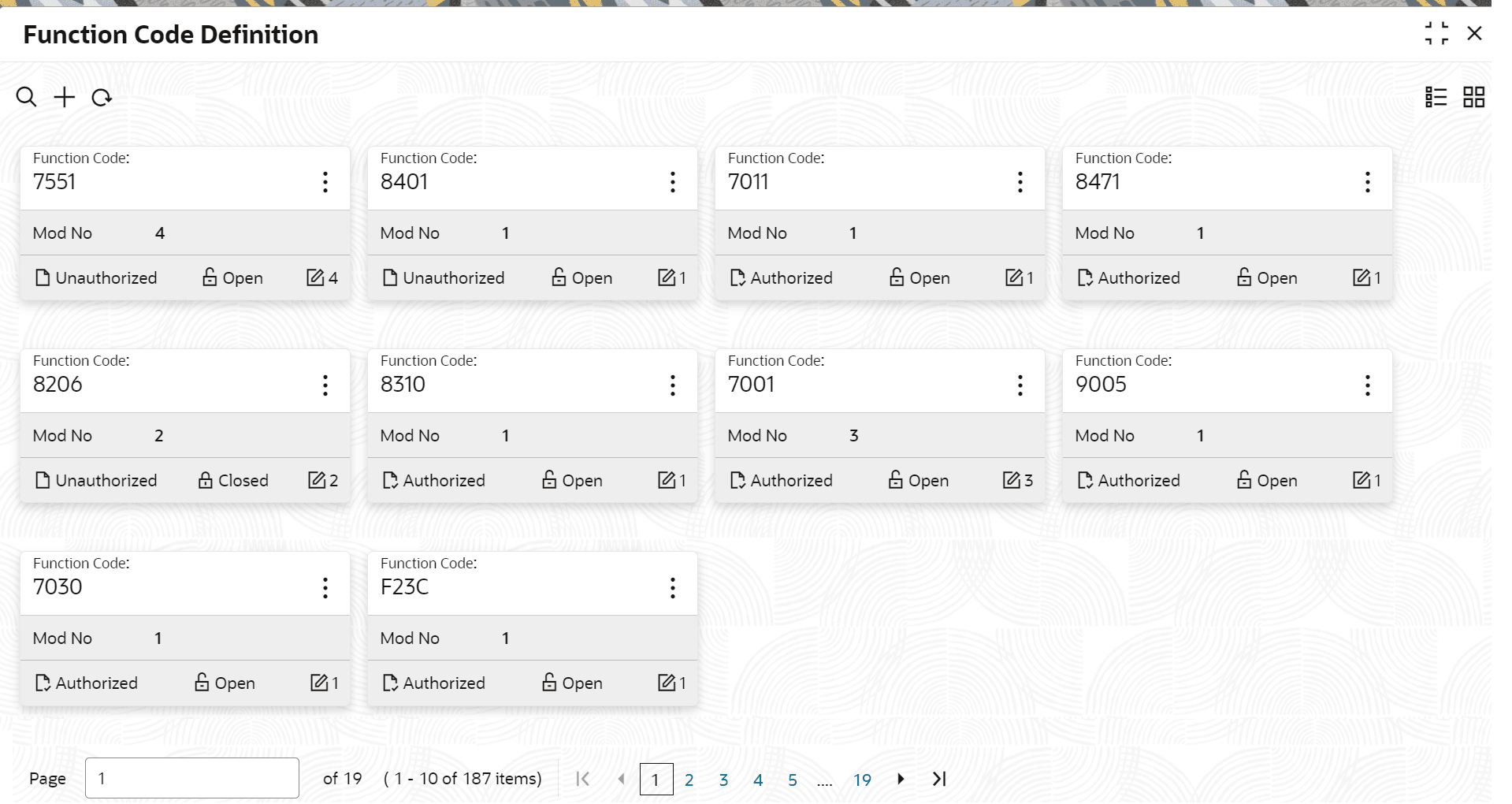

  1. On the Homepage, from Teller mega menu, under Branch Maintenance, click Function Code Definition or specify Function Code Definition in the search bar and select the screen.
    The Function Code Definition summary screen is displayed.
    Figure 10-11 Function Code Definition

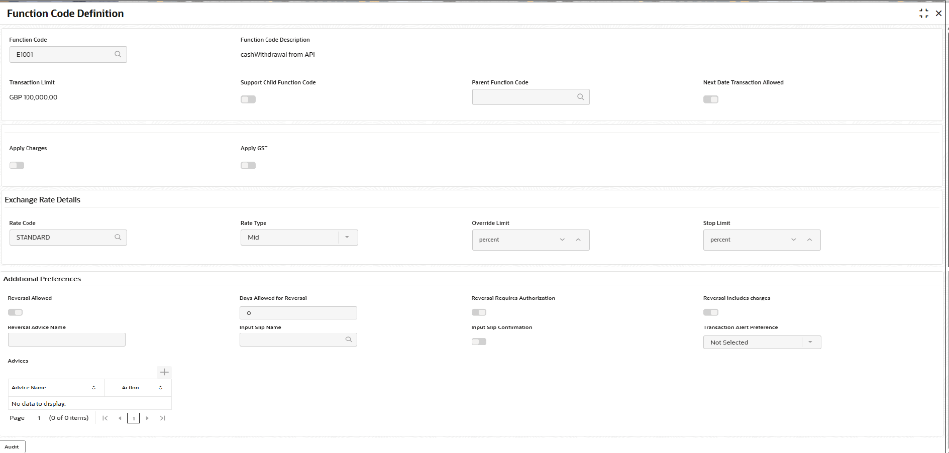

    The Function Code Definition (New) screen is displayed.
    Figure 10-12 Function Code Definition
    In Function Code Definition screen, reversal allowed flag will not be enabled for BC Payment Reversal, DD Payment Reversal, and Cash Remittance Reversal. The system displays an error message stating that the Reversal is not supported, making reversal allowed as N.
  3. On the Function Code Definition screen, specify the fields. For more information on fields, refer to the field description table.

    Table 10-10 Function Code Definition - Field Description
    Field Description
    Function Code
    Select from the list function codes that are factory shipped. For the list of function codes and the respective screen names, refer to List of Function Codes.
    Function Code Description
    Displays the description of the function code.
    Transaction Limit
    Specify the maximum transaction amount allowed for this function code in branch currency.
    Support Child Function Code
    Select if the specified function code needs to act as the parent function code.
    Parent Function Code
    Specify the applicable parent function code.
    This field is enabled only if the Support Child Function Code is not selected.
    Next Date Transaction Allowed
    Select if the next day transaction posting needs to be allowed for the specified function code.
    Charge Details
    Specify the fields.
    Apply Charges
    Specify if charges are applicable for this transaction.
    Exchange Rate Details
    Specify the fields.
    Rate Code
    Select the rate code for the transaction code.
    Rate Type
    Select the rate type for the transaction code.
    Override Limit
    Specify the override limit.
    Stop Limit
    Specify the stop limit.
    Additional Preferences
    Specify the fields.
    Reversal Allowed
    Specify if the reversal is allowed for the transaction.
    Reversal allowed will be disabled for remittances and clearing transactions. Hence, reversal will not be enabled in the journal log.
    Days Allowed for Reversal
    Specify if the Days Allowed for Reversal
    Example: When a Cash Deposit is recorded in the Branch Teller system:
    Max transaction Reversal Days for 1401 = 5
    Archival Days =10
    Transaction Date = 01-Sep-2025
    Max Transaction Reversal Date = 06-Sep-2025
    For a Cash Deposit transaction, the system will allow reversal within a defined window of 5 calendar days from the transaction date.
    The transaction is eligible for reversal within 5 days from the date of posting.
    Example: If the transaction is posted on 01-Sep-2025, it can be reversed until 06-Sep-2025.
    After this period, the transaction will remain viewable in the Journal Log until the 10th day (archival timeline).
    Any reversal attempt beyond the maximum permissible date will trigger a system error indicating that the reversal window has expired.
    Reversal Requires Authorization
    Specify if the authorization is required for a reversal transaction.
    Reversal includes charges
    Specify if the charges are to be reversed along with transaction reversal.
    Reversal Advice Name
    Specify the reversal advice name.
    Input Slip Name
    Specify the input slip name.
    Input Slip Confirmation
    Select if the input slip confirmation is required for the transaction. If this option is selected for a transaction screen, the Input-Slip button will be displayed on the screen.
    On the specified transaction screens, you can click Input-Slip to view the input slip before transaction submission. Once you click Input-Slip, the system validates mandatory fields. In addition, you can perform any of the following actions:
    • Confirm and Print – This icon is enabled only if Input Slip Confirmation is selected in the Function Code Definition screen. In addition, the transaction can be submitted only if the receipt is confirmed. Click this button to confirm and print the receipt.
    • Print – Click Print to print the generated slip and provide it to the customer.
    • Close – Click Close to close the generated receipt.
    If the mandatory fields are not filled, the system shows an error message Value is required, wherever applicable.
    Transaction Alert Preference
    Select the alert notification preference from the drop-down list. The values are mentioned below:
    Email – the system sends an email notification of the transactions to the registered email ID of the customer.
    The setup for Plato alerts needs to be completed and Kafka topics need to be created to enable e-mail alerts. For information on setup, refer to Oracle Banking Branch Installation Guide.
