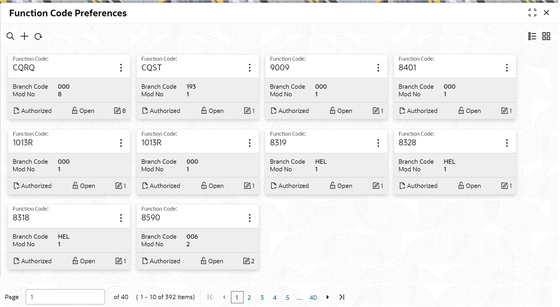

    The Function Code Preferences summary screen is displayed.
    Figure 10-13 Function Code Preferences (Summary)

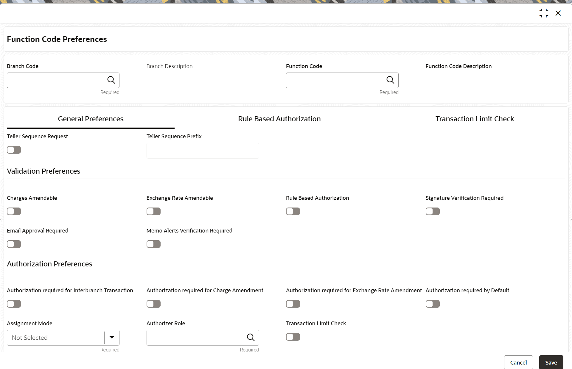

    Figure 10-14 Function Code Preferences

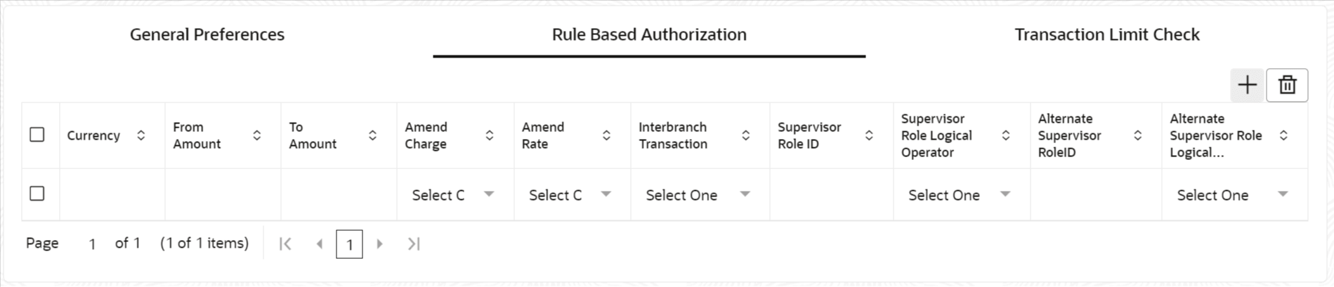

    Figure 10-15 Rule-Based Authorization

  3. On the Function Code Preferences screen, specify the fields. For more information on fields, refer to the field description table.
    The fields marked as Required are mandatory.
    Table 10-13 Function Code Preferences - Field Description
    Field Description
    Branch Code
    Select the branch code from the list of values.
    Note: The list of values should have the *.* for the All option.
    Branch Description
    Displays the description of the branch code.
    Function Code
    Specify the function code. The list of values displays the valid function codes.
    Function Code Description
    Displays the description of the function code.
    General Preferences
    Specify the fields. This segment can be used to configure single-level authorization of the preferences with the use of the Authorizer Role field.
    Teller Sequence Request
    Select this option to generate the Teller sequence number.
    Teller Sequence Prefix
    Specify the prefix for the generation of the Teller sequence number.
    Note: This is mandatory only if the Teller Sequence Request is selected.
    Validation Preferences
    Specify the fields.
    Charges Amendable
    Select if the charges are allowed to modify for the transaction.
    Exchange Rate Amendable
    Select if the exchange rate is allowed to modify for the transaction.
    Select if the rule-based authorization is required for the transaction.
    Note: Assignment mode to be defined as 'Auto' if Rule based auth flag is selected.
    Signature Verification Required
    Select if the Teller needs to verify the customer’s signature while submitting the transaction.
    Email Approval Required
    Select if authorization through email is required for a transaction.
    If this option is selected in override confirmation, then an email will be sent as per the assignment mode maintained. This email will be sent to the selected approver or a list of approvers associated with the role maintained. The approvers will get an email for authorization only if receive email flag is selected in the User Preferences screen. Once the email is received, Approver can either approve or reject the transaction. When you click the Approve or Reject, an email will be automatically opened in the system where the approver can type their comments. The setup for Plato alerts needs to be completed and Kafka topics need to be created to enable e-mail alerts. For information on setup, refer to Oracle Banking Branch Installation Guide.
    Memo Alerts Verification Required Enable this toggle button to enable memo alerts verification which is required during submission of a transaction.
    • If the parameter is ON then the confirmation is required in all screens where the memo is present.
      If the Teller submits the transaction without verifying the memo alerts, then the system displays an error message stating that Please Verify Memo Alerts and Proceed.
    • If the memo is not present for a customer or account, then the transaction will go through without a memo confirmation.
    • If the parameter is OFF then no confirmation is required for memo alerts.
    Authorization Preferences
    Specify the fields.
    Authorization required for Interbranch Transaction
    Select if the authorization is required for the inter-branch transaction.
    Authorization required for Charge Amendment
    Select if the authorization is required in case you have amended the charge defaulted by the system.
    Authorization required for Exchange Rate Amendment
    Select if the authorization is required in case you have amended the exchange rate defaulted by the system.
    Authorization required by Default
    Select if the authorization is required by default for the transaction.
    • To enable a two-step authorization process, maintain the value as Y in the FINISHTXN_ON_APP parameter in the SRV_TM_BC_PARAM_DTLS table.
    • If notification is also required on approval in the two step process, then both the parameters FINISHTXN_ON_APP and TWO_STEP_SYNC need to be enabled.
    Assignment Mode
    Select to indicate whether remote authorization assignment is the automatic or manual operation for the transaction.
    Authorizer Role
    Select the role of the authorizers. The users belonging to this role are the valid authorizers for this workflow.
    Note: This field is applicable, if assignment mode is Manual or if assignment mode is Auto and no default authorizer is maintained for the user.
    Specify the fields. This segment can be used to configure multi-level authorization of the preferences with the use of Supervisor Role ID and Alternate Supervisor Role ID fields.
    Note: Rule Based Authorization cannot be applied for customer servicing transactions.
    Currency
    Select the currency of the transaction from the LOV.
    From Amount
    Specify the From cap amount.
    To Amount
    Specify the To cap amount.
    Amend Charge
    Select from the drop-down values (Yes, No or Both).
    Amend Rate
    Supervisor Role ID
    Select the supervisor role ID from the list of values. The following conditions apply to this field:
    • More than one role can be added for authorization.
    • If multiple roles are added, it is not mandatory to authorize in sequential order of the roles added.
    • The roles added in this field are considered for the primary level of authorization.
    Supervisor Role Logical Operator
    Select the logical operator AND or OR. If AND is chosen, all the Supervisor role specified in primary path has to authorize the transaction. If OR is chosen, either of the Supervisor role has to authorize the transaction.
    Select the alternate role ID from the list of values. The following conditions apply to this field:
    • The roles added in this field are considered for the secondary level of authorization.
    Alternate Supervisor Role Logical Operator
