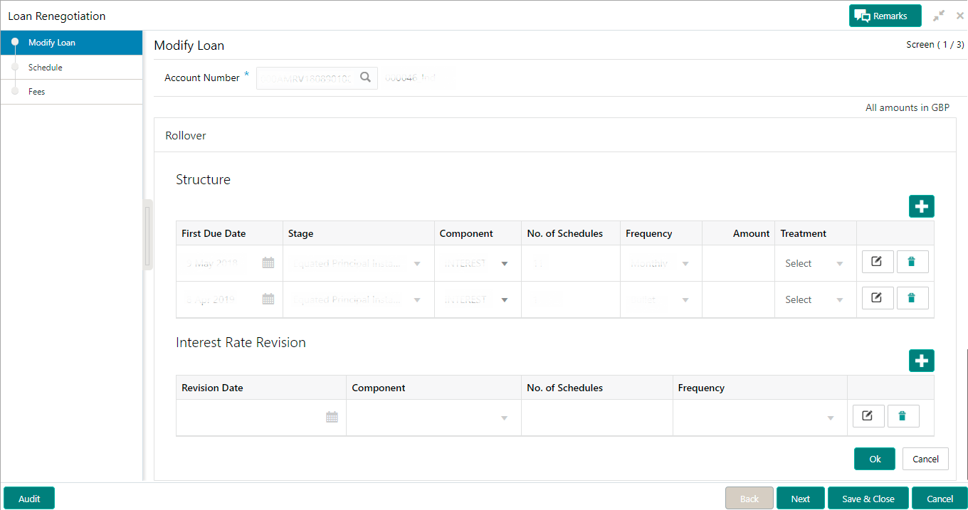

To modify the rollover details:
- Navigate to the screen and fetch the account. For more information, refer Navigating and Fetching Account.
- Click the Rollover link.The Rollover section is displayed.
The Rollover link will not be enabled, if you have performed any action on the Modify Schedule section and committed the changes.Note:
By default, the existing schedule details are displayed in the Structure and Interest Rate Revision section. - From the Structure or Interest Rate
Revision section, click the
icon from the Action field. For more information
on fields, refer to field description table below:Table 6-8 Rollover – Field Description
Field Description Structure This section displays the schedule structure. First Due Date Specify the due date on which the schedule installment is due. Stage Select the applicable loan stage. For amortized loan account, the following are the options: - Equated Principal Installment

<Action> Displays the actions you can perform on the structure details. The following icons are displayed:
: You can click this icon, to edit the
details in a row.
: You can click this icon, to delete the
row.
: You can click this icon, to confirm the
details added in the row.
Interest Rate Revision This section the revision schedule for interest rates. Revision Date Select or specify the date on which the revised interest rate is applied for the account. Component Select the loan component on which revised interest rate is applicable. No. of Schedules Specify the number of schedules for which revised interest rate is applicable. Frequency Select the frequency of rate revision. The options are: - Monthly
- Quarterly
- Half Yearly
- Yearly
details in a row.
row.
- You can add new row by following the steps below:
Interest Rate Revision section, click
the
icon.
- Select or specify the details as required.
- From the Action field, click
the
icon.
The details are added successfully.
the
- Click OK.
