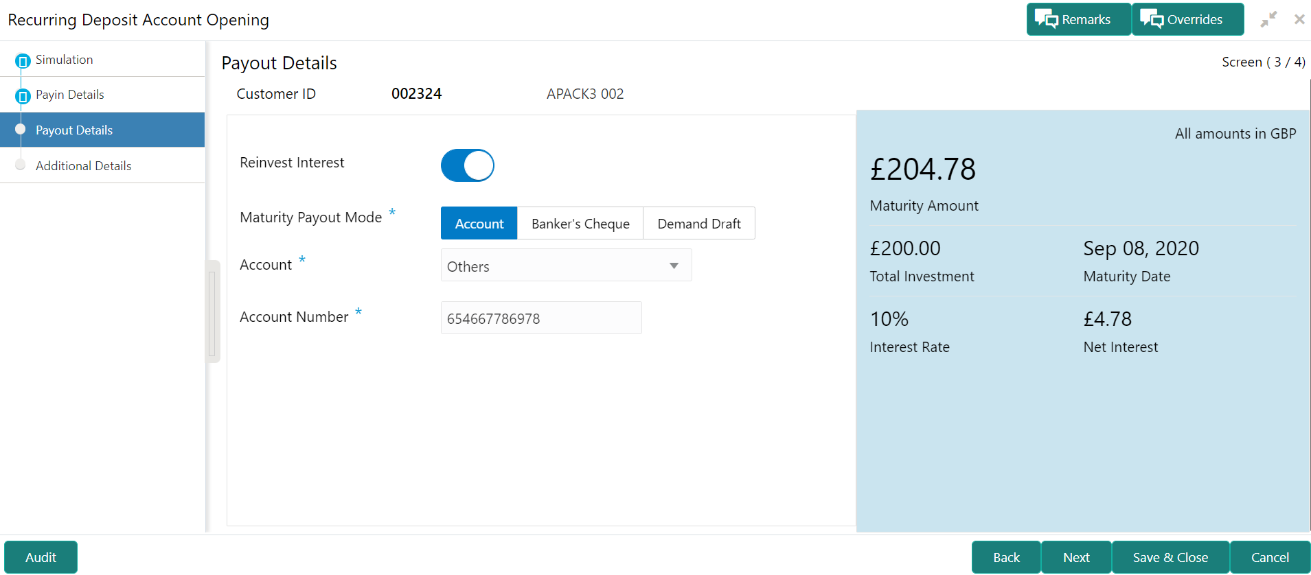

- Reinvest Interest Enabled
- Swtich to
from the Reinvest Interest field. - Select or specify the details as required. For more information on fields, refer to the field description
table.
Table 5-5 Payout Details – Reinvest Interest Enabled - Field Description
Field Description Reinvest Interest
Switch to
to reinvest the interest in RD.
Maturity Payout Mode
Select the maturity payout mode. The options are:- Account
- Banker's Cheque
- Demand Draft
Account
Select the type of account.Note:
This field is displayed if Account option is selected from the Maturity Payout Mode field.Account Number
Specify the CASA account number.Note:
This field is displayed if Others option is selected from the Account field.Payable Branch
Select the banker's cheque payable branch.Note:
This field is displayed if Banker's Cheque or Demand Draft option is selected from the Maturity Payout Mode field.

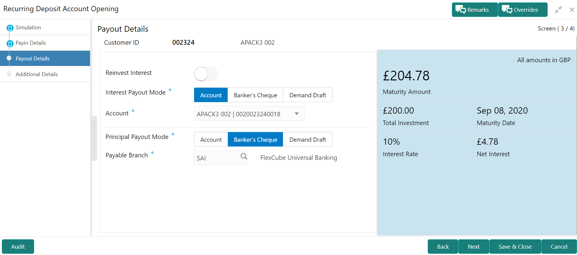

- Reinvest Interest Not Enabled
- Swtich to
table.
Table 5-6 Payout Details – Reinvest Interest Not Enabled – Field Description
Switch to
to be paid out the interest.
The interest amount is paid out during interest liquidations.Interest Payout Mode Select the maturity payout mode. The options are:- Account
- Banker's Cheque
- Demand Draft
Account
This field is displayed if Account option is selected from the Interest Payout Mode field.Account Number
This field is displayed if Banker's Cheque or Demand Draft option is selected from the Interest Payout Mode field.Principal Payout Mode Select the principal payout instructions for the deposit.
Amount Specify the special renewal amount.Note:
- This field is enabled only if Special Amount Renewal option is selected from the Maturity Instructions field.
- Also, the TD currency will be defaulted and not enabled.
Account
This field is displayed if Account option is selected from the Principal Payout Mode field.Account Number
- This field is displayed if Banker's Cheque or Demand Draft option is selected from the Principal Payout Mode field.
- For more information on the Payable Branch section, refer Fetch Payable Branch.
