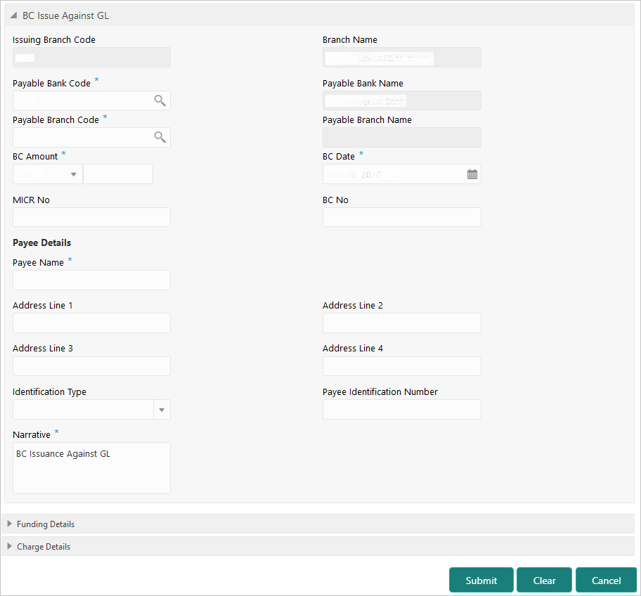

BC Issue Against GL
The Teller can use the BC Issue Against GL screen to issue a BC against a GL account.
To issue a BC against a GL account:
  1. On the Homepage, from Teller mega menu, under Remittances, click BC Issue - GL or specify BC Issue - GL in the search icon bar and select the screen.
    The BC Issue Against GL screen is displayed.
  2. On the BC Issue Against GL screen, specify the fields. For more information on fields, refer to the field description table.
    Table 8-5 BC Issue Against GL - Field Description
    Field Description
    Issuing Branch Code
    Displays the logged-in branch code.
    Branch Name
    Displays the description of issuing branch.
    Payable Bank Code
    Select the payable bank code. The list of values contains the bank codes maintained using the External Bank Code Maintenance screen.
    To remit funds within the same bank, select the logged-in bank code as payable bank code. To remit funds across banks, select the necessary bank code as payable bank code. The fields Payable Branch Code and Payable Branch Name will be enabled after you specify the Payable Bank Code.
    Payable Bank Name
    Displays the name of the selected bank code.
    Payable Branch Code
    Select the branch code of the payable bank. The list of values contains the corresponding branch codes maintained using the Bank Code Maintenance screen.
    Payable Branch Name
    Displays the branch name of the selected branch code.
    BC Amount
    Select the BC currency from the drop-down list and the BC amount.
    BC Date
    Select the date that needs to be mentioned in the BC.
    By default, the current posting date is displayed.
    BC No
    Specify the instrument number and validate.
    If not specified, the system generates the BC number based on the maintenance setup.
    MICR Number
    Displays the MICR number.
    Payee Details
    Specify the fields.
    Payee Name
    Specify the payee name on which the BC is drawn.
    Address Line 1 to Address Line 4
    Specify the address of the payee.
    Identification Type
    Select the identification type of the payee from the drop-down list.
    Payee Identification Number
    Specify the identification number of the payee.
    Narrative
    Displays the default narrative as BC Issuance Against GL, and it can be modified.
