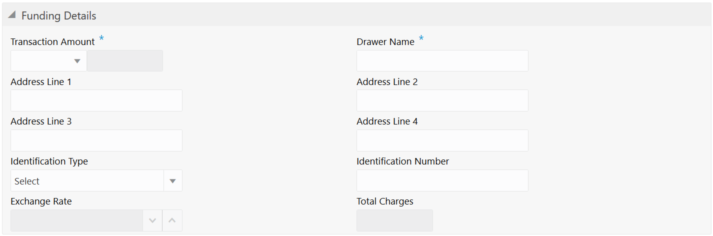

  3. Click on the Funding Details data segment.
    The Funding Details data segment is displayed.
  4. In the Funding Details data segment, specify the fields. For more information on fields, refer to the field description table.
    Table 8-4 Funding Details - Field Description
    Field Description
    Transaction Amount
    Specify the transaction currency in which the walk-in customer deposits the cash.
    Drawer Name
    Specify the name of the drawer.
    Address Line 1 to Address Line 4
    Specify the address of the payee.
    Identification Type
    Select the identification type of the payee from the drop-down list.
    Identification Number
    Specify the identification number of the payee.
    Exchange Rate
    Displays the exchange rate.
    If the transaction currency is the same as the account currency, the system will display the exchange rate as 1. This field is displayed only if Multi-Currency Configuration at the Function Code Indicator level is set as Y.
    Total Charges
    Displays the total charges applicable for the BC issuance.
    This field is displayed only if Total Charges Configuration at Function Code Indicator level is set as Y.
