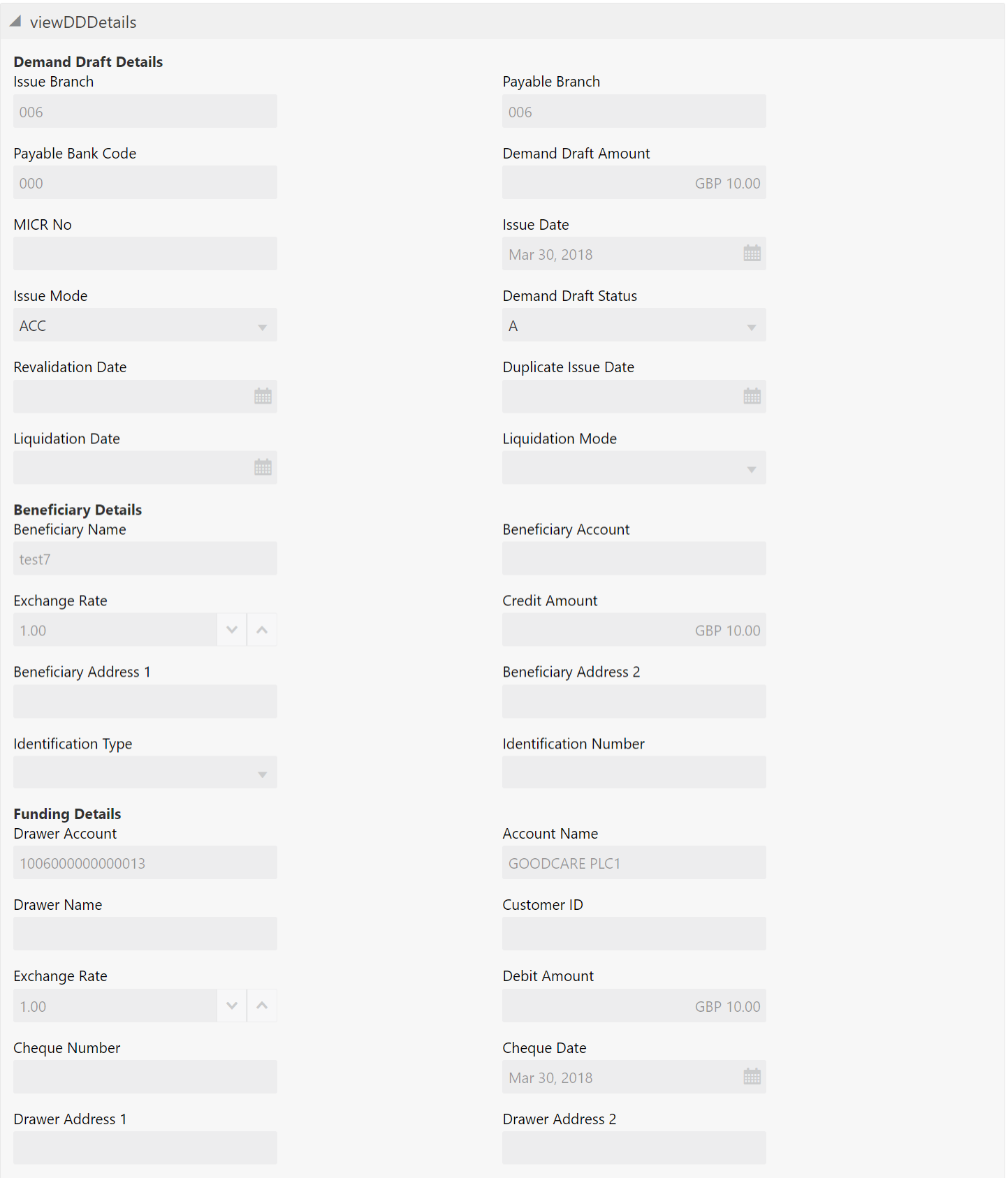

  4. Click on the View Demand Draft Details data segment to view the additional details of the DD when the issue mode as account.
    Figure 8-50 View DD Details (Revalidate DD Issued by Account)
  5. On the View DD Details screen, view the fields. For more information on fields, refer to the field description table.
    Table 8-44 View DD Details (Revalidate DD Issued by Account)
    Field Description
    Demand Draft Details Displays the demand draft details.
    Issue Branch Displays the branch code.
    Payable Branch Displays the payable branch for the DD.
    Payable Bank Code Displays the payable bank code.
    Demand Draft Amount Displays the DD currency and the DD amount.
    MICR No Displays the MICR number.
    Issue Date Displays the issue date mentioned in the DD.
    Issue Mode Displays the issue mode as Account.
    Demand Draft Status Displays the status of the DD.
    Revalidation Date Displays the date of DD revalidation.
    Duplicate Issue Date Displays the duplicate issue date of DD.
    Liquidation Date Displays the liquidation date of DD.
    Liquidation Mode Displays the liquidation mode of DD.
    Beneficiary Details Displays the fields.
    Beneficiary Name Displays the beneficiary's name.
    Beneficiary Account Displays the beneficiary account number.
    Exchange Rate Displays the exchange rate.
    If the transaction currency is the same as the account currency, the system will display the exchange rate as 1.
    Credit Amount Displays the credit amount.
    Beneficiary Address 1 and Beneficiary Address 2 Displays the address of the beneficiary.
    Identification Type Displays the identification type of the beneficiary.
    Identification Number Displays the identification number of the beneficiary.
    Funding Details Funding details are displayed under this segment.
    Drawer Account Displays the account number of the customer who has requested the DD.
    Account Name Displays the name of the drawer account.
    Drawer Name Displays the drawer name.
    Customer ID Displays the customer ID of the drawer.
    Debit Amount Displays the amount that needs to be debited from the drawer account.
    Cheque Number Displays the cheque number.
    Cheque Date Displays the date mentioned in the cheque.
    Drawer Address 1 and Drawer Address 2 Displays the address of the drawer.
