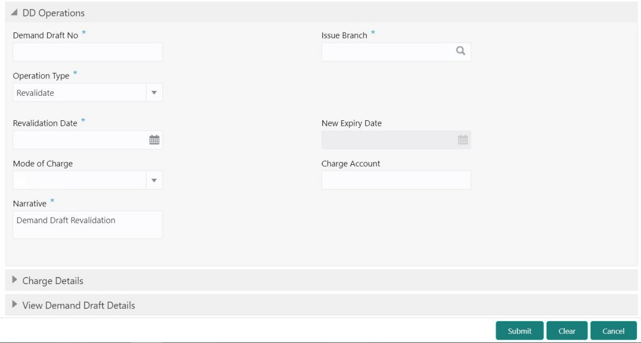

  1. On the Homepage, from Teller mega menu, under Remittances, click DD Operations or specify DD Operations in the search icon bar and select the screen.
    The DD Operations screen is displayed.
    Figure 8-51 DD Operations - Revalidate
  2. On the DD Operations screen, specify the fields. For more information on fields, refer to the field description table.
    The fields, which are marked with an asterisk, are mandatory.
    Table 8-45 DD Operations (Revalidate) - Field Description
    Field Description
    Demand Draft No
    Specify the DD number of the instrument.
    Issue Branch
    Select the branch code where the instrument is issued from the LOV.
    Operation Type
    Select the type Revalidate from the drop-down list.
    Revalidation Date
    Select the revalidation date.
    By default, the system date is displayed as a revalidation date.
    New Expiry Date
    Displays the new expiry date based on the specified revalidation date.
    Mode of Charge
    Select the mode of charge from the drop-down values (Account or Cash).
    Charge Account
    Specify the charge account number. The following conditions apply based on the value selected for Mode of Charge:
    • If the Mode of Charge is selected as Account, the user needs to capture the account from which the charges are to be deducted.
      If the Mode of Charge is selected as Account, the system displays the Drawer Account by default. Else, this field is kept blank and the user can input the valid account number.
    • If Mode of Charge is selected as Cash, the user needs to capture Charge Currency, and denomination details to be picked up based on the charge currency specified.
    Narrative
    Displays the default narrative as Demand Draft Revalidation, and it can be modified.

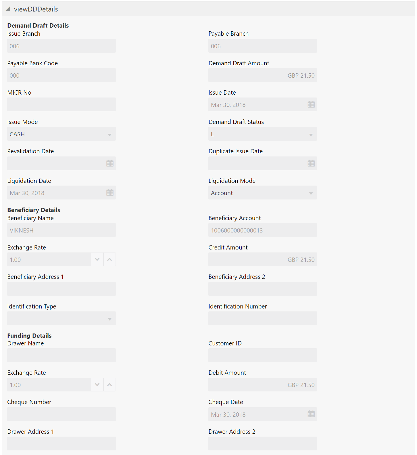

  4. Click on the View Demand Draft Details data segment to view the additional details of the DD when the issue mode as cash.
    Figure 8-52 View DD Details (Revalidate DD Issued by Cash)
  5. On the View DD Details screen, view the fields. For more information on fields, refer to the field description table.
    Table 8-46 View DD Details (Revalidate DD Issued by Cash)
    Field Description
    Demand Draft Details Displays the demand draft details.
    Issue Branch Displays the branch code.
    Payable Branch Displays the payable branch for the DD.
    Payable Bank Code Displays the payable bank code.
    Demand Draft Amount Displays the DD currency and the DD amount.
    MICR No Displays the MICR number.
    Issue Date Displays the issue date mentioned in the DD.
    Issue Mode Displays the issue mode as Cash.
    Demand Draft Status Displays the status of the DD.
    Revalidation Date Displays the date of DD revalidation.
    Duplicate Issue Date Displays the duplicate issue date of DD.
    Liquidation Date Displays the liquidation date of DD.
    Liquidation Mode Displays the liquidation mode of DD.
    Beneficiary Details Displays the fields.
    Beneficiary Name Displays the beneficiary's name.
    Beneficiary Account Displays the beneficiary account number.
    Exchange Rate Displays the exchange rate.
    If the transaction currency is the same as the account currency, the system will display the exchange rate as 1.
    Credit Amount Displays the credit amount.
    Beneficiary Address 1 and Beneficiary Address 2 Displays the address of the beneficiary.
    Identification Type Displays the identification type of the beneficiary.
    Identification Number Displays the identification number of the beneficiary.
    Funding Details Funding details are displayed under this segment.
    Drawer Name Displays the drawer name.
    Customer ID Displays the customer ID of the drawer.
    Debit Amount Displays the amount that needs to be debited from the drawer account.
    Cheque Number Displays the cheque number.
    Cheque Date Displays the date mentioned in the cheque.
    Drawer Address 1 and Drawer Address 2 Displays the address of the drawer.
