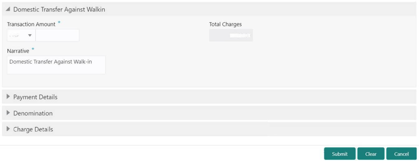

    Figure 6-5 Domestic Transfer Against Walk-in
  2. On the Domestic Transfer Against Walk-in screen, specify the fields. For more information on fields, refer to the field description table.
    Table 6-5 Domestic Transfer Against Walkin - Field Description
    Field Description
    Transaction Amount
    Select the transaction currency from the drop-down list. Specify the transaction amount that needs to be transferred.
    Total Charges
    Displays the total charge amount, which is computed by the system.
    This field is displayed only if Total Charges Configuration at the Function Code Indicator level is set as Y.
    Narrative
    Displays the default narrative as Domestic Transfer Against Walkin, and it can be modified.
