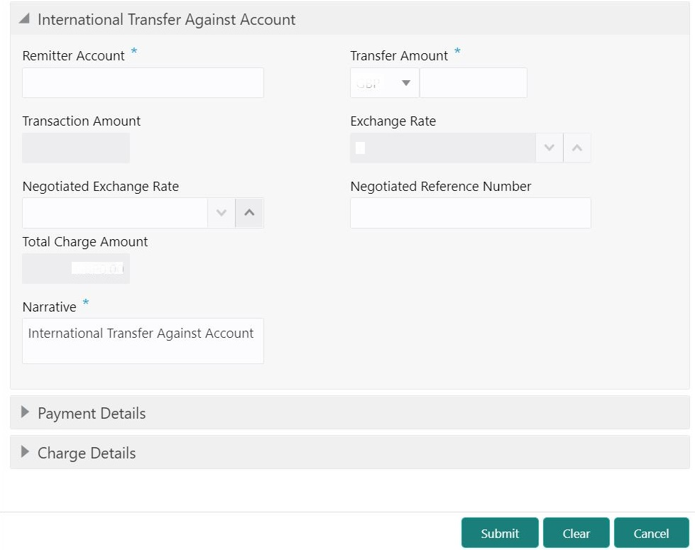

Figure 6-6 International Transfer Against Account
- On the International Transfer Against Account screen,
specify the fields. For more information on fields, refer to the field description
table.
The fields, which are marked with an asterisk, are mandatory.Table 6-6 International Transfer Against Account - Field Description
Field Description Remitter Account
Specify the customer account from which the funds need to be debited.
Transfer Amount
Specify the transfer account currency and the transfer amount that needs to be debited from the customer account.
Negotiated Exchange Rate
Specify the negotiated exchange rate if it is needed to perform the transaction using negotiated value.Note:
This field is applicable only if the transaction involves cross currency. If this option is selected, the Negotiated Reference Number field will become mandatory.Negotiated Reference Number
Specify the reference number for the negotiated cost rate.Note:
This field is applicable only if the transaction involves cross currency.Transaction Amount
Displays the remitter account currency based on the account number selected and the transaction amount based on the exchange rate.Note:
This field is displayed only ifMulti-Currency Configuration
at the Function Code Indicator level is set as Y.Exchange Rate
Displays the exchange rate used to convert the transfer account currency into credit account currency, and it can be modified.Note:
If the transfer currency is the same as the account currency, the system displays the exchange rate as 1. This field is displayed only ifMulti-Currency Configuration
at the Function Code Indicator level is set as Y.Total Charge Amount
Displays the total charge amount, which is computed by the system.Note:
at the Function Code Indicator level is set as Y.Narrative
Displays the default narrative as International Transfer Against Account, and it can be modified. - Specify the payment details. For information on the fields in the Payment Details segment, refer to Add Payment Details for International Transfer.
