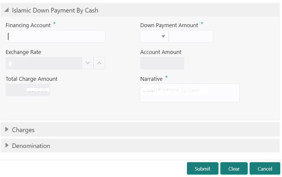

    Figure 12-2 Islamic Down Payment by Cash
  2. On the Islamic Down Payment by Cash screen, specify the fields. For more information on fields, refer to the field description table.
    Table 12-2 Islamic Down Payment by Cash - Field Description
    Field Description
    Financing Account
    Specify the financing account number. When you press the Tab key, the customer details and financing account details will be displayed in the Customer Information widget.
    Down Payment Amount
    Select the down payment currency and specify the amount.
    By default, the down payment currency is displayed as financing account currency. If the Multi-Currency Configuration at the Function Code indicator level is set as Y, it can be modified, and if it is N, then the default value cannot be modified.
    Exchange Rate
    Displays the exchange rate.
    If the transaction currency is the same as the account currency, the system displays the exchange rate as 1. This field is displayed only if Multi-Currency Configuration at the Function Code indicator level is set as Y.
    Total Charges
    Displays the total charges in the branch local currency.
    Account Amount
    Displays the down payment amount in loan account currency. This amount will be derived based on the Down Payment Amount and Exchange Rate.
    Narrative
    Displays the narrative as Islamic Down Payment By Cash, and it can be modified.
