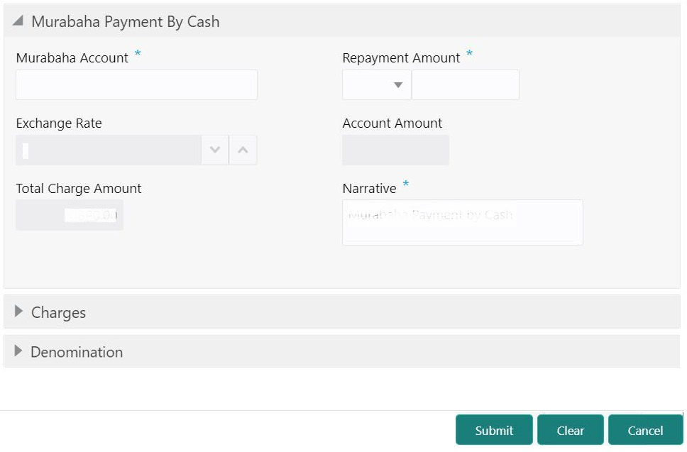

    Figure 12-1 Murabaha Payment by Cash
  2. On the Murabaha Payment by Cash screen, specify the fields. For more information on fields, refer to the field description table.
    Table 12-1 Murabaha Payment by Cash - Field Description
    Field Description
    Murabaha Account
    Specify the Murabaha account number. When you press the Tab key, the customer details and Murabaha account details will be displayed in the Customer Information widget.
    Repayment Amount
    Select the repayment currency and specify the repayment amount.
    By default, the repayment currency is displayed as financing account currency. If the Multi-Currency Configuration at the Function Code indicator level is set as Y, it can be modified, and if it is N, then the default value cannot be modified.
    Exchange Rate
    Displays the exchange rate.
    If the transaction currency is the same as the account currency, the system displays the exchange rate as 1. This field is displayed only if Multi-Currency Configuration at the Function Code indicator level is set as Y.
    Total Charge Amount
    Displays the total charges in the branch local currency.
    Account Amount
    Displays the repayment amount in loan account currency. This amount will be derived based on the Repayment Amount and Exchange Rate.
    Narrative
    Displays the narrative as Murabaha Payment By Cash, and it can be modified.
  3. Specify the charge details. For information on the fields in the Charge Details segment, refer to Add Charge Details.
  4. Specify the denomination details. For information on the fields in the Denomination segment, refer to Add Denomination Details.
