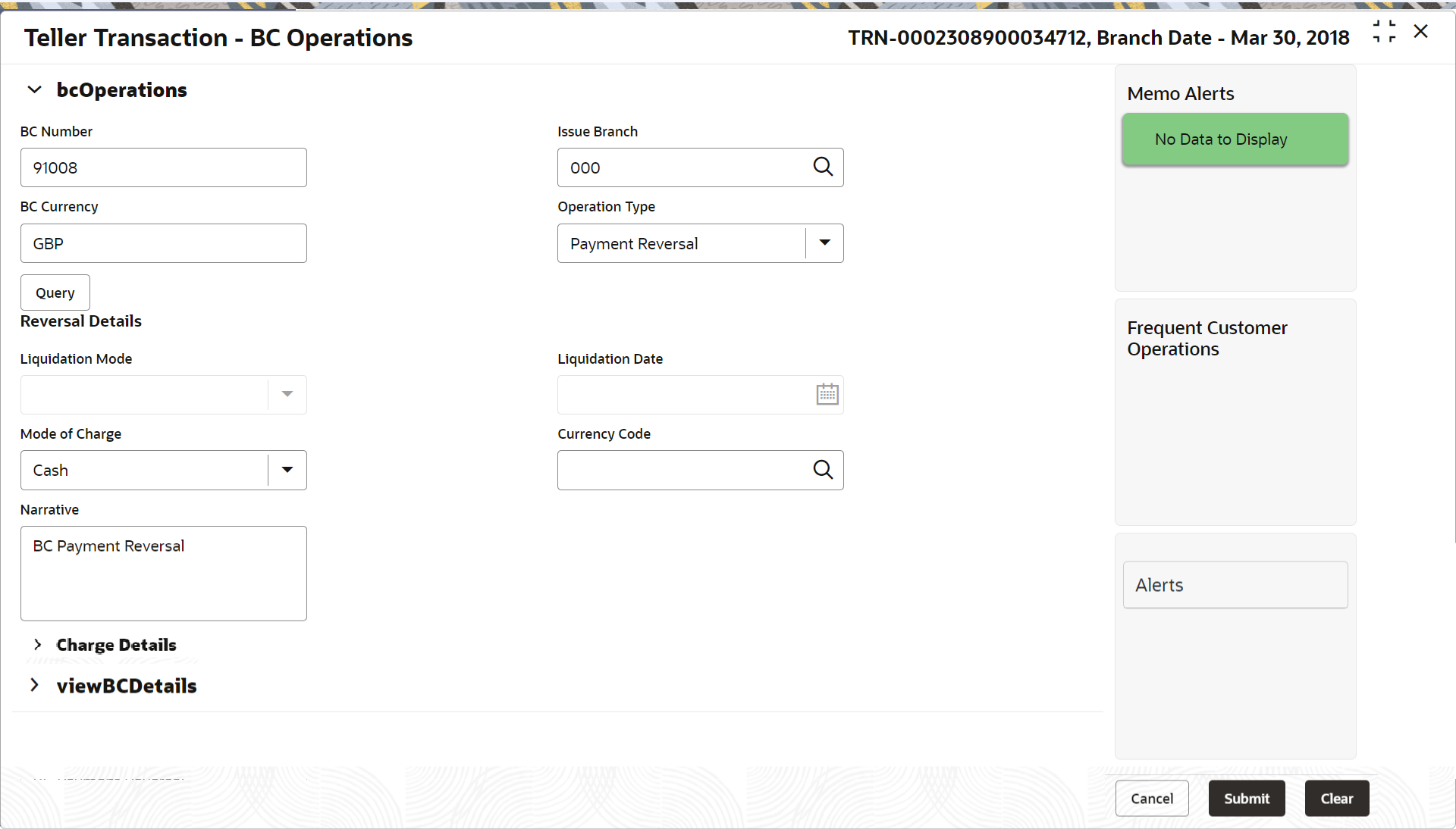

Figure 8-11 BC Operations - Payment Reversal
- On the BC Operations screen, specify the fields. For more information on fields, refer to the field description
table.
The fields marked as Required are mandatory.Table 8-11 BC Operations (Payment Reversal) - Field Description
Field Description BC No
Specify the BC number of the instrument.
Issue Branch
Select the branch code where the instrument is issued from the LOV.
Operation Type
Select the type Payment Reversal from the drop-down list.
Reversal Details
Specify the details under this segment.
Liquidation Mode
Select the liquidation mode from the drop-down values.
Liquidation Date
Select the liquidation date.
Narrative
Displays the default narrative as BC Payment Reversal, and it can be modified.
- Specify the charge details. For information on the fields in the Charge Details segment, refer to Charge Details.
- Click on the View BC Details data segment to view the
additional details of the BC.
This data segment is non-editable. - Click Submit.
A teller sequence number is generated, and the Transaction Completed Successfully information message is displayed.
The transaction is moved to authorization in case of any warning raised when the transaction saves.On transaction submission, the system will hand off the details to the payments product processor (Oracle Banking Payments) for processing. When you get a success notification from Oracle Banking Payments, the system will update the transaction status as Success and mark for charges accounting hand off. In case of reject notification from the Oracle Banking Payments, the system will discard the transaction.
