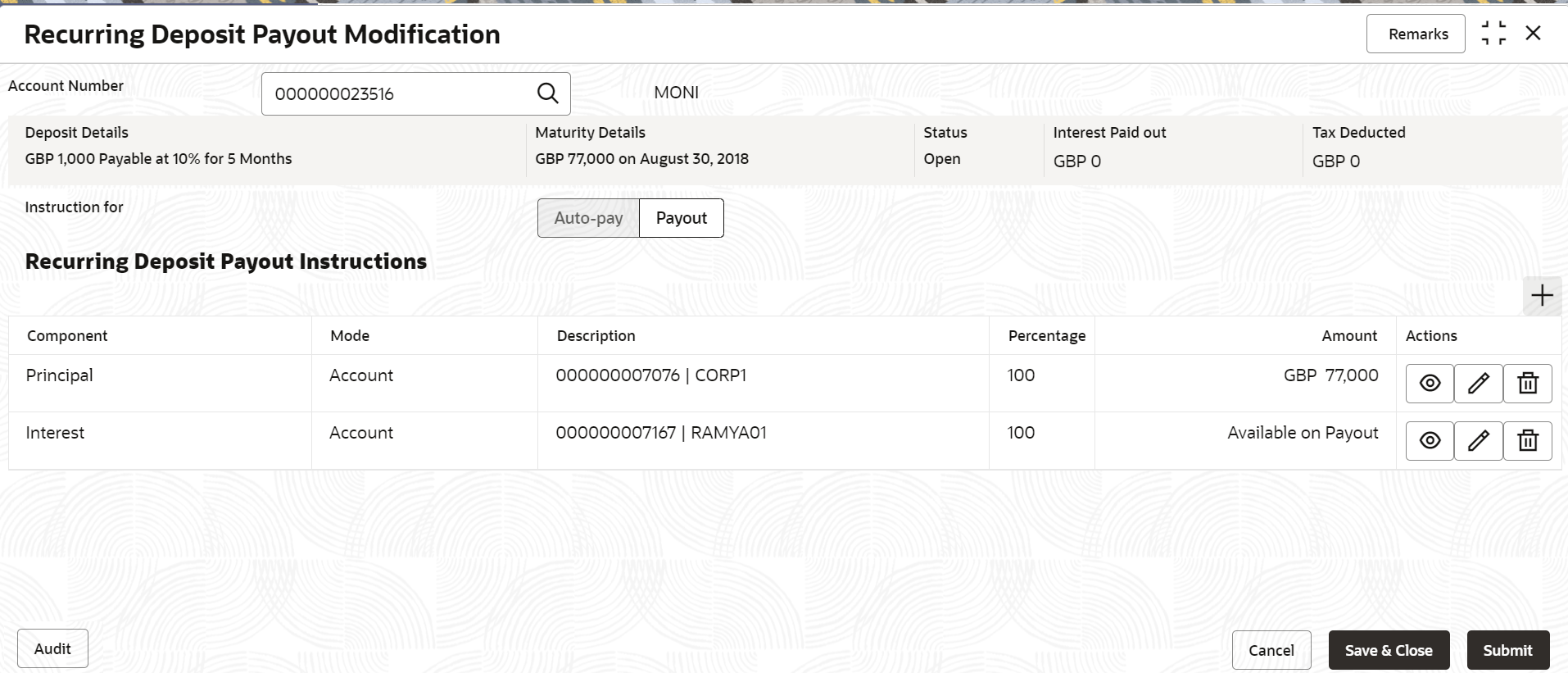

You can set the payout instruction for a RD payout.
- To launch and view the payout modification details, refer RD Payout Modification.
To view or edit the payout instruction:
The fields marked as Required are mandatory.- Select the Payout option from the Instruction
for field. The payout details displayed in the Recurring Deposit Payout Instructions section.
- Perform any of the following action to view or edit the required details in the
Recurring Deposit Payout Instructions section:
- View the payout instruction details
- Edit the own account payout instruction details
- Edit the other account payout instruction details that are within the bank
- Edit the other account payout instruction details by adding new TD
- Edit the payout mode as instrument
- Edit the payout mode as ledger

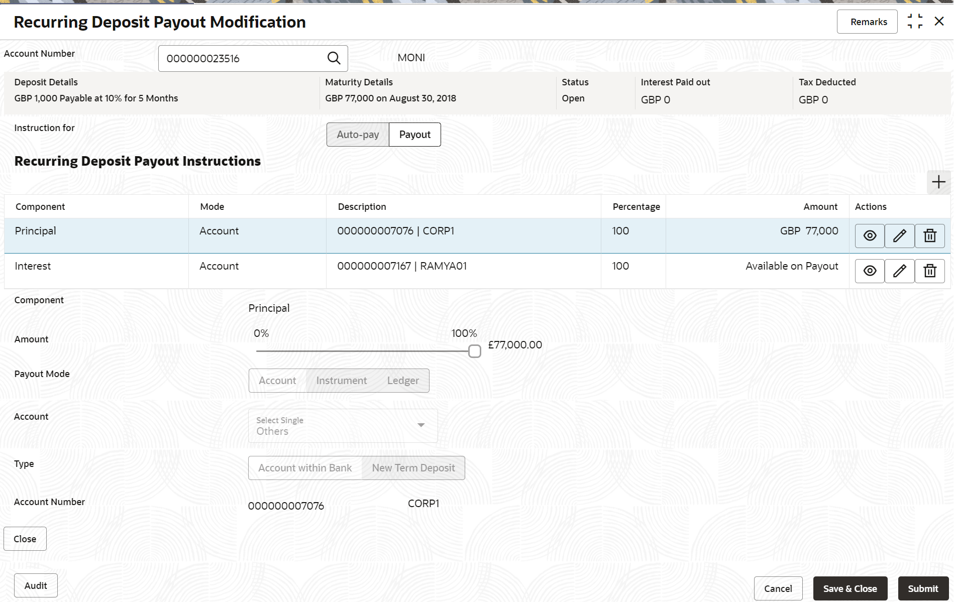

- View the payout instruction details:
- Click the
icon from the Actions
field.
The payout details displayed.

- Click Close.

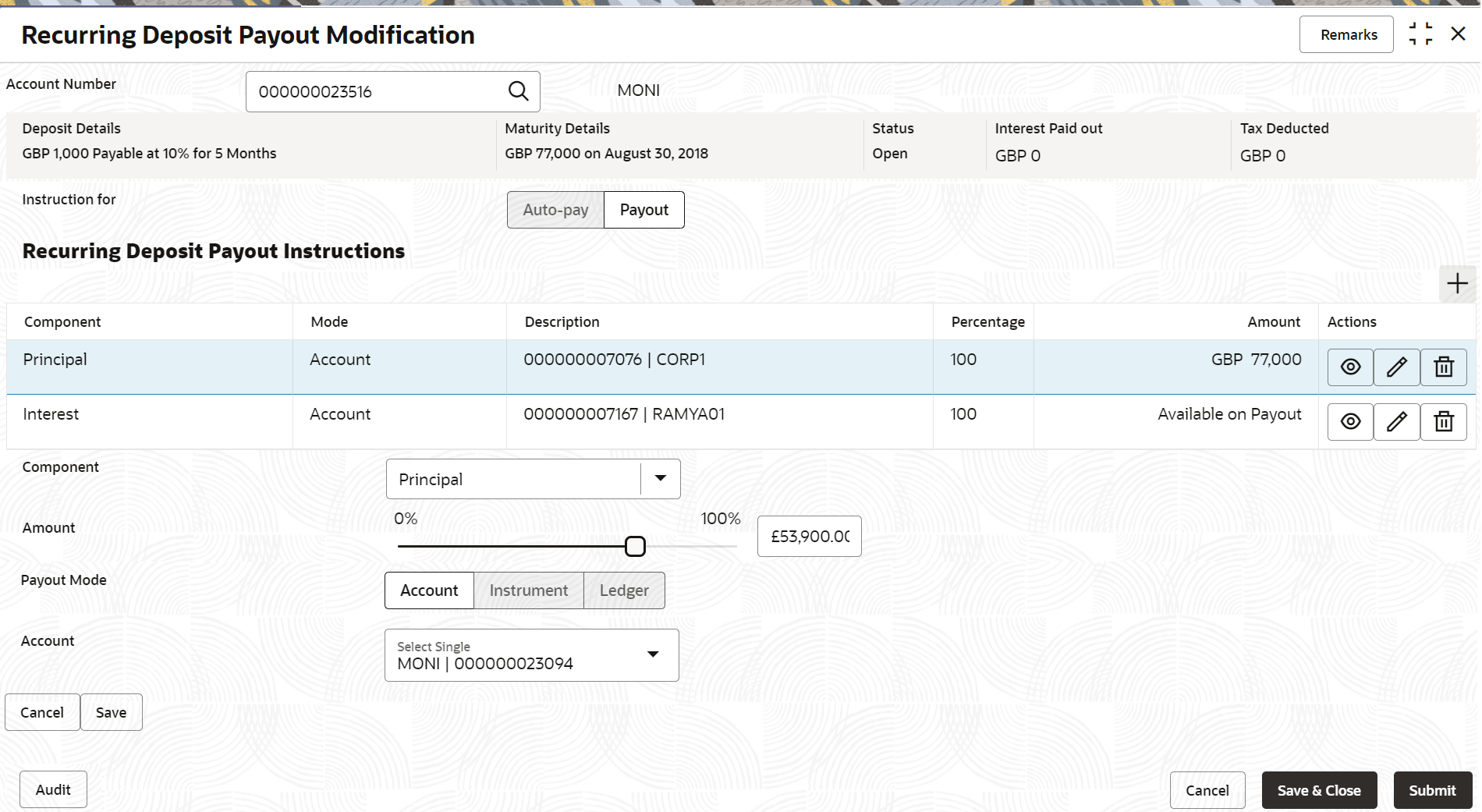

- Click the
field.
Figure 8-11 Own Account Payout Instruction
Description of "Figure 8-11 Own Account Payout Instruction"For more information on fields, refer to the field description table.
Table 8-7 Payout by own account – Field Description
Field Description Component Select the component for payout. The options are: - Principal
- Interest
- Principal & Interest
Amount in Percentage Specify the amount in percentage for payout. Note:
You can increase or decrease the amount by dragging the slider to right or left. If you have specified the amount, then accordingly the slider is adjusted automatically.Payout Mode Select the payout mode as Account. Note:
For information on payout mode as Instrument or Ledger, refer Edit the payout mode as instrument and Edit the payout mode as ledger.Account Select the own account for performing the payout. Note:
For information on Other accounts, refer Edit the other account payout instruction details that are within the bank and Edit the other account payout instruction details by adding new TD. - Click Save.

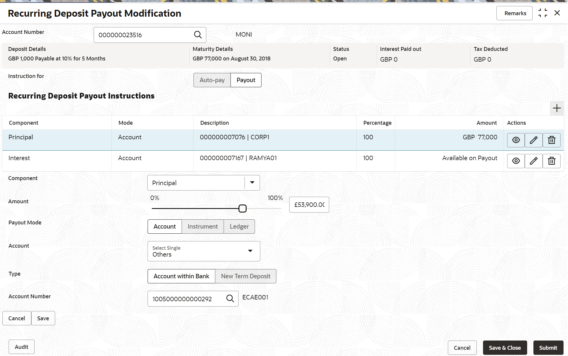

instruction details that are within the bank:
- Click the
field.
Table 8-8 Payout by other account within bank – Field Description
- Interest
For information on payout mode as Instrument or Ledger, refer Edit the payout mode as instrument and Edit the payout mode as ledger.Account Select the Other account for performing the payout. Note:
For information on own accounts, refer Edit the own account payout instruction details.Type Select the Account Within Bank type. Note:
For information on New Term Deposit, refer Edit the other account payout instruction details by adding new TD.Account Number Specify the account number which is within the same bank for performing the payout. - Click Save.
- Click the

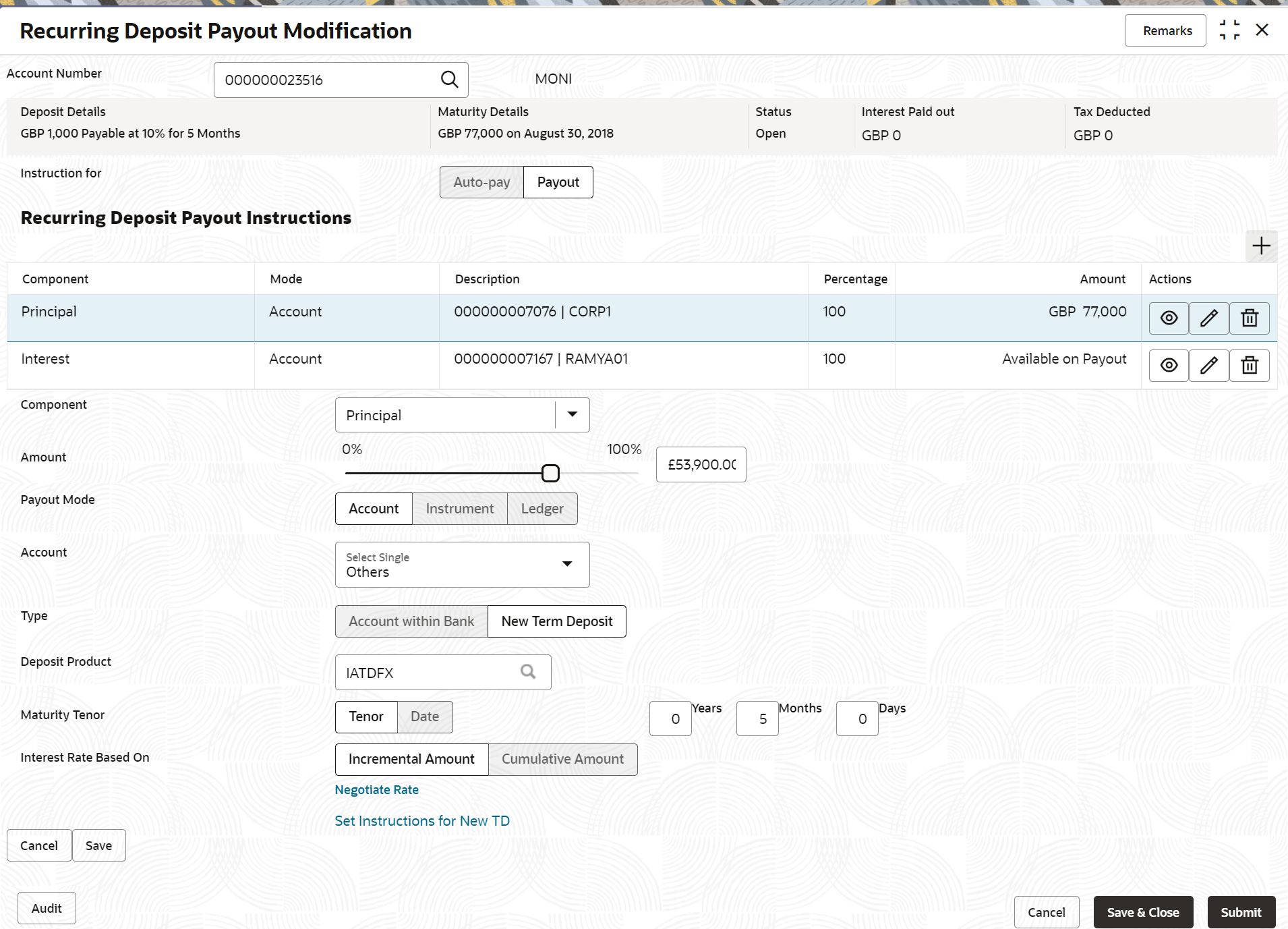

- To edit the other account payout
instruction details by adding new TD:
- Click the
field.
Table 8-9 TD Type - Create New TD - Field Description
- Interest
For information on own accounts, refer Edit the own account payout instruction details.Type Select the New Term Deposit type. Note:
For information on Account Within Bank, refer Edit the other account payout instruction details that are within the bank.Deposit Product Select the deposit product for the payout. Maturity Tenor Select and specify the maturity tenor for the payout. - Tenure: If you select this option, then specify the tenure for maturity in year, months, and days in the fields displayed adjacent.
- Date: If you select this option, then specify or select the date.
Interest Rate Based On Select the basis for the interest rate calculation. The options are: - Incremental Amount
- Cumulative Amount

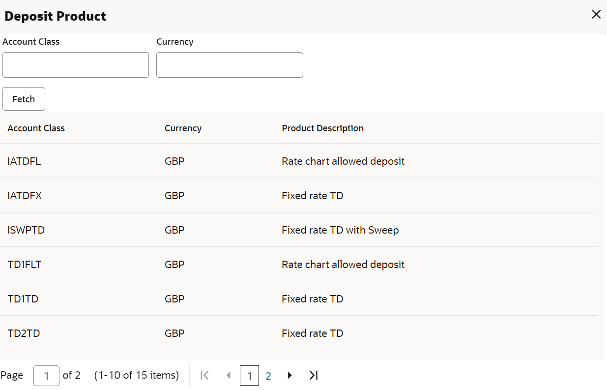

- To fetch deposit product:
- Click the
icon from the Deposit
Product
field.
The Deposit Product section is
displayed. - Specify the class or currency in the Account Class and Currency field and click Fetch.
- Select the option displayed in the table.
- Click the

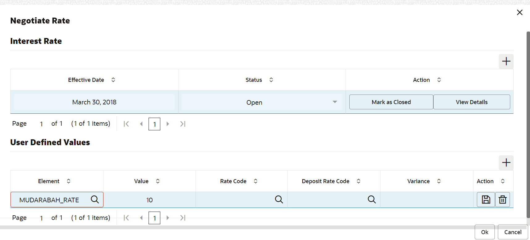

- To negotiate the
rate:
- You can also negotiate the rate by
clicking the Negotiate Rate
link.
The Negotiate Rate section is displayed.
Table 8-10 Negotiate Rate – Field Description
Field Description Interest Rate This section displays the interest rate details. Effective Date Displays the date from which the interest rate is effective. Status Displays the status of the interest. Action Click Mark as Closed, to close the interest rate.
Click View Details, to view the user defined values.
User Defined Values This section displays the user defined values details. Note:
This section is displayed if you click View Details from the Action field.Element Displays the element details. Value Displays the user defined value. Rate Code Displays the rate code for the user defined value. Deposit Rate Code Displays the deposit rate code for the user defined value. Variance Displays the variance for the user defined value. Action Click the
icon, to edit the user defined value
details.
Click the
icon, to delete the user defined value
entry.
Click the
icon, to confirm the edited details. This
icon is displayed, only after you click the edit
icon.
- Click
OK.
You can also set instructions for the new TD created, by clicking the Set Instructions for New TD link. For more information, refer Edit the own account payout instruction details, Edit the other account payout instruction details that are within the bank, Edit the other account payout instruction details by adding new TD, Edit the payout mode as instrument, and Edit the payout mode as ledger.
link.
- Click Save.

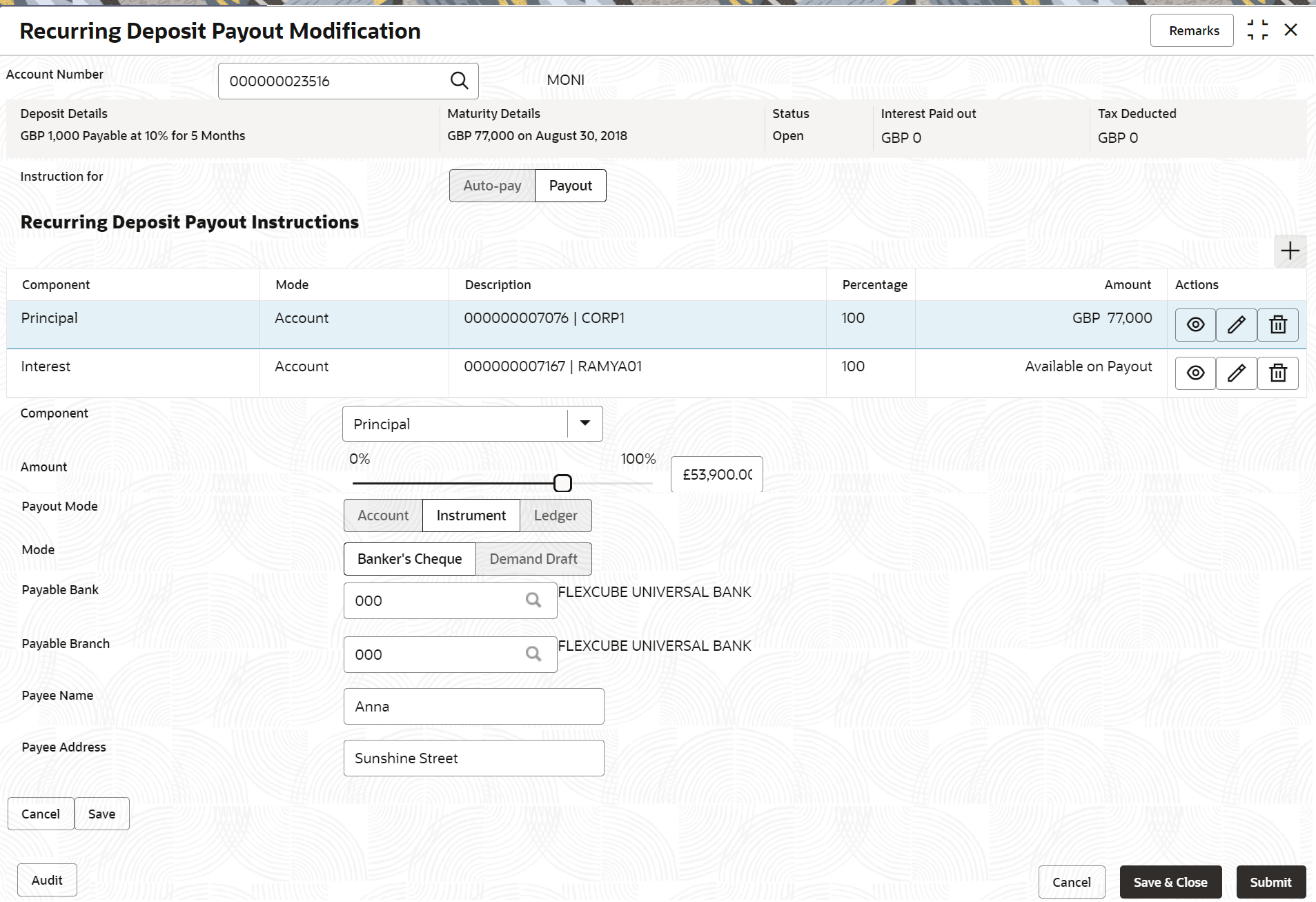

instrument:
- Click the
field.
Table 8-11 Pay through Instrument - Own Bank Cheque – Field Description
- Interest
You can increase or decrease the amount by dragging the slider to right or left. If you have specified the amount, then accordingly the slider is adjusted automatically.Payout Mode Select the payout mode as Instrument. Note:
For information on payout mode as Account or Ledger, refer Edit the own account payout instruction details, Edit the other account payout instruction details that are within the bank, Edit the other account payout instruction details by adding new TD, and Edit the payout mode as ledger.Mode Select the mode of instrument for payout. The options are: - Banker's Cheque
- Demand Draft

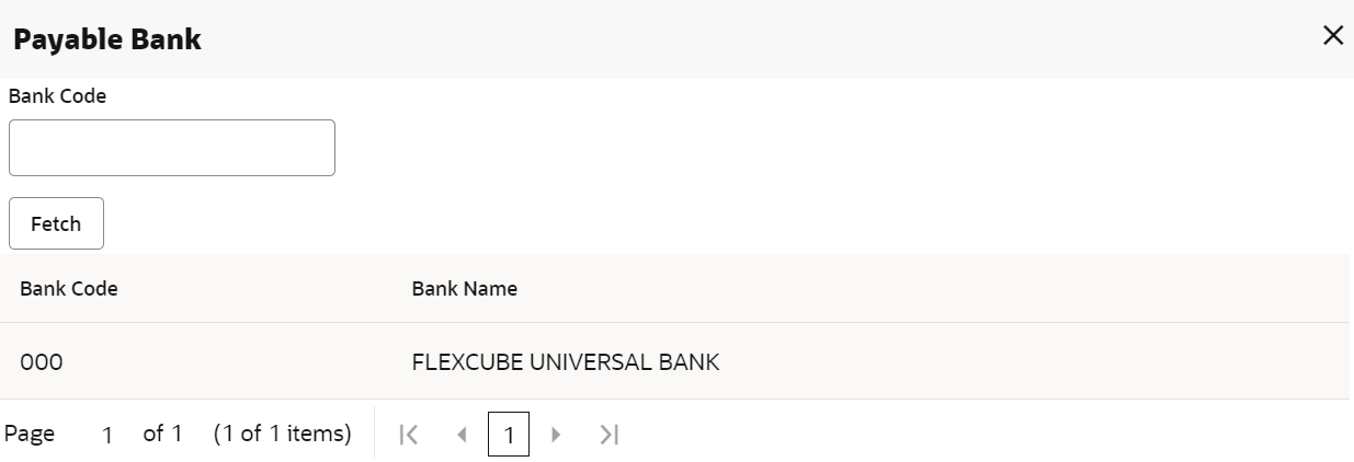

Payable Bank Specify the bank at which the TD is payable. Payable Branch Specify the branch at which the BC or DD is payable. Payee Name Specify the payee name for the payout. Payee Address Specify the payee address for the payout. - To fetch the payable
bank:
- From the Payable
Bank field, click the
icon from the first
field.
The Payable Bank section is
displayed. - Specify the code in the Bank Code field and click Fetch.
- Select the code displayed in the table.
- From the Payable
branch:
- From the Payable
Branch field, click the
icon
field.
The Payable Branch section is
displayed. - Specify the code in the Branch Code field and click Fetch.
- From the Payable
- Click Save.

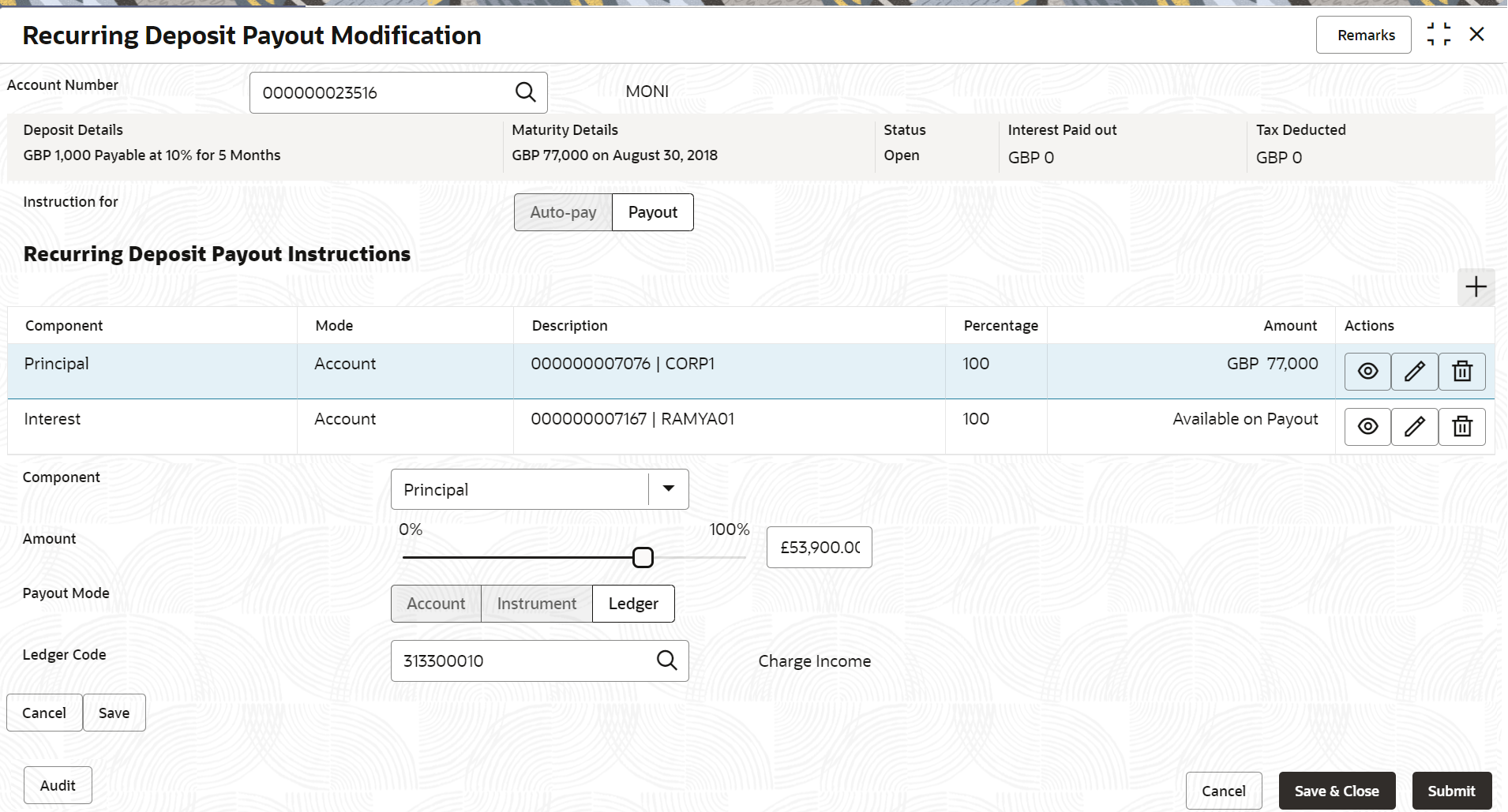

- Click the
field.
Table 8-12 Pay through Ledger – Field Description
- Interest
You can increase or decrease the amount by dragging the slider to right or left. If you have specified the amount, then accordingly the slider is adjusted automatically.Payout Mode Select the payout mode as Ledger. Note:
For information on payout mode as Account or Instrument, refer Edit the own account payout instruction details, Edit the other account payout instruction details that are within the bank, Edit the other account payout instruction details by adding new TD, and Edit the payout mode as instrument.Ledger Code Select the ledger code for the payout. - To fetch the ledger code:

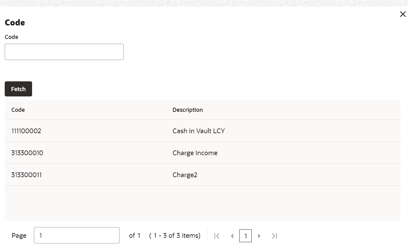

- From the Ledger
Code field, click the
icon from the first
field.
The Ledger Code section is
displayed. - Specify the code in the Ledger Code field and click Fetch.
- From the Ledger
- Click Save.
