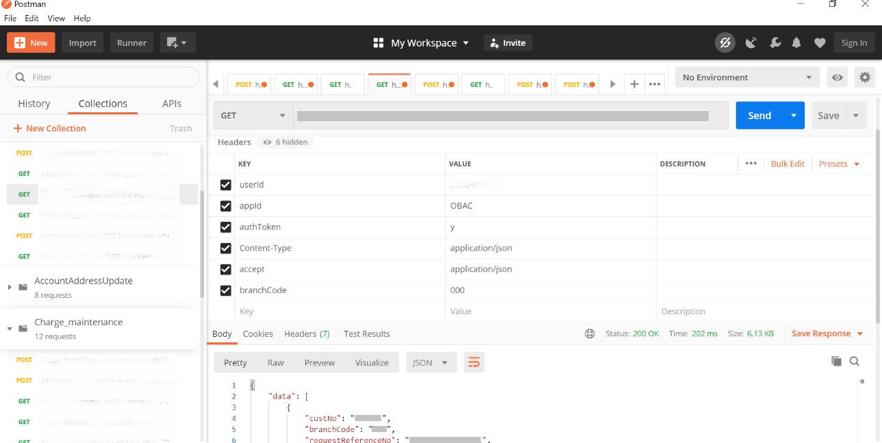

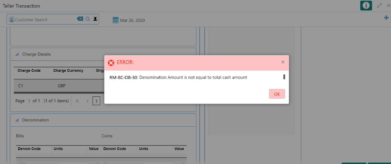

Calls are not sent properly
Null pointer or branch common exception error

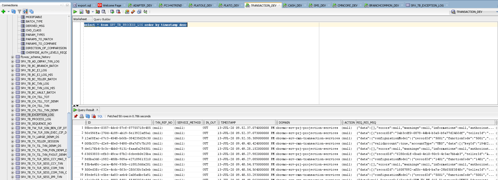

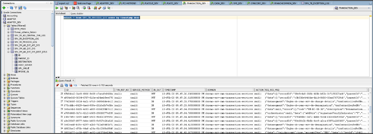

If there is a null pointer exception or branch common exception error, go to the process log table and exception log table, and select the following queries to verify the results.
Table 3-3 Queries to Verify Results
| Query | Reference for Sample Log |
Process log contains request payload, which will help you to hit service through postman and for getting the response.Exact error through exception log

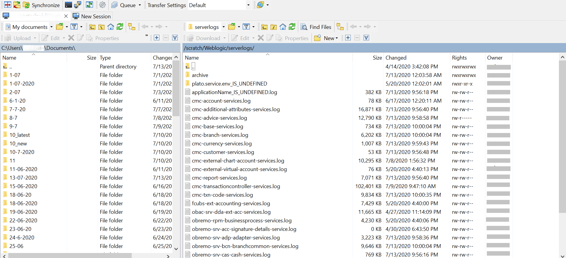

-Dplato.service.logging.path variable in the
setEnv.sh. For example, the path is
/scratch/Weblogic/serverlogs.
Logs are not generated

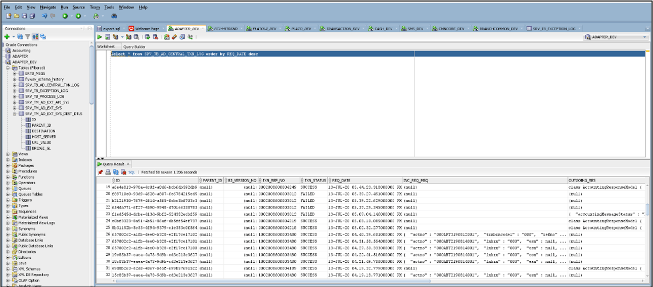

The call is failing in the adapter
If any call is failing in call to Product Processor Gateway, open SRV_TB_AD_CENTRAL_TXN_LOG in Adaptor for getting Gateway response (SUCCESS or FAILED). Select the following query to verify results.
select * from SRV_TB_AD_CENTRAL_TXN_LOG order by REQ_DATE desc
