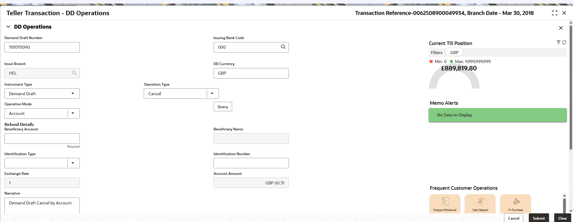

To cancel a DD:
  1. On the Homepage, from Teller mega menu, under Remittances, click DD Operations or specify DD Operations in the search icon bar and select the screen.
    The DD Operations screen is displayed.
    Figure 8-39 DD Operations - Cancel by Account
  2. On the DD Operations screen, specify the fields. For more information on fields, refer to the field description table.
    The fields marked as Required are mandatory.

  3. Click on the View DD Details data segment to view the additional details of the DD.
    This data segment is non-editable.
  4. Click Submit.
    A teller sequence number is generated, and the Transaction Completed Successfully information message is displayed.
    The transaction is moved to authorization in case of any warning raised when the transaction saves.
    On transaction submission, the system will hand off the details to the payments product processor (Oracle Banking Payments) for processing. When you get a success notification from Oracle Banking Payments, the system will update the transaction status as Success and mark for charges accounting handoff. The transaction accounting is not applicable for the transaction. In case of reject notification from Oracle Banking Payments, the system will discard the transaction.
