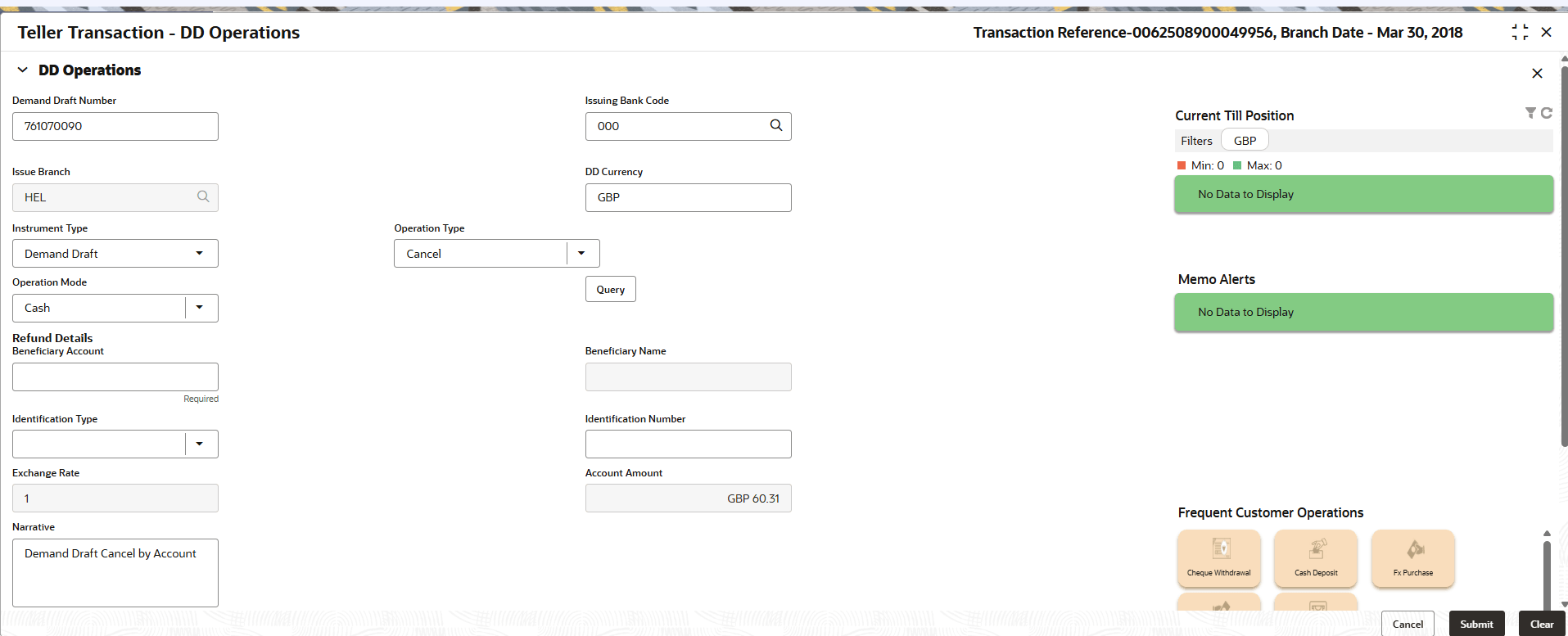

    Figure 8-40 DD Operations - Cancel by Cash
  2. On the DD Operations screen, specify the fields. For more information on fields, refer to the field description table.
    The fields marked as Required are mandatory.

  3. Click on the View DD Details data segment to view the additional details of the DD.
    This data segment is non-editable.
  4. Specify the denomination details. For information on the fields in the Denomination segment, refer to Add Denomination Details.
  5. Click Submit.
    A teller sequence number is generated, and the Transaction Completed Successfully information message is displayed.
