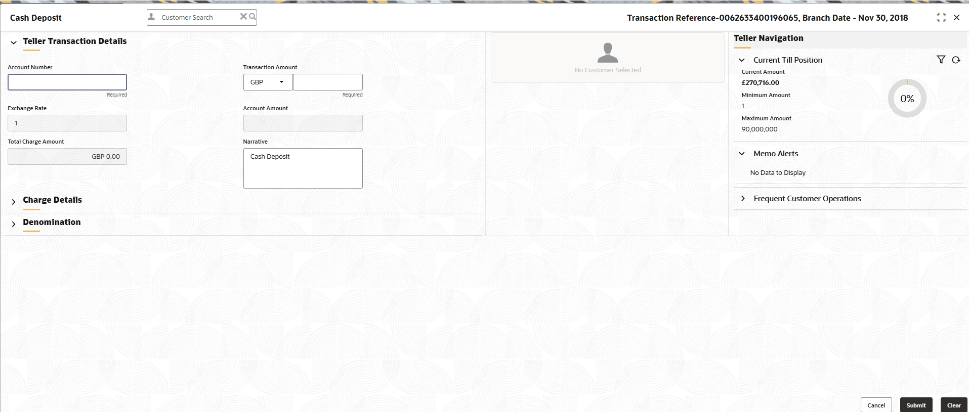

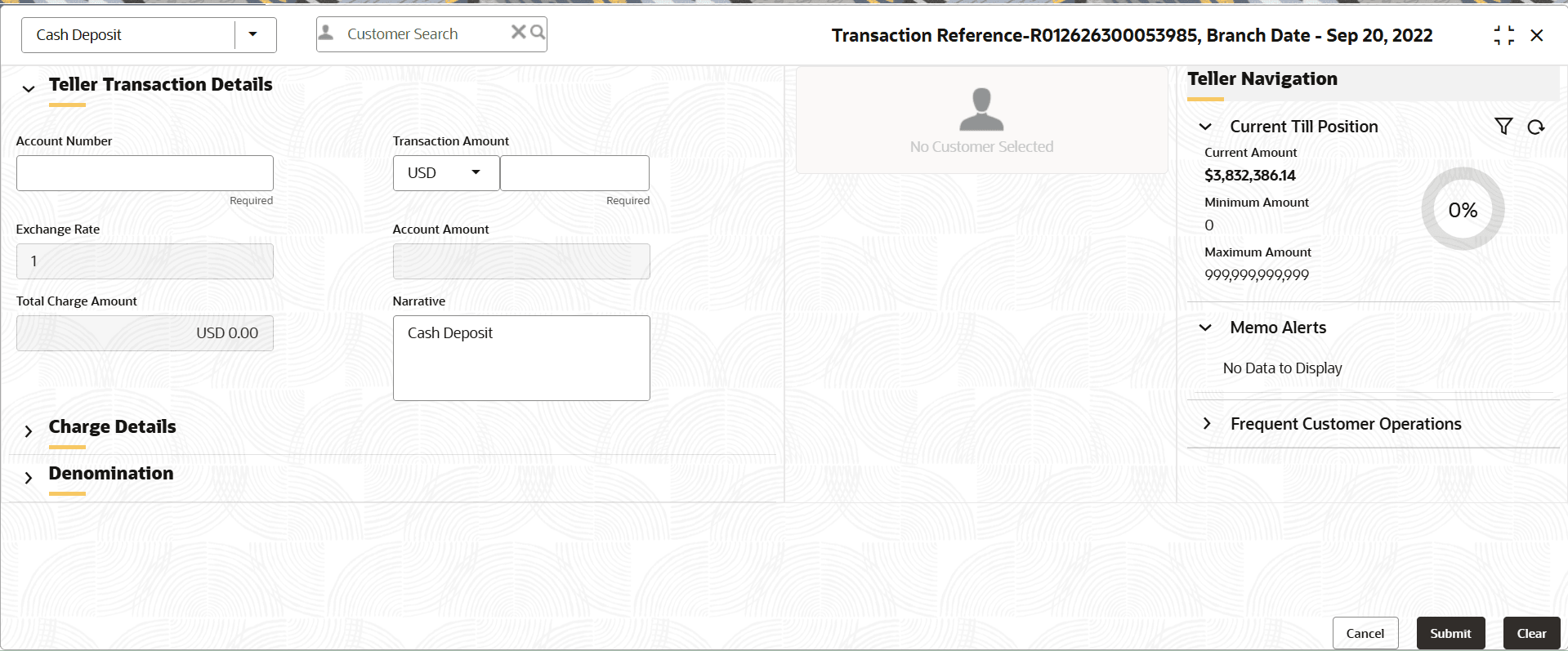

  1. On the Homepage, click Teller. On the Teller Mega Menu, under Customer Transaction, click Cash Deposit or specify the Cash Deposit in the search icon bar.
    The Cash Deposit screen is displayed.
  2. On the Cash Deposit screen, specify the fields. For more information on fields, refer to the field description table.
    The fields marked as Required are mandatory.

  3. Specify the charge details. For information on the fields in the Charge Details segment, refer to Charge Details.
  4. Specify the denomination details. For information on the fields in the Denomination Details segment, refer to Add Denomination Details .
  5. Click Submit.
