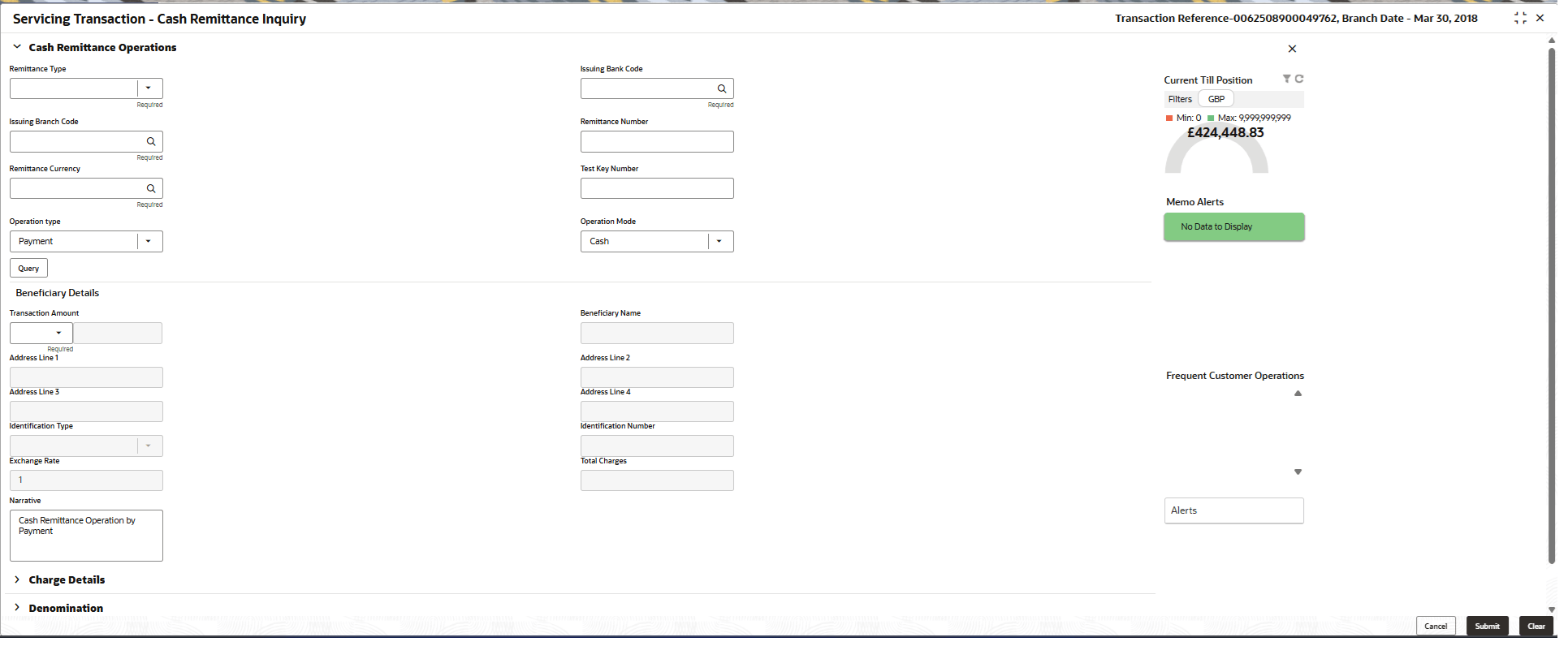

  1. On the Homepage, from Teller mega menu, under Remittances, click Cash Remittance Operations or specify Cash Remittance Operations in the search icon bar and select the screen.
    The Cash Remittance Operations screen is displayed.
    Figure 8-50 Cash Remittance Operations (Payment by Cash)
  2. On the Cash Remittance Operations screen, specify the fields. For more information on fields, refer to the field description table.
    The fields marked as Required are mandatory.
    Table 8-48 Cash Remittance Operations (Payment by Cash) - Field Description

  3. Specify the charge details. For information on the fields in the Charge Details segment, refer to Charge Details.
  4. Specify the denomination details. For information on the fields in the Denomination segment, refer to Add Denomination Details.
  5. Click on the Remittance Details data segment to view the additional details of the remittance.
    This data segment is non-editable.
  6. Click Submit.
    A teller sequence number is generated, and the Transaction Completed Successfully information message is displayed.
