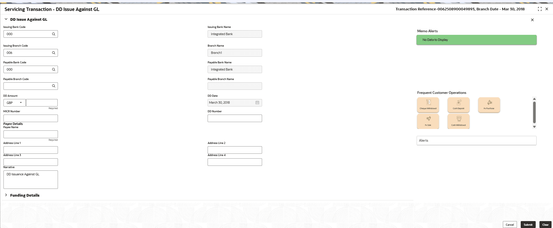

8.2.3 DD Issue Against GL
The Teller can use the DD Issue Against GL screen to issue a DD against a GL account.
To issue a DD against a GL:
  1. On the Homepage, from Teller mega menu, under Remittances, click DD Issue - GL or specify DD Issue - GL in the search icon bar and select the screen.
    The DD Issue Against GL screen is displayed.
    Figure 8-27 DD Issue Against GL
  2. On the DD Issue Against GL screen, specify the fields. For more information on fields, refer to the field description table.
    The fields marked as Required are mandatory.
    Table 8-27 DD Issue Against GL - Field Description
    Field Description
    Issuing Bank Code
    Specify the code of the issuing bank.
    Issuing Bank Name
    Specify the name of the issuing bank.
    Issuing Branch Code
    Displays the logged-in branch code.
    Branch Name
    Displays the branch description of issuing branch.
    Payable Bank Code
    Select the payable bank code. The list of values contains the bank codes maintained using the External Bank Code Maintenance screen.
    • To remit funds within the same bank, select the logged-in bank code as payable bank code. To remit funds across banks, select the necessary bank code as payable bank code. The fields Payable Branch Code and Payable Branch Name will be enabled after you specify the Payable Bank Code.
    • If the Instrument Currency is FCY and the Payable Bank code selected is External Bank, then the Instrument Type will be Demand Draft-FCY (DF).
    Payable Bank Name
    Displays the name of the selected bank code.
    Payable Branch Code
    Select the branch code of the payable bank. The list of values contains the corresponding branch codes maintained using the Bank Code Maintenance screen.
    Payable Branch Name
    Displays the branch name of the selected branch code.
    DD Amount
    Specify the DD currency and DD amount.
    DD Date
    Specify the date that needs to be mentioned in the DD.
    MICR No
    Displays the serial number.
    DD Number
    Specify the instrument number and validate.
    Note: If not specified, the system generates the DD number based on the maintenance setup.
    Payee Details
    Specify the fields.
    Payee Name
    Specify the payee name on which the DD is drawn.
    Payee Address
    Click Address Details button to view the customer address details.
    For the field-level description of the customer address, see Address Details.
    Narrative
    Displays the narrative as DD Issuance Against GL, and it can be modified.
