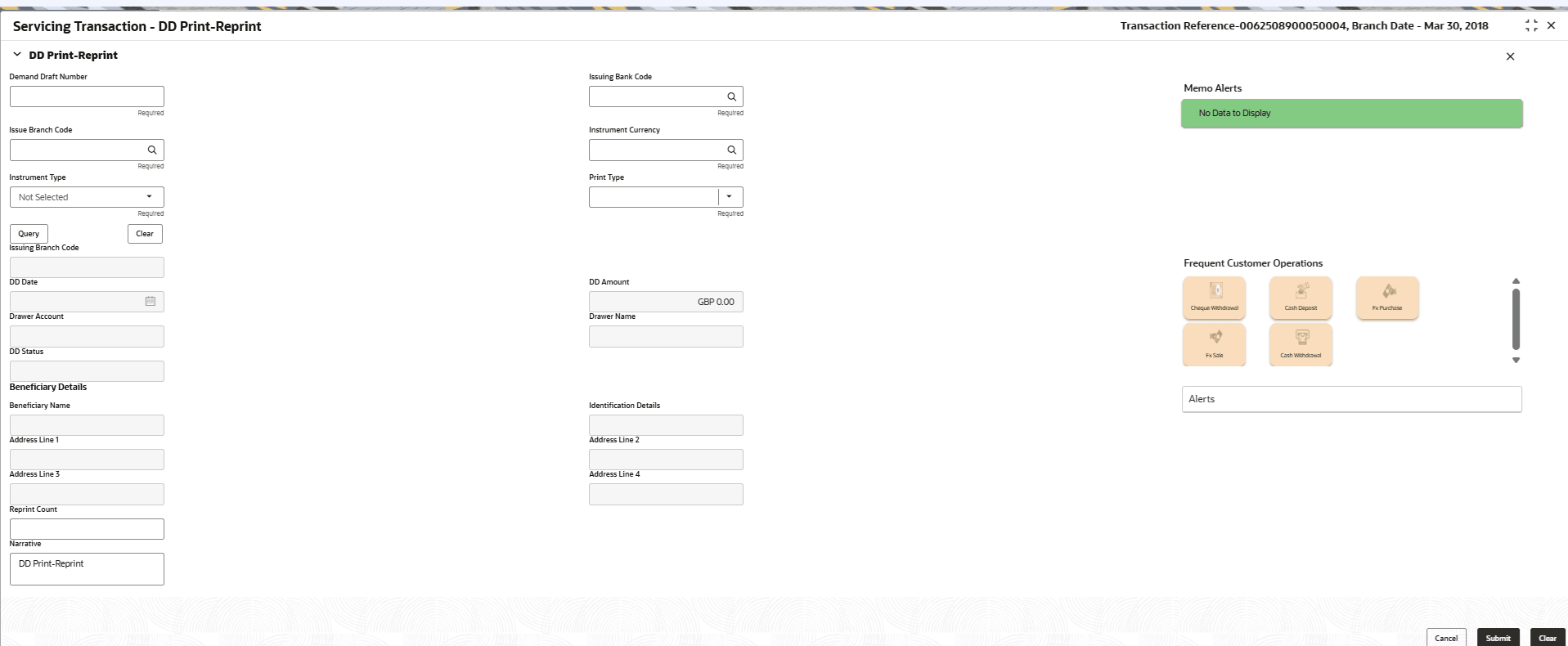

  1. On the Homepage, from Teller mega menu, under Remittances, click DD Print-Reprint or specify DD Print-Reprint in the search icon bar and select the screen.
    The DD Print-Reprint screen is displayed.
  2. On the DD Print-Reprint screen, specify the fields. For more information on fields, refer to the field description table.
    The fields marked as Required are mandatory.

    Query
    Click Query to fetch details of DD print or reprint.

  3. Click Submit.
    A teller sequence number is generated, and the Transaction Completed Successfully information message is displayed.
    The transaction is moved to authorization in case of any warning raised when the transaction saves.
