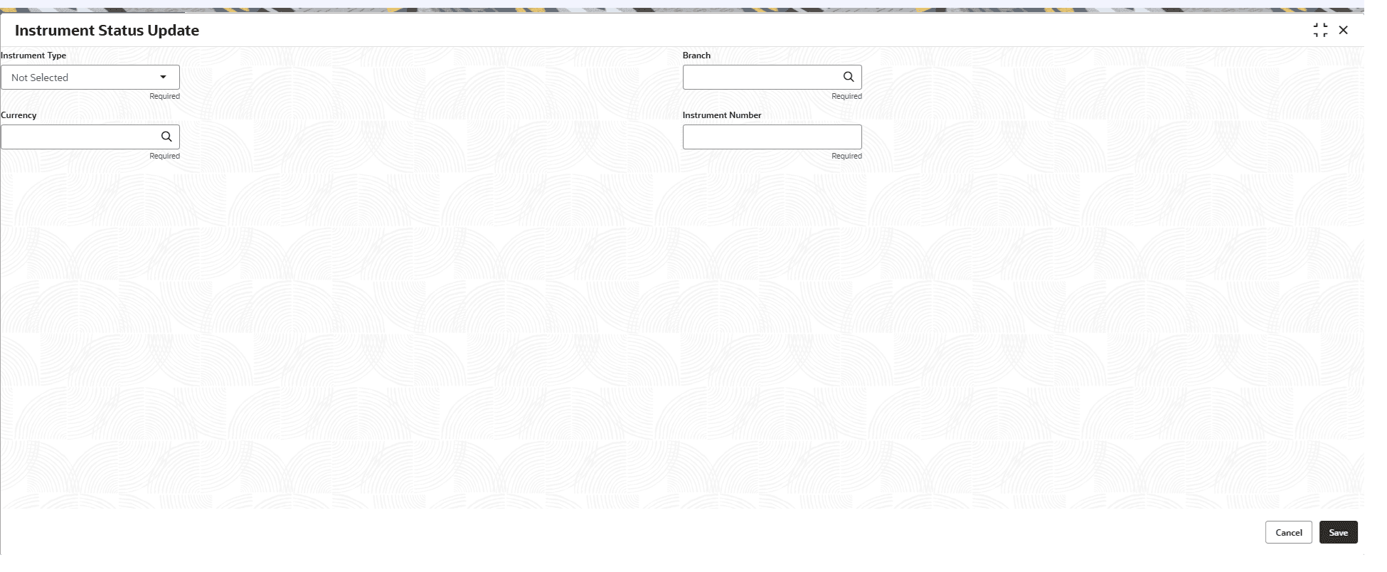

The Instrument Status Update screen is used to change the status of used instrument numbers from ‘Used’ to ‘Unused’. This screen is used only when an unused instrument is marked as 'Used' by the application.

    The Instrument Status Update screen is displayed.
    Figure 8-64 Instrument Status Update
  2. On the Instrument Status Update screen, specify the fields. For more information on fields, refer to the field description table.
    The fields marked as Required are mandatory.
    Table 8-63 Instrument Status Update - Field Description
    Field Description
    Instrument Type Select the instrument type from the drop-down list.

    Branch Click search icon and select the branch code from the list of values.
    Currency Click search icon and select the currency code from the list of values.
    Instrument Number Specify the instrument number.
  3. Click Submit.
    The screen displays the information message based on the conditions below:
    • If the instrument number is used, it will change the status from 'Used' to 'Unused' and displays the message as Status is updated to Unused.
    • If the instrument number is unused, it displays the message as Status is already Unused.
    • If the entered instrument number is incorrect, it displays the message as an Invalid Instrument!.
    If the IV Integration Parameter is activated, the Instrument Status Update in Branch is not applicable and the system restricts user access to the screen.
