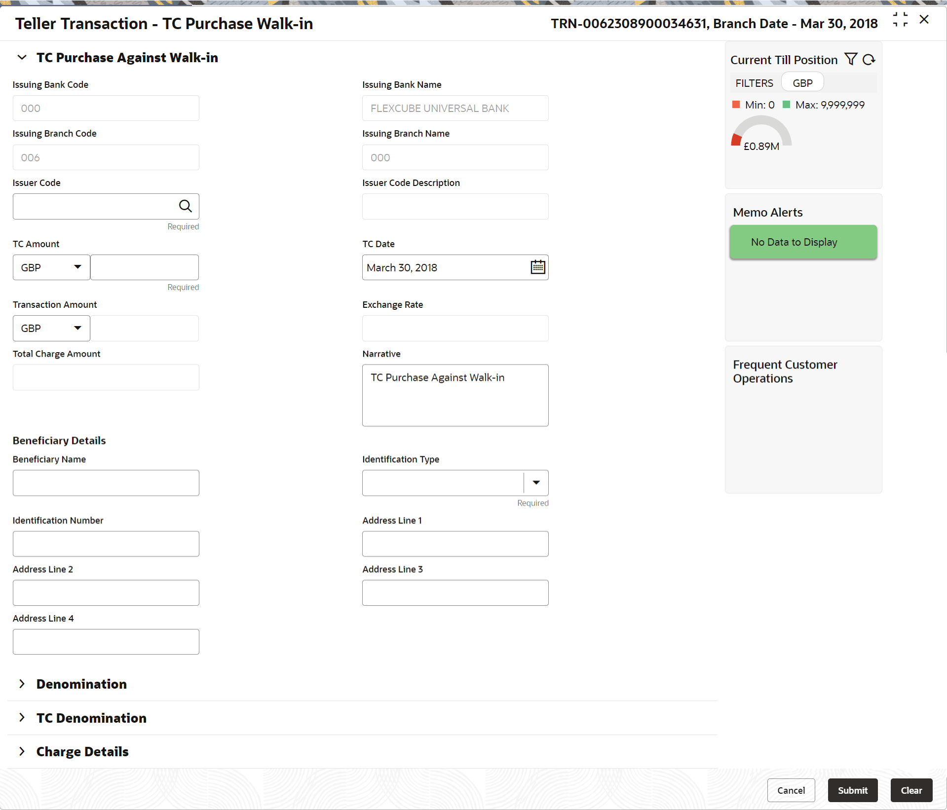

    Figure 8-63 TC Purchase Against Walk-in
  2. On the TC Purchase Against Walk-in screen, specify the fields. For more information on fields, refer to the field description table.
    The fields marked as Required are mandatory.
    Table 8-62 TC Purchase Against Walk-in - Field Description
    Field Description
    Issuing Bank Code
    Specify the code of the issuing bank.
    By default, the logged-in bank code is displayed.
    Issuing Bank Name
    Displays the name of the issuing bank specified.
    Issuing Branch Code
    Specify the code of the issuing branch.
    By default, the logged-in branch code is displayed.
    Issuing Branch Name
    Displays the name of the issuing branch specified.
    Issuer Code
    Click the search icon and select the issuer code from the list of values.
    The list of values provides the HO code of the logged-in branch and the issuer codes maintained in the Issuer Code Maintenance screen.
    Issuer Code Description
    Displays the description of the specified Issuer Code.
    TC Amount
    Select the TC currency from the drop-down values, and specify the TC Amount.
    Purchase Date
    Select the purchase date of the TC.
    By default, the current posting date is displayed.
    Account Amount
    Displays the account amount based on the Exchange Rate, TC Amount, and Account Number selected.
    Exchange Rate
    Displays the exchange rate.
    If the TC currency is the same as the account currency, the system displays the exchange rate as 1. This field is displayed only if Multi-Currency Configuration at the Function Code indicator level is set as Y.
    Total Charge Amount
    Displays the total charges in the branch local currency.
    Narrative
    Displays the narrative as TC Purchase Against Walk-in, and it can be modified.
    Beneficiary Details
    Specify the fields under this section.
    Beneficiary Name
    Specify the name of the beneficiary.
    Identification Type
    Select the identification type from the drop-down values.
    Identification Number
    Specify the identification number.
    Address Line 1 to Address Line 4
    Specify the address of the beneficiary.
