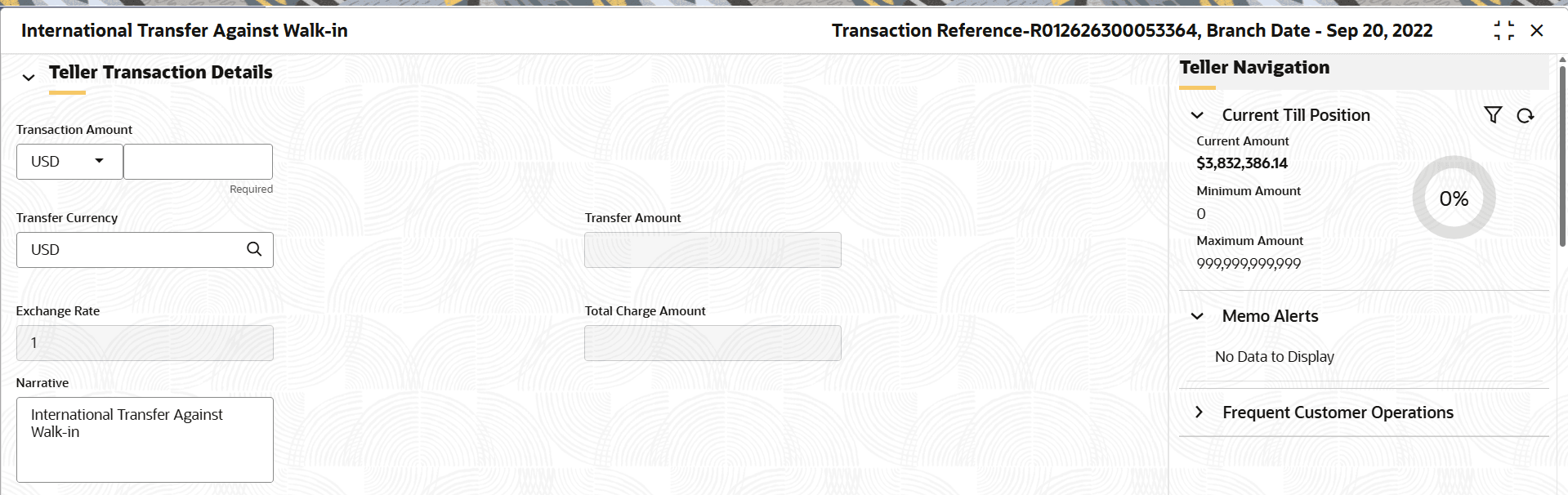

    Figure 6-8 International Transfer Against Walk-in

    Table 6-8 International Transfer Against Walk-in - Field Description
    Field Description
    Transaction Amount
    Specify the currency in which the cash is accepted from the walk-in customer and the transaction amount as requested by the customer.
    Transfer Currency
    Specify the currency in which the funds are to be transferred.
    Transfer Amount
    Displays the transfer amount based on the exchange rate pickup.
    This field is displayed only if Multi-Currency Configuration at Function Code Indicator level is set as Y.
    Exchange Rate
    Displays the exchange rate used to convert the transfer currency into transaction currency, and it can be modified.
    If the transfer currency is the same as the account currency, the system displays the exchange rate as 1. This field is displayed only if Multi-Currency Configuration at the Function Code Indicator level is set as Y.
    Negotiated Exchange Rate
    Specify the negotiated exchange rate that should be used for foreign currency transactions between the treasury and the branch. You need to specify the negotiated exchange rate only when the currencies involved in the transaction are different.
    This field is applicable only if the transaction involves cross currency and only if cross currency enabled and Negotiated_Rate_Enabled Configuration at Function Code Indicator level is set as Y.
    Negotiated Reference Number
    Specify the unique reference number that should be used for negotiation of cost rate, in foreign currency transaction. If you have specified the negotiated cost rate, then you need to specify the negotiated reference number also.
    Accounting system books the online revaluation entries based on the difference in exchange rate between the negotiated exchange rate and transaction rate.
    Total Charge Amount
    Displays the total charge amount, which is computed by the system.
    This field is displayed only if Total Charges Configuration at the Function Code Indicator level is set as Y.
    Narrative
    Displays the default narrative as International Transfer Against Walk-in, and it can be modified.
