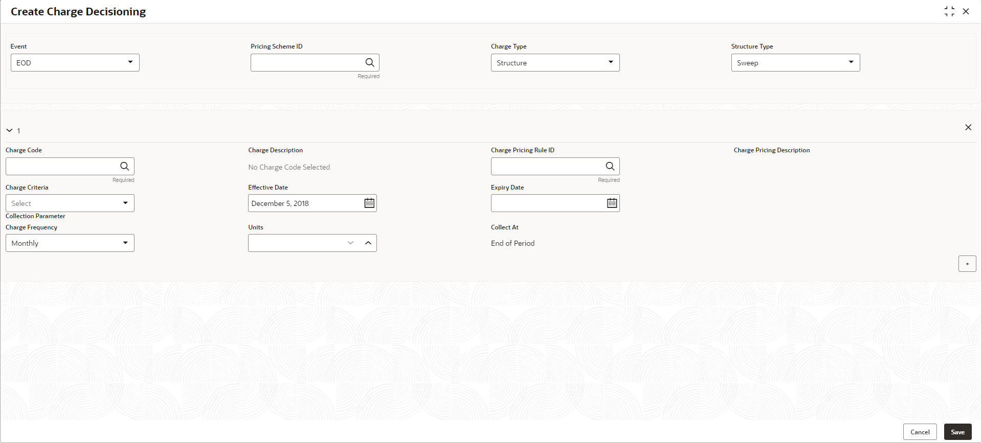

    The Create Charge Decisioning screen displays.
    Figure 17-7 Create Charge Decisioning
  4. On Create Charge Decisioning screen, specify the fields.
    The fields marked as Required are mandatory.

    1. Click + button to add the charge decisioning.
    2. Click X button to close the charge decisioning.
  5. Click Save to save the details.
The user can view the configured charge decisioning in the View Charge Decisioning screen.
