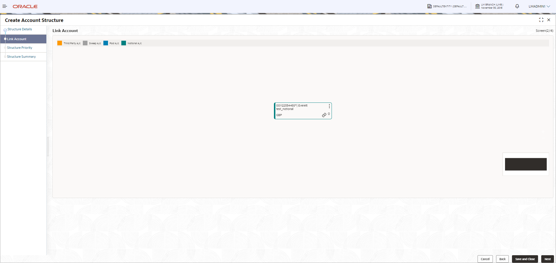

  3. Select the notional account in the Add Header Account screen to add the notional header account.
  4. Click Build to add the selected header account in the Structure.
    The selected account is added to Create Account Structure – Added Header Account screen.
    Figure 6-27 Create Account Structure – Added Header Account

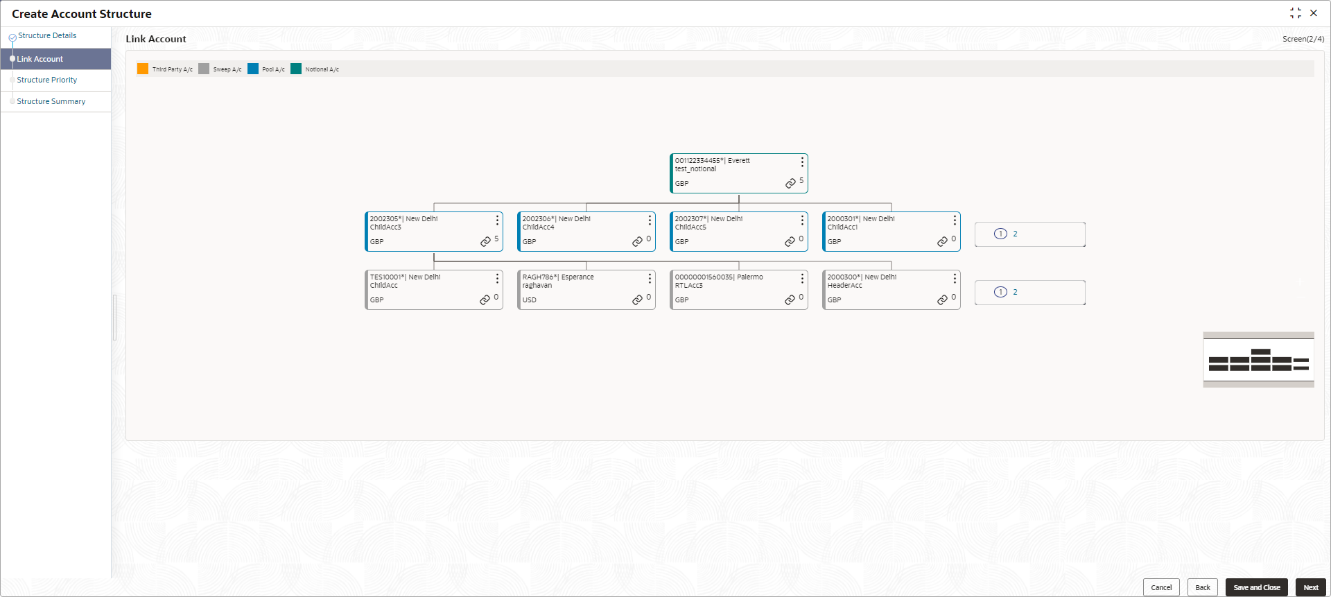

  5. Perform anyone of the following actions on the header node.
    1. Click Three Dots and then click Link Account to add the child accounts for the header account
      For more details information, please refer to the Step 6.
    2. Click Three Dots and then click View Account Details to view the account details of header account.
      The Account Details screen displays

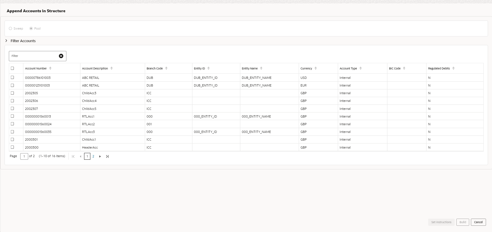

Create Account Structure - Append Accounts in Structure
By default,only pool accounts are allowed when adding child nodes at the notional header level.
  1. Click and then click Link Account to add the child accounts for the header account.
    The Append Accounts in Structure screen displays.
    Figure 6-29 Append Accounts in Structure

  2. Select the Checkbox of the accounts to be added as child accounts for the header account.
  3. Click Set Instructions to set the instruction of the selected the child accounts.

  3. Click Three Dots and then click Link Account to add the child accounts for the parent account

  2. Click Build to add the child accounts to the structure.
    The Create Account Structure - Link Account - View screen displays.
    Figure 6-38 Create Account Structure - Link Account - View
    Only Header node and its immediate child accounts will appear on the screen initially. To view further nodes, click on the respective nodes to expand and view its child accounts. Pagination will be displayed at every level of structure layer and displayed if the number of nodes exceeds the allowed limit as per the configuration
  3. Perform anyone of the following actions on the child accounts node.
    1. Click Three Dots and then click Link Account to add the additional child accounts.
    2. Click Three Dots and then click View Account Details to view the account details of the accounts.
