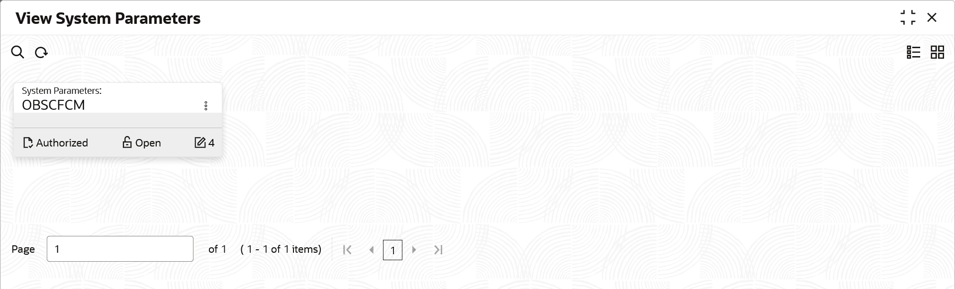

2.1 View System Parameters
This topic describes the systematic instruction to view, modify, or authorize the day zero system parameters for Receivables and Payables module.
A tile is present for each record that has been created. The bottom portion of each record-tile displays the following:
  • The status, whether Authorized, Unauthorized, or Rejected.
  • Open or Closed.
  • The number of times the record has been submitted by the Maker added.
  1. On Home screen, click Receivables & Payables. Under Receivables & Payables, click System Parameters.
  2. Under System Parameters, click View System Parameters.
    The View System Parameters screen displays.
    Figure 2-1 View System Parameters

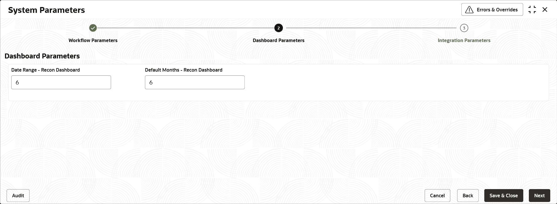

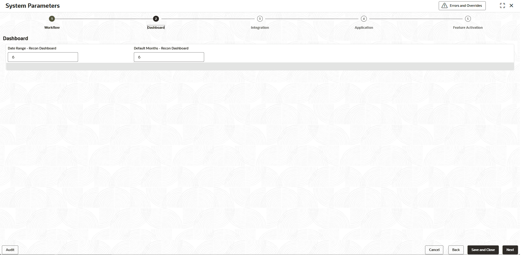

    The System Parameters - Dashboard screen displays.
    Figure 2-2 System Parameters - Dashboard Parameters
  8. On Dashboard Parameters tab, select the toggles to configure the dashboard parameters.
    Table 2-2 Dashboard - Field Description
    Field Description
    Date Range - Recon Dashboard Specify the number of days for which the reconciliation details has to be displayed on the dashboard.
    Default Months - Recon Dashboard Specify the number of months for which the reconciliation details has to be displayed on the dashboard.
  9. Click Next.

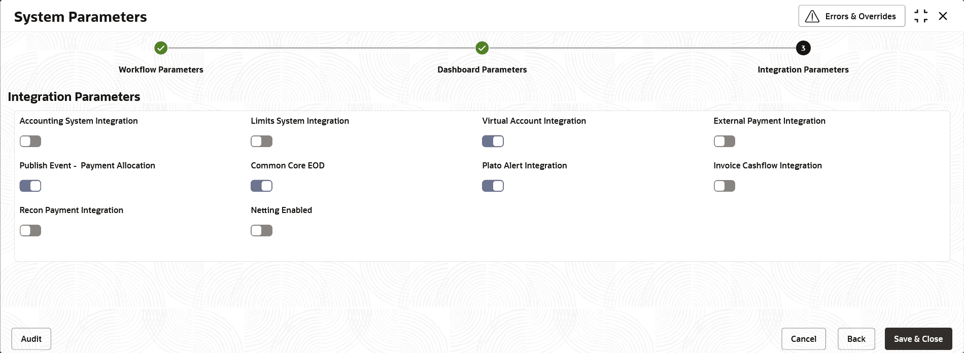

    The System Parameters - Integration (parameters) screen displays.
    Figure 2-3 System Parameters - Integration
  10. On Integration tab, select the toggles to configure the integration parameters.
    Table 2-3 Integration - Field Description
    Field Description
    Accounting System Integration Select the toggle switch to enable or disable the integration with accounting system.
    Limits System Integration Select the toggle switch to enable or disable the integration with limits system.
    Virtual Account Integration Select the toggle switch to enable or disable the integration with Virtual Account Management system.
    External Payment Integration Select the toggle switch to enable or disable the integration with the external payment system.
    Publish Event - Payment Allocation Select the toggle switch to enable or disable the publishing event for payment allocation to external applications.
    Common Core EOD Select the toggle switch to enable or disable the common core integration for EOD.
    Plato Alert Integration Select the toggle switch to enable or disable the integration with plato alerts system.
    Invoice Cashflow Integration Select the toggle switch to enable or disable the invoice integration with cashflow system.
    Recon Payment Integration Select the toggle switch to enable or disable the integration with payment system for reconciliation.

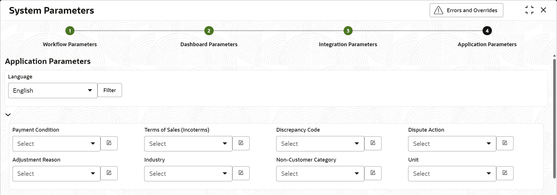

    The System Parameters - Application (parameters) screen displays.
    Figure 2-4 System Parameters - Application
  12. On Application tab, specify the fields to configure unique codes to each of the application parameters.
    Table 2-4 Application - Field Description
    Field Name Description
    Payment Condition
    Displays the list of payment conditions in the Shipping Information tab in the Create Receivables and Payables screen.
    Click the Modify icon to add new, or view the existing payment conditions.
    Terms of Sale (Incoterms)
    Displays the list of sale terms in the Shipping Information tab in the Create Receivables and Payables screen.
    Click the Modify icon to add new, or view the existing sale terms.
    Discrepancy Code
    Displays the list of dispute codes in the Raise Dispute action in the Receivables and Payables Management screen.
    Click the Modify icon to add new, or view the existing dispute codes.
    Dispute Action
    Displays the list of dispute actions in the Raise Dispute action in the Receivables and Payables Management screen.
    Click the Modify icon to add new, or view the existing dispute actions.
    Adjustment Reason
    Displays the list of adjustment reasons in the Basic Information tab in the Create Receivables and Payables screen.
    Click the Modify icon to add new, or view the existing adjustment reasons.
    Industry
    Displays the list of industries in the Receivables and Payables module.
    Click the Modify icon to add new, or view the existing industries.
    Non-Customer Category
    Displays the list of non-customer categories in the Receivables and Payables module.
    Click the Modify icon to add new, or view the existing non-customer categories.
    Unit
    Displays the list of unit types in the Receivables and Payables module.
    Click the Modify icon to add new, or view the existing unit types.
  13. Click the Modify icon next to the required application parameter for which a new code needs to be created.
    The application displays the selected parameter in the section below. You can create new codes or view the existing codes.

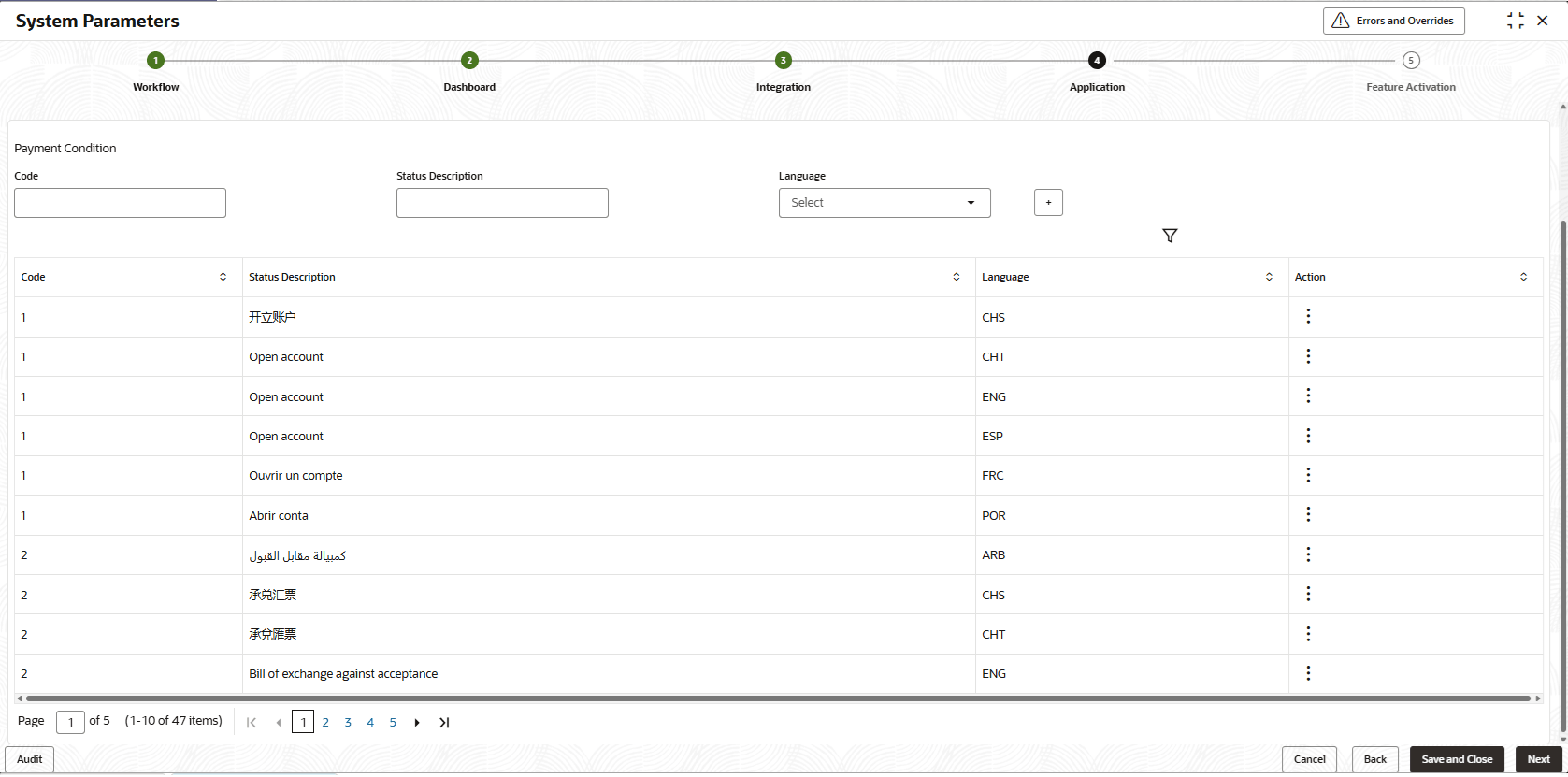

    Figure 2-5 Parameter Modification
  14. Specify the values in the below fields and click the Add icon to add the new codes.
    Table 2-5 Parameter Modification - Field Description
    Parameter Name Displays the name of the application parameter selected for modification.
    Code Specify the unique code to be created for the selected application parameter.
    Status Description Specify the description for the code to be created. You can specify the description in the required language.
    Language Select the language for which the code is to be created.
  15. Once you enter the details, click the Add icon to add a new code.
    1. Once an entry is made in the grid, click in the Action column, to Edit or Delete it.
    2. Click the Filter icon to filter the existing codes by language.

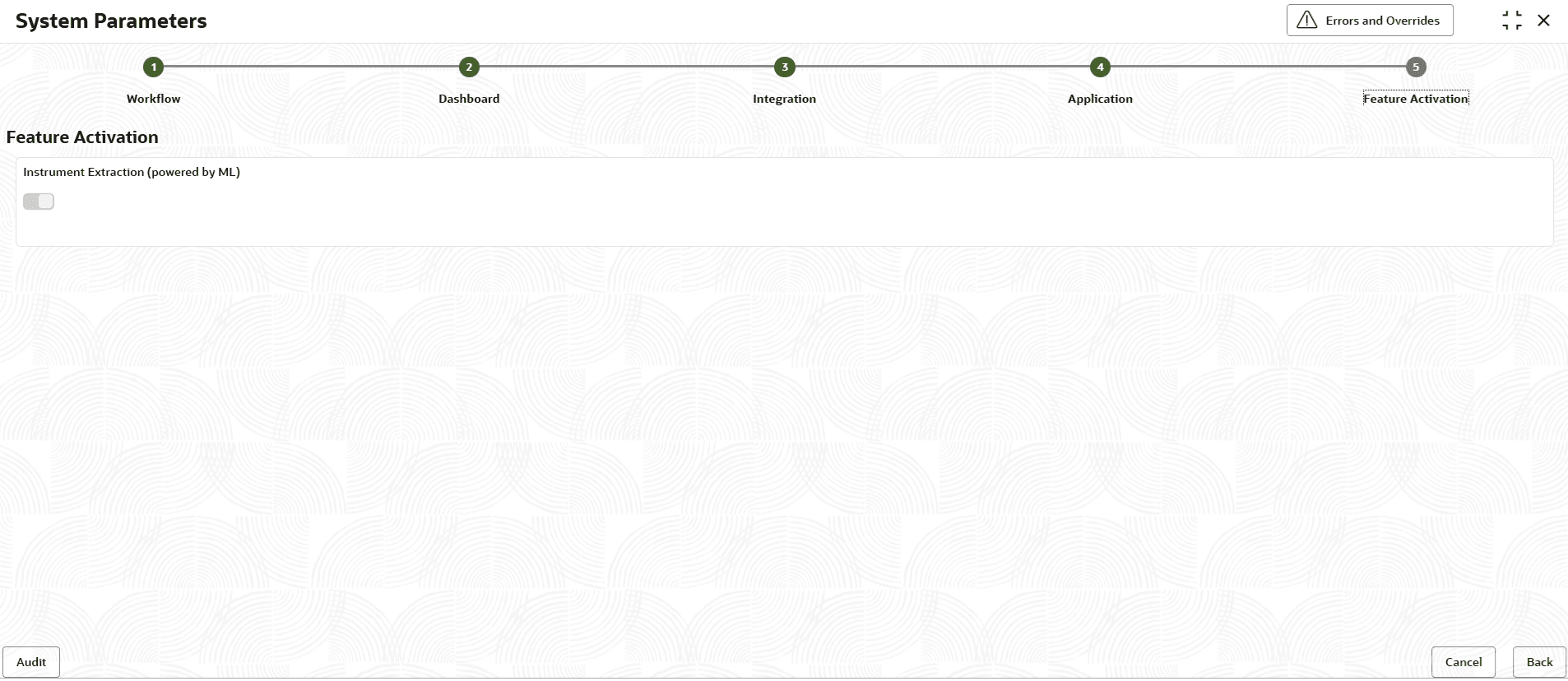

    The System Parameters - Feature Activation (parameters) screen displays.
    Figure 2-6 System Parameters - Feature Activation
    Table 2-6 System Parameters - Feature Activation
    Instrument Extraction (powered by ML) Select the toggle switch to enable or disable the invoice extraction.
