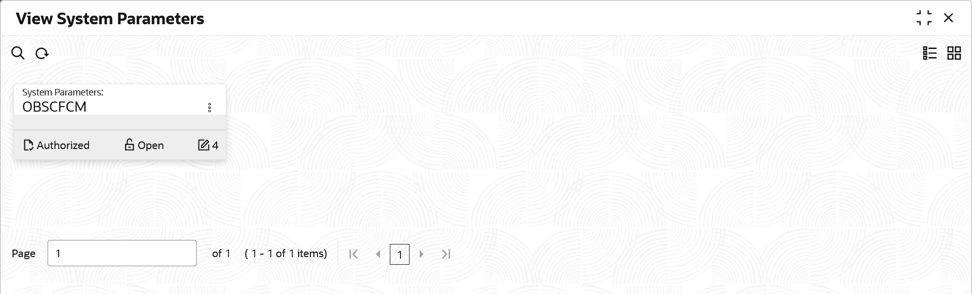

2.1 View System Parameters
This topic describes the systematic instruction to view, modify, or authorize the day zero system parameters for Receivables and Payables module.
A tile is present for each record that has been created. The bottom portion of each record-tile displays the following:
  • The status, whether Authorized, Unauthorized, or Rejected.
  • Open or Closed.
  • The number of times the record has been submitted by the Maker added.
  1. On Home screen, click Receivables & Payables. Under Receivables & Payables, click System Parameters.
  2. Under System Parameters, click View System Parameters.
    The View System Parameters screen displays.

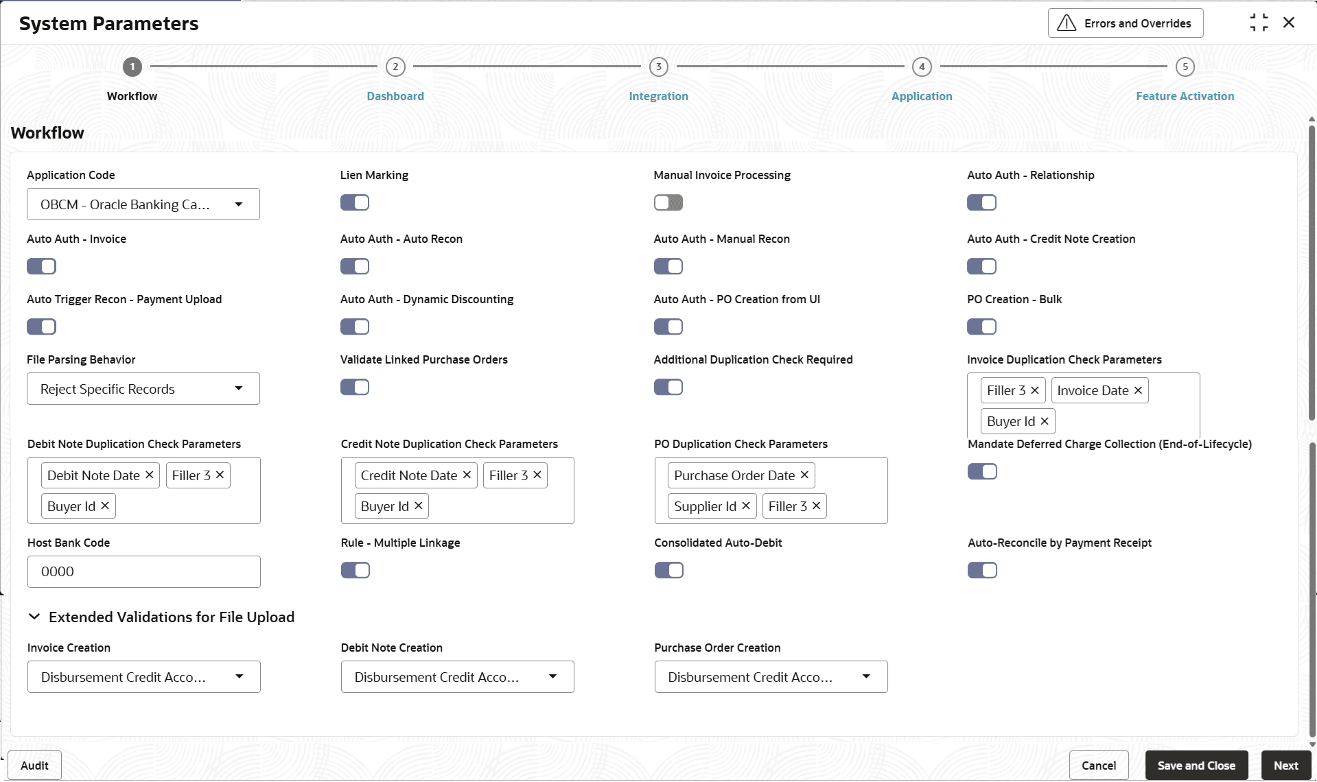

    The System Parameters - Workflow (parameters) screen displays.
  6. On Workflow tab, select the toggles to configure the workflow parameters.
    Table 2-1 Workflow - Field Description
    Field Description
    Application Code Select the applicable application code.
    The available options are:
    • OBCM- Oracle Banking Cash Management
    • OBSCF - Oracle Banking Supply Chain Finance
    • OBCM & OBSCF - Both - Oracle Banking Cash Management & Oracle Banking Supply Chain Finance
    Lien Marking Switch on/off the toggle to enable or disable the Lien Marking in the host application.
    Manual Invoice Processing Switch on/off the toggle to enable or disable the manual enrichment required for invoice processing.
    Auto Auth - Relationship Switch on/off the toggle to enable or disable the auto authorization for the relationship management.
    Auto Auth - Invoice Switch on/off the toggle to enable or disable the auto authorization for invoice transactions.
    Auto Auth - Auto Recon Switch on/off the toggle to enable or disable the auto authorization for automatic reconciliation.
    Auto Auth - Manual Recon Switch on/off the toggle to enable or disable the auto authorization for manual reconciliation.
    Auto Auth - Credit Note Creation Switch on/off the toggle to enable or disable the auto authorization for credit note creation.
    Auto Trigger Recon - Payment Upload Switch on/off the toggle to enable or disable the auto trigger of Recon when the payment file/record is uploaded.
    Auto Auth - PO Creation from UI Switch on/off the toggle to enable or disable the auto authorization for PO creation from UI.
    PO Creation - Bulk Switch on/off the toggle to enable or disable the auto authorization for bulk PO creation.
    File Parsing Behavior
    Select the type of file parsing behavior.
    • Reject All Records - If any record in a file fails, all records must be marked as failed, leading to the rejection of the entire file.
    • Reject Specific Records - If a record in a file encounters an error, the system should continue with the other records and indicate that the file processing was successful, noting which records failed or passed.
    Validate Linked Purchase Orders Switch on/off the toggle to enable or disable the validation of the purchase orders linked with invoice during creation or upload.
    Additional Duplication Check Required Switch on/off the toggle to enable or disable the additional duplication check while creating the instruments.
    Invoice Duplication Check Parameters
    Choose the extra parameters to conduct a duplication check when generating an invoice. You can select several parameters in this section.
    This field is displayed only if the Additional Duplication Check Required toggle switch is enabled.
    Debit Note Duplication Check Parameters
    Choose extra parameters to check for duplicates when making a debit note. You can select more than one parameter here.
    Credit Note Duplication Check Parameters
    Select the additional parameters to perform a duplication check while creating a credit note. You can select multiple parameters in this field.
    PO Duplication Check Parameters
    Select the additional parameters to perform a duplication check while creating a purchase order. You can select multiple parameters in this field.
    Rule - Multiple Linkage Switch the toggle on to allow a single rule to be linked to multiple decision rule .
    Host Bank Code Specify the code of the host bank in which the application is implemented.
    Auto-Reconcile by Payment Receipt Switch the toggle on, to activate the enhanced logic for payment receipt-based reconciliation, enabling the system to incorporate payment receipt records during the reconciliation process.
    By default this switch is off.
    Extended Validations for File Upload A new system parameter is introduced for each instrument type to validate the Disbursement Credit Account. When enabled, the system will check if the account number provided during creation matches the account number stored in either the Internal or External mapping for the given settlement mode. If there is a mismatch, the transaction will be flagged and placed in the Customer Account Exception free task.
    Invoice Creation Select the invoice creation of extended validations from drop-down.
    Debit Note Creation Select the debit note creation of extended validations from drop-down.
    Purchase Order Creation Select the purchase order creation of extended validations from drop-down.
  7. Click Next button.

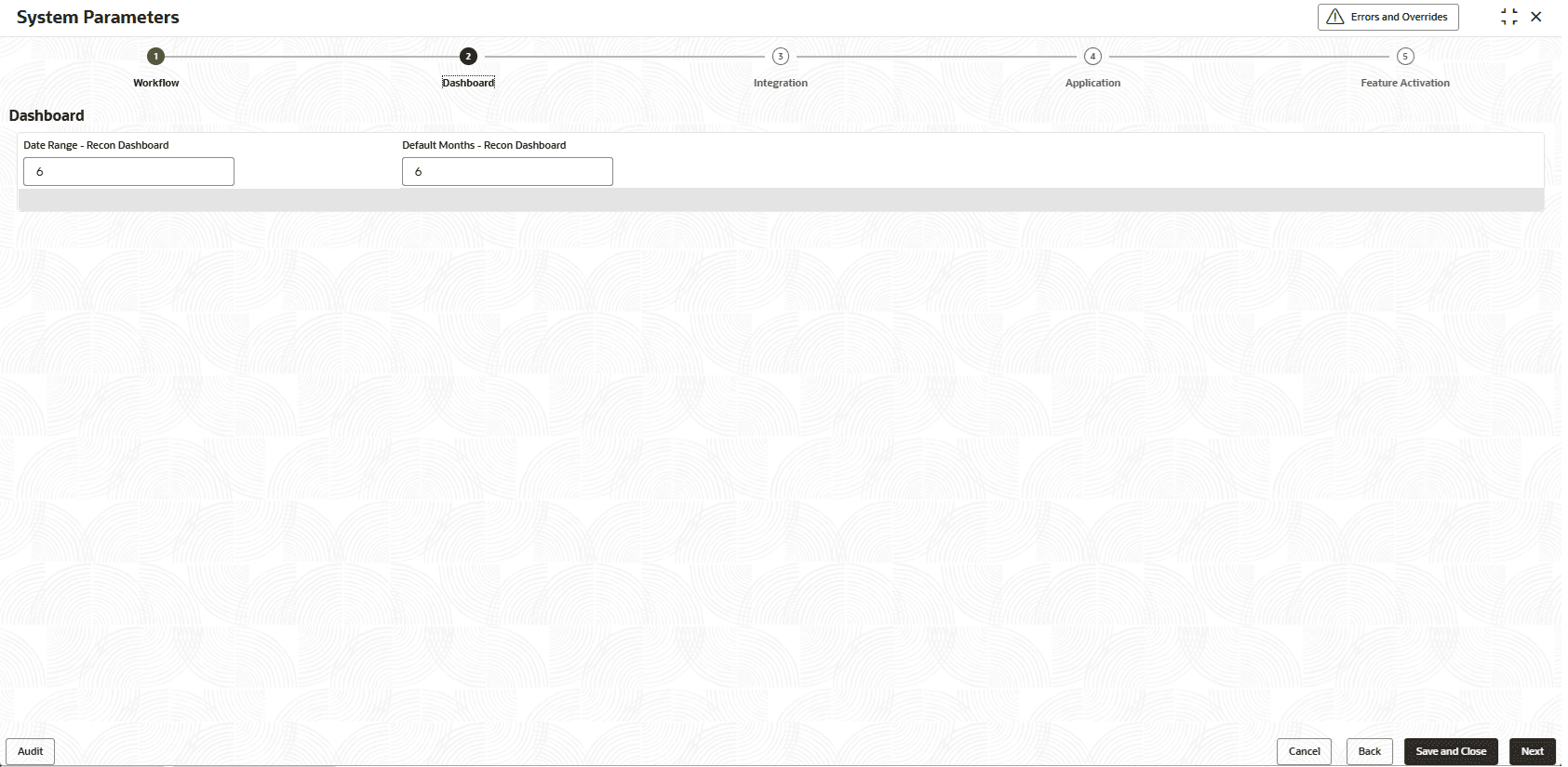

    The System Parameters - Dashboard screen displays.
    Figure 2-2 System Parameters - Dashboard Parameters
  8. On Dashboard Parameters tab, select the toggles to configure the dashboard parameters.
    Table 2-2 Dashboard - Field Description
    Field Description
    Date Range - Recon Dashboard Specify the number of days for which the reconciliation details has to be displayed on the dashboard.
    Default Months - Recon Dashboard Specify the number of months for which the reconciliation details has to be displayed on the dashboard.
  9. Click Next.

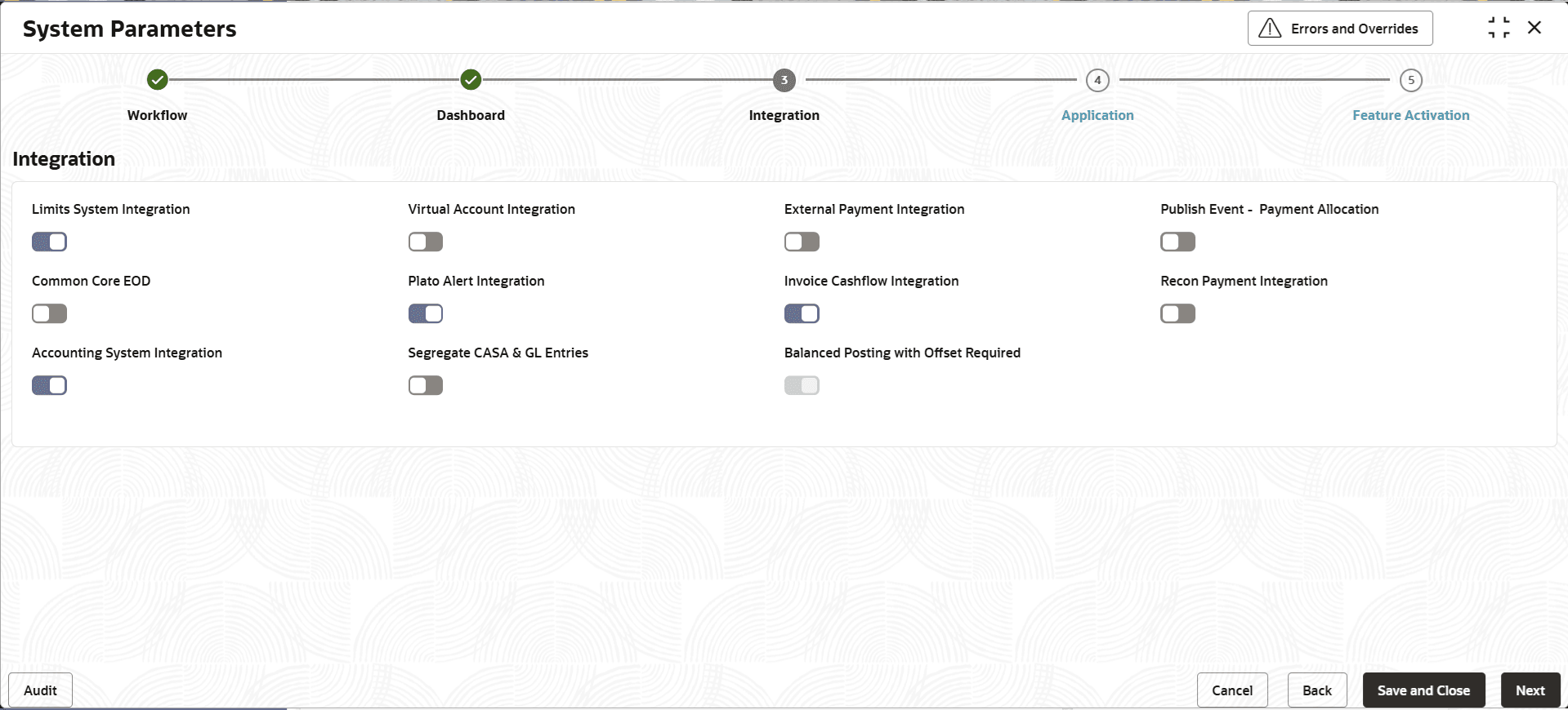

    The System Parameters - Integration (parameters) screen displays.
    Figure 2-3 System Parameters - Integration
  10. On Integration tab, select the toggles to configure the integration parameters.
    Table 2-3 Integration - Field Description
    Field Description
    Limits System Integration Select the toggle switch to enable or disable the integration with limits system.
    Virtual Account Integration Select the toggle switch to enable or disable the integration with Virtual Account Management system.
    External Payment Integration Select the toggle switch to enable or disable the integration with the external payment system.
    Publish Event - Payment Allocation Select the toggle switch to enable or disable the publishing event for payment allocation to external applications.
    Common Core EOD Select the toggle switch to enable or disable the common core integration for EOD.
    Plato Alert Integration Select the toggle switch to enable or disable the integration with plato alerts system.
    Invoice Cashflow Integration Select the toggle switch to enable or disable the invoice integration with cashflow system.
    Recon Payment Integration Select the toggle switch to enable or disable the integration with payment system for reconciliation.
    Accounting System Integration Select the toggle switch to enable or disable the integration with accounting system.
    Segregate CASA & GL Entries Select the toggle switch to enable the selection of Balanced Posting with Offset Required.
    This option is displayed if the Accounting System Integration is enabled.
    Balanced Posting with Offset Required Select the toggle switch to enable the maintenance of Offset Account with each CASA Account. Offset Account will be a GL.
  11. Click Next button.

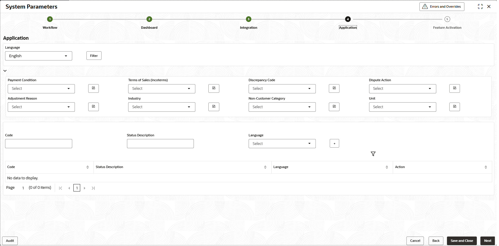

    The System Parameters - Application (parameters) screen displays.
    Figure 2-4 System Parameters - Application
  12. On Application tab, specify the fields to configure unique codes to each of the application parameters.
    Table 2-4 Application - Field Description
    Field Name Description
    Payment Condition
    Displays the list of payment conditions in the Shipping Information tab in the Create Receivables and Payables screen.
    Click the Modify icon to add new, or view the existing payment conditions.
    Terms of Sale (Incoterms)
    Displays the list of sale terms in the Shipping Information tab in the Create Receivables and Payables screen.
    Click the Modify icon to add new, or view the existing sale terms.
    Discrepancy Code
    Displays the list of dispute codes in the Raise Dispute action in the Receivables and Payables Management screen.
    Click the Modify icon to add new, or view the existing dispute codes.
    Dispute Action
    Displays the list of dispute actions in the Raise Dispute action in the Receivables and Payables Management screen.
    Click the Modify icon to add new, or view the existing dispute actions.
    Adjustment Reason
    Displays the list of adjustment reasons in the Basic Information tab in the Create Receivables and Payables screen.
    Click the Modify icon to add new, or view the existing adjustment reasons.
    Industry
    Displays the list of industries in the Receivables and Payables module.
    Click the Modify icon to add new, or view the existing industries.
    Non-Customer Category
    Displays the list of non-customer categories in the Receivables and Payables module.
    Click the Modify icon to add new, or view the existing non-customer categories.
    Unit
    Displays the list of unit types in the Receivables and Payables module.
    Click the Modify icon to add new, or view the existing unit types.
  13. Click the Modify icon next to the required application parameter for which a new code needs to be created.
    The application displays the selected parameter in the section below. You can create new codes or view the existing codes.
    Figure 2-5 Parameter Modification

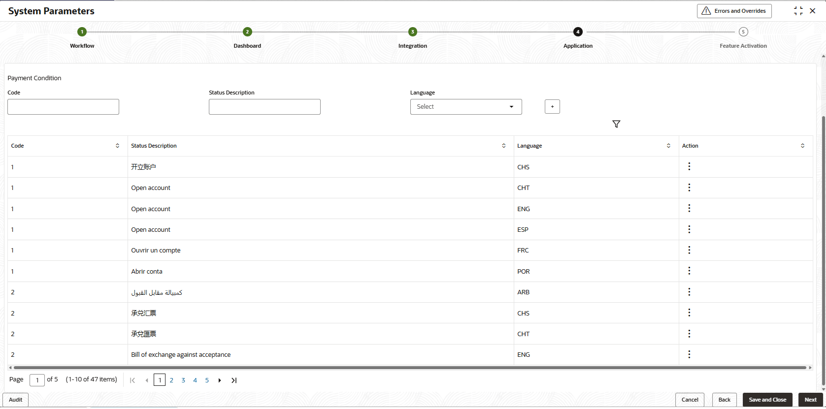

  14. Specify the values in the below fields and click the Add icon to add the new codes.
    Table 2-5 Parameter Modification - Field Description
    Parameter Name Displays the name of the application parameter selected for modification.
    Code Specify the unique code to be created for the selected application parameter.
    Status Description Specify the description for the code to be created. You can specify the description in the required language.
    Language Select the language for which the code is to be created.
  15. Once you enter the details, click the Add icon to add a new code.
    1. Once an entry is made in the grid, click in the Action column, to Edit or Delete it.
    2. Click the Filter icon to filter the existing codes by language.

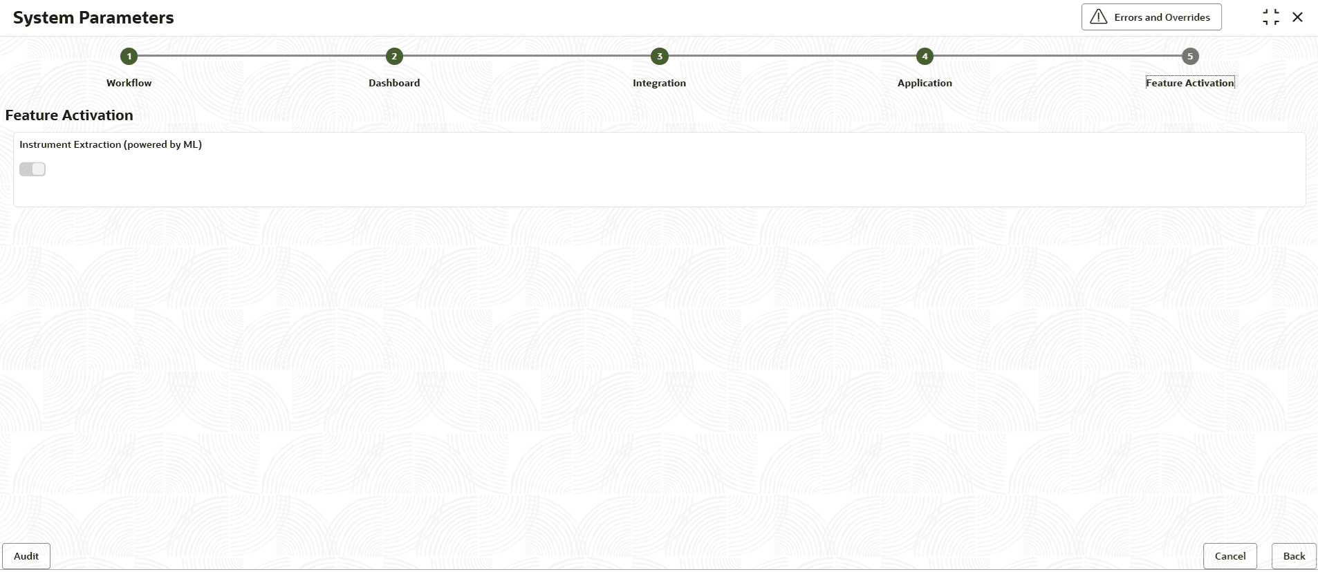

    The System Parameters - Feature Activation (parameters) screen displays.
    Figure 2-6 System Parameters - Feature Activation
    Table 2-6 System Parameters - Feature Activation
    Instrument Extraction (powered by ML) Select the toggle switch to enable or disable the invoice extraction.
