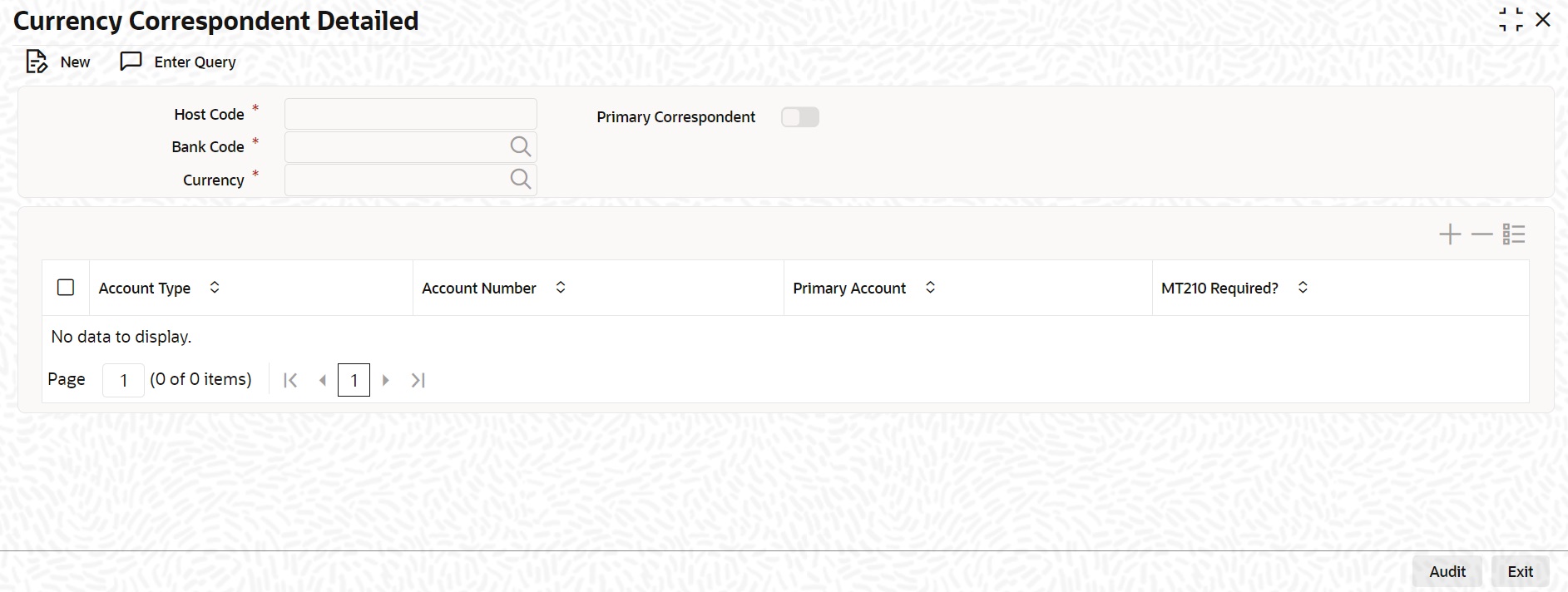

  1. On the homepage, type PMDCYCOR and click next arrow.
    The Currency Correspondent Detailed screen is displayed.
    The fields which are marked in asterisk red are mandatory fields.
    Figure 2-14 Currency Correspondent Detailed
  2. Maintain the AWI or AWI’s Currency Correspondent on this screen.
  3. You can enter below details in this tab. For information on fields, refer to the field description table.
    Table 2-11 Currency Correspondent Maintenance
    Field Description
    Host Code The system displays the host code of the selected branch of the logged in user.
    Bank Code Select the Bank Code from the list of values displayed. Selected BIC Code is displayed in this field.
    Currency Specify the currency. Alternatively, you can select the currency from the option list. The list displays all valid currencies maintained in the system.
    Primary Correspondent Check Select this box if this correspondent is the primary currency correspondent. There can be only one primary currency correspondent for the combination of Account type, Currency. Account Type Select the account type. The list displays the following values:
    • Our- Account maintained with the correspondent input in the Bank Code field.
    • Their- Account maintained by the correspondent input in the Bank Code field with the Processing bank (Nostro account).
    Account Type Specify the account type as Our – the Nostro of the Correspondent which is maintained in our books.
    Account Number Specify the account number associated with the correspondent input in the Bank Code field in the specified currency.
    Alternatively, you can select the account number from the option list. The list displays all Nostro accounts for Account type OUR and valid normal accounts for account type THEIR. The account currency displayed in the list should be same as the currency specified.
    Primary Account Select this check box to indicate if the account is the Primary Account. You can add multiple accounts. But only one account can be marked as Primary Account. This indicates that the account marked as Primary account is the key account for the Host Code, Bank Code, Currency combination maintained.
    MT 210 required? Select this check box to indicate if MT 210 is required to be sent to the Currency Correspondent in the scenarios where it is auto-generated like generation of Outbound MT 200/MT 201. Only if this check box is selected, the system generates the MT210.
