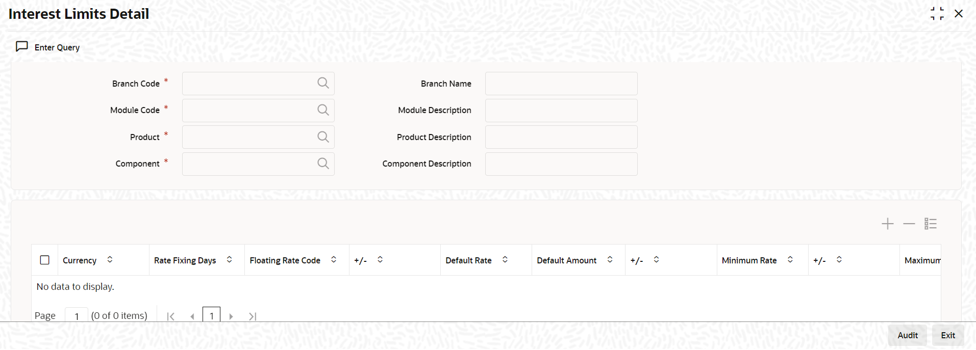

To capture details of interest limits details screen
Specify the User ID and Password, and login to Homepage.- On the Homepage, type OLDINTLM and click next
arrow.The Interest Limits Detail screen is displayed.
The fields which are marked in asterisk red are mandatory fields. - When an interest class for which currency-wise interest limits have been

- You can maintain the following information to set up the tenor-based,
currency-wise interest limits for a product, interest component, and branch
combination.
Table 1-11 Interest Limits Detail
