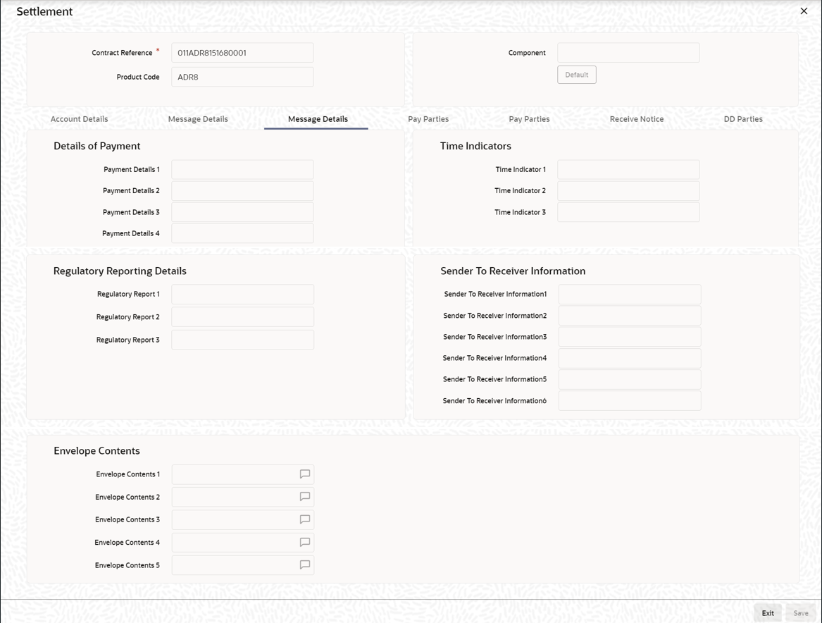

    The Message Details screen is displayed.
    Figure 1-9 Message Details Tab 2
  2. You can enter the following details in this tab. For information on fields, refer to the field description table.
    Table 1-10 Message Details
    Field Description
    Sender to Receiver Information on Confirmation The sender to receiver information maintained in the settlement instructions can be defaulted in the Field 72 during the confirmation of messages. Selecting this box defaults the information in Field 72. Leave the box deselected to indicate otherwise.
    Regulatory Reporting Details This field corresponds to field 77B of a SWIFT message. For the receiver or sender, you need to maintain the code (s) for the statuary or regulatory information, which is mandatory as per the rules of the specified country.
