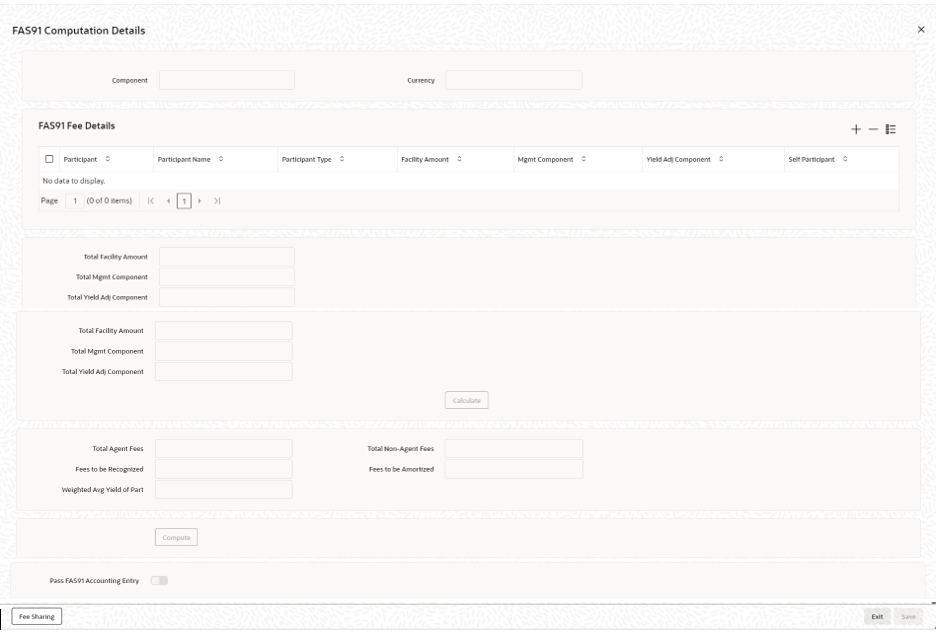

In the Fee Components screen, you can capture the FAS91 fee details.
Figure 4-15 FAS91 Computation Details

Click FAS91 to specify information related to FAS91 in the FAS91 Computation Details screen. This option is enabled only for components where the FAS91 check box is selected at the product level.
Click to select the participants for whom you want to calculate FAS91 details. A Participant Selection screen pops up with a list of all customers maintained in the system. On selecting the participants, system will display the same under the FAS91 Fee Details section in the FAS91 Computation Details screen.
The other details required to be maintained in this screen are as follows:

Once you specify the above details, click in the FAS91 Computation Details screen. System computes and display the values for the following fields.
  • Total Bank Fees
    This is the sum of the Mgmt Component and Yield Adj Component for all participants for which the Self Participant’ check box is deselected.
  • Weighted Avg Yield of Part
    System displays the weighted average yield of the participant. This is calculated as follows:
    Sum (Yield Adjustment Component across all Participants which are not Leaders/Co Leaders and not Self Participant) / Sum (Facility amount across all Participants which are not Leaders/ Co Leaders and not Self Participant)
  • Fees to be Amortized
    System displays the fees to be amortized. This is calculated as follows:
    Sum (Facility Amount for all self participants) * Weighted Average Yield
  • Fees to be Recognized
    System displays the fees to be realized. This is calculated as follows:
    Sum (Mgmt Component + Yield Adj Component of self participants) – (Fees to be amortized)
  • Pass FAS91 Accounting Entry
    Select this check box to indicate that you can pass accounting entries for FAS91.
You can liquidate FAS91 fees with other fee components.
