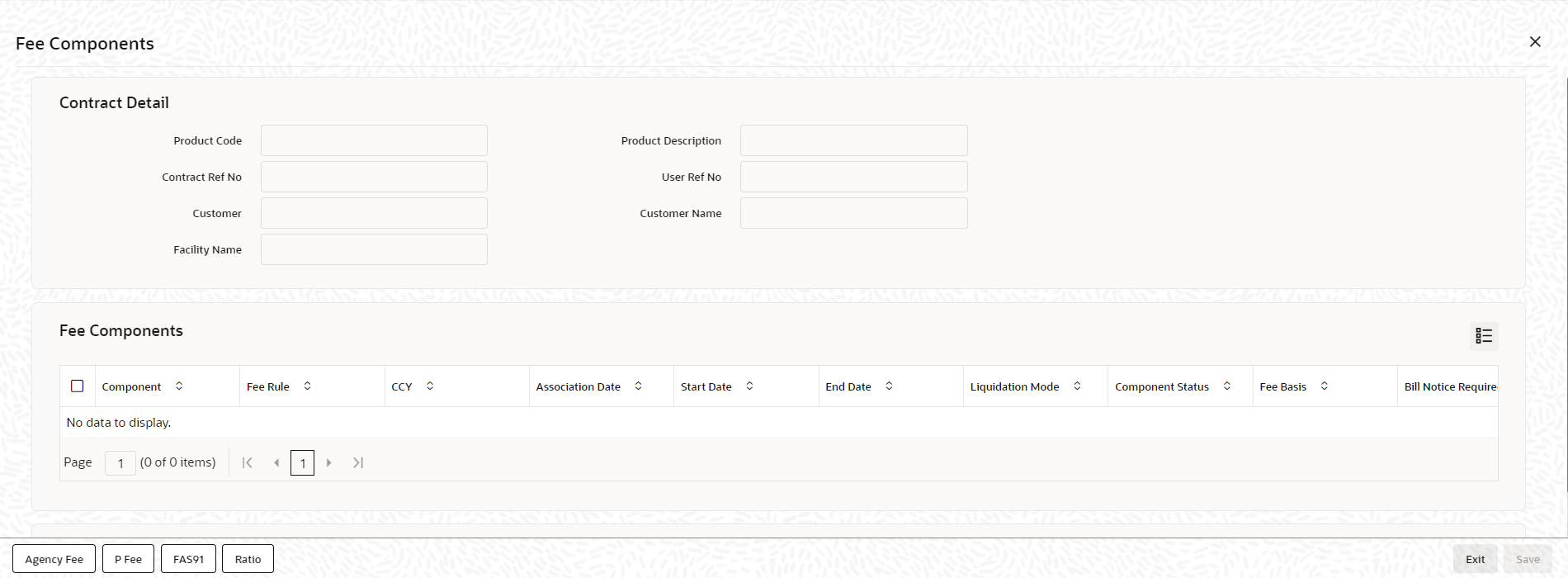

4.5.6 Specify Facility Fee Details
The fee components defined for the underlying facility product becomes applicable to the contract. To view the fee details, click Fee.
The following details of the components are displayed based on the product used:
  • Component name
  • Fee Rule, if applicable
  • Fee Currency
  • Date of Association of the component with the contract. This is equal to the current system date.
  • Component Start Date
  • Component End Date
  • Mode of liquidation, whether Auto or Manual
  • Status of the component. On the schedule start date, the status will be Active. The system automatically updates the status to Liquidated when the all the schedules of the component is liquidated.
  • The fee basis to calculate the fee amount for schedules. This is defaulted from the product level.
  • Whether Billing Notice should be generated for the contract
  • Billing notice days required
  • Whether this FEE component should be considered for Discount Accrual.
  • If the fee end date is less than the current business date, then the Fee Reversed box is selected automatically.
You can modify the following details only:
Table 4-8 Fee Components Details
Fields Description
Start Date By default, the start date is equal to the Facility Start Date. This is the date on which the adhoc fee component becomes applicable for the facility. You can change the date only if the Allow Start Date Input is selected for the component (in the Borrower Product – FEE Details screen). If allowed to modify, the new date should be:
  • Within the facility start date and end date.
  • Within the start and end date of the facility product.
End Date By default, the end date will be equal to the Facility End Date. This date marks the end of the component association period for the facility. You can change this date only if the Allow End Date Input is selected for the component (in the Borrower Product – FEE Details screen). If allowed to modify, the new date should be:
  • Later than the facility start date.
For more information on Borrower Product – FEE Details screen, refer the heading Specifying fee components for a borrower product in the Defining Products for Loan Syndication chapter of this User Manual.
Liquidation Mode You can opt to liquidate the components in one of the following ways:
  • Auto: The system automatically liquidates the schedule during EOD on the schedule due date of the component.
  • Manual: If you select this mode, you have to liquidate the fee components through the Fee Liquidation screen.
Billing Notice Reqd This value defaults from the product level and indicates whether you want to generate a billing notice for the associated component. You can amend this option, if required.
(Note: If the Billing Notice Required option is not checked for the product, you can not opt for the same at the contract level. Billing notice is not generated for such contracts.)
Billing Notice Days The billing notice days get defaulted from the product level. You can amend this value if required.
For more details on the manual mode of liquidation, refer the heading Liquidating Fee Components in the Processing Charges and Fees topic of this User Manual.
This topic contains following sub-topics:
