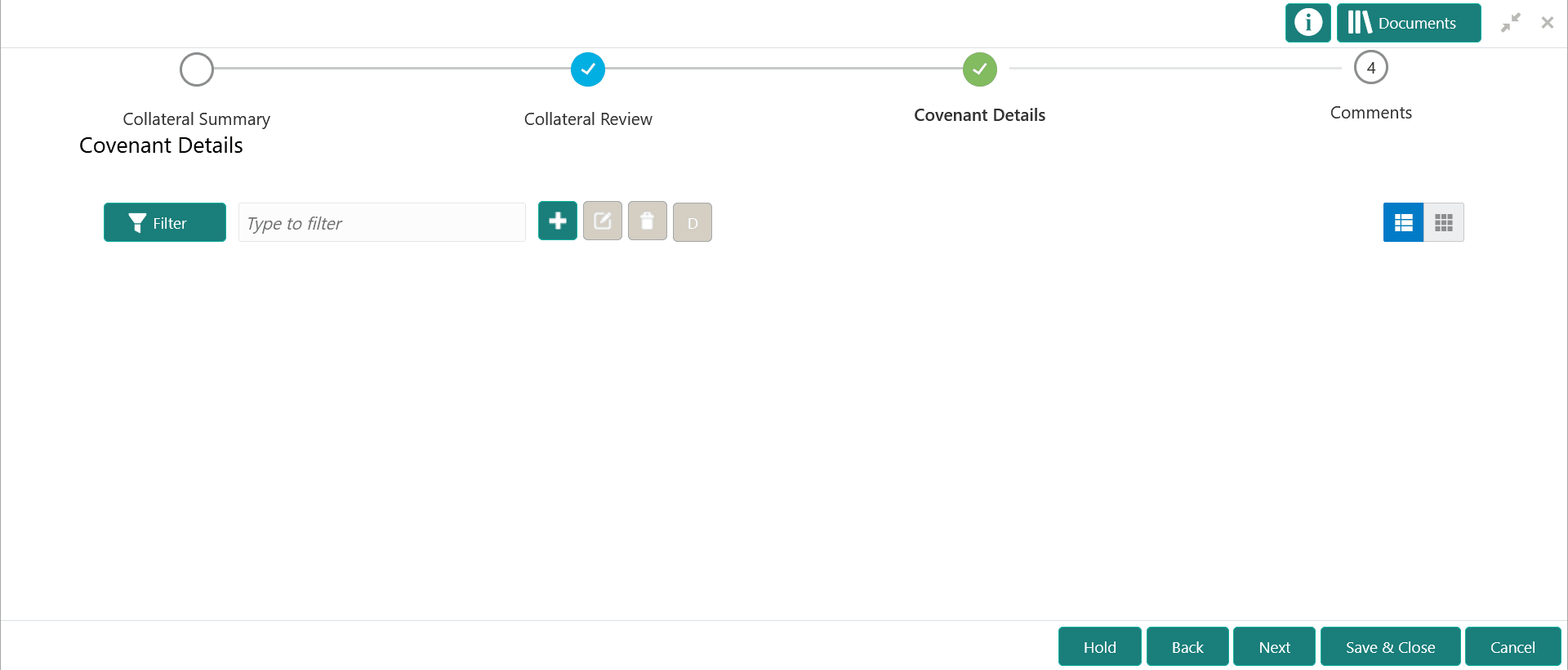

Click Next in the Collateral Review screen, the Covenant Details data segment is displayed.
Figure 12-4 Collateral Review - Covenant Details
Option to add and manage covenants
  1. To add a covenant, click the add icon.
    The Covenant Details window is displayed.
