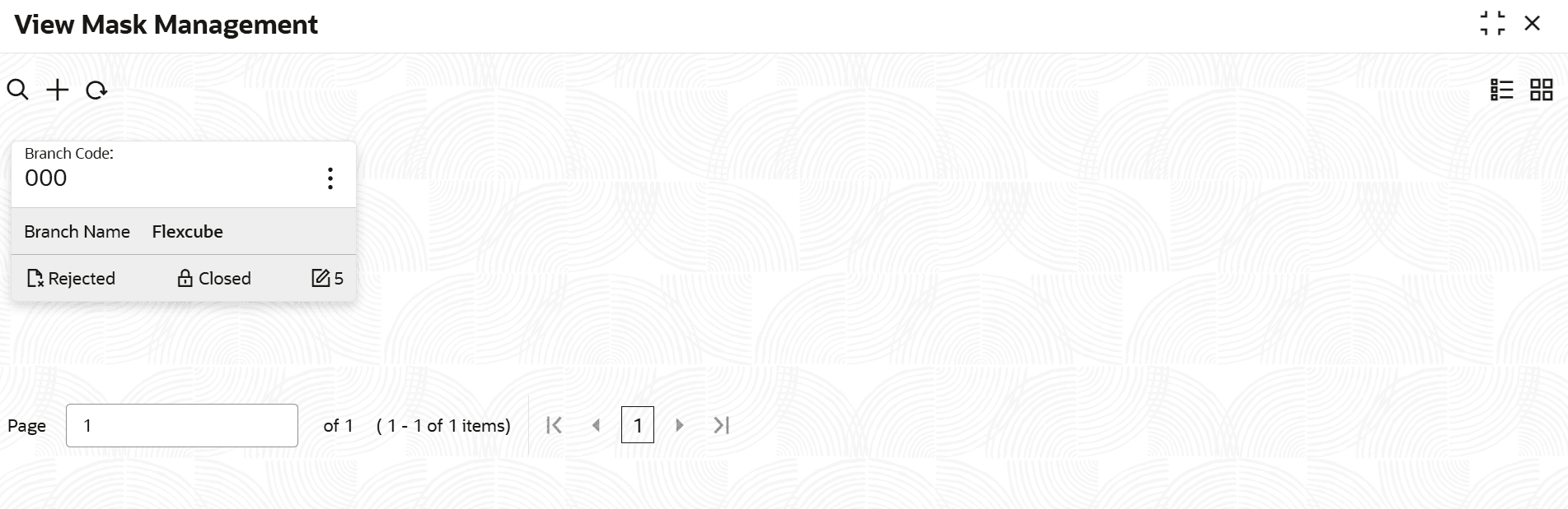

    Figure 13-3 View Mask Management
  3. Click the list view icon at the top right corner to change the table view to list view.

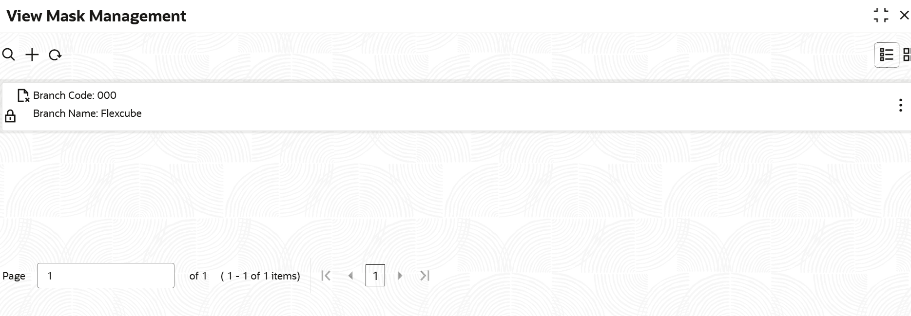

    The View Mask Management screen is displayed as shown below.
    Figure 13-4 View Mask Management - List

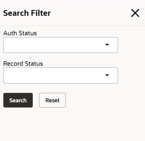

  4. Click the search icon to search the required mask management record.
    The search bar is displayed as shown below.
  5. Select the status of mask management record based on description in the following table.
    Table 13-2 View Mask Management - Search - Field Description
    Field Description
    Auth Status Select the authorization status of the mask management record. The available options are:
    • Authorized
    • Unauthorized
    Record Status Select the Record Status of the mask management record. The available options are:
    • Open
    • Closed
  6. Click Search.
    The mask management records that match the search parameters are displayed.
