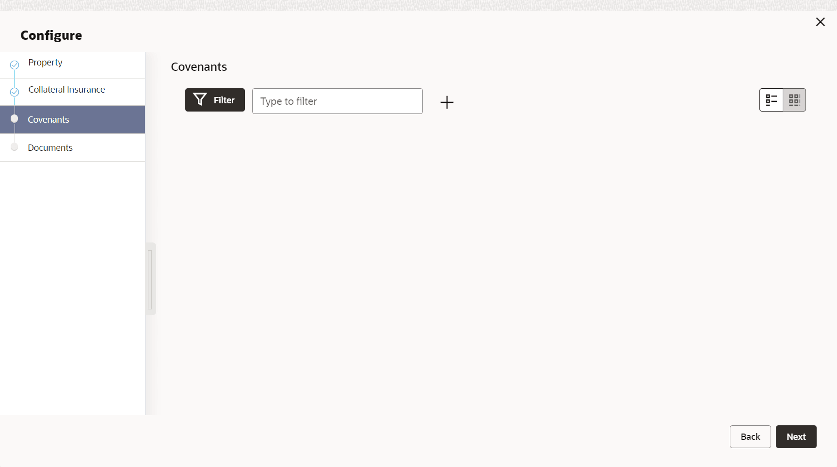

Figure 3-15 Enrichment - Configure - Covenants
- To add new covenant, click the add icon.The Covenant Details screen is displayed.

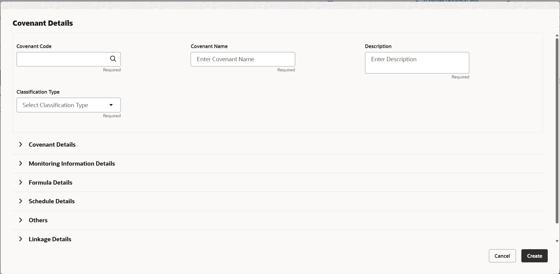

For example, we maintained 20 additional fields each for text, numeric, boolean, and date.
The Covenant Details screen displays. - To link existing covenant, click the search icon and select the
Covenant Code.
The covenant codes maintained in the Covenant Maintenance screen are displayed in LOV.
Upon selecting the Covenant Code, Covenant name, Covenant description and Classification type are defaulted.
- To create new covenant, click the Click to add new
covenant link and specify all the details.
For field level information, refer the following tables.
Table 3-13 Covenant Details - Field Description
Field Description Covenant code Specify a unique code for the covenant to be created. Covenant name Specify a name for the covenant to be created. Covenant description Provide a brief description about the covenant. Classification type Specify the covenant Classification Type as Internal and External. Table 3-14 Covenant Details - Covenant Details - Field Description

- To edit the added covenant, select the covenant record and click the Edit icon.
- To delete the added covenant, select the covenant record and click the Delete icon.
- After performing necessary actions in the Enrichment - Configure -
Covenants screen, click Next.The Enrichment - Configure - Documents screen is displayed.
