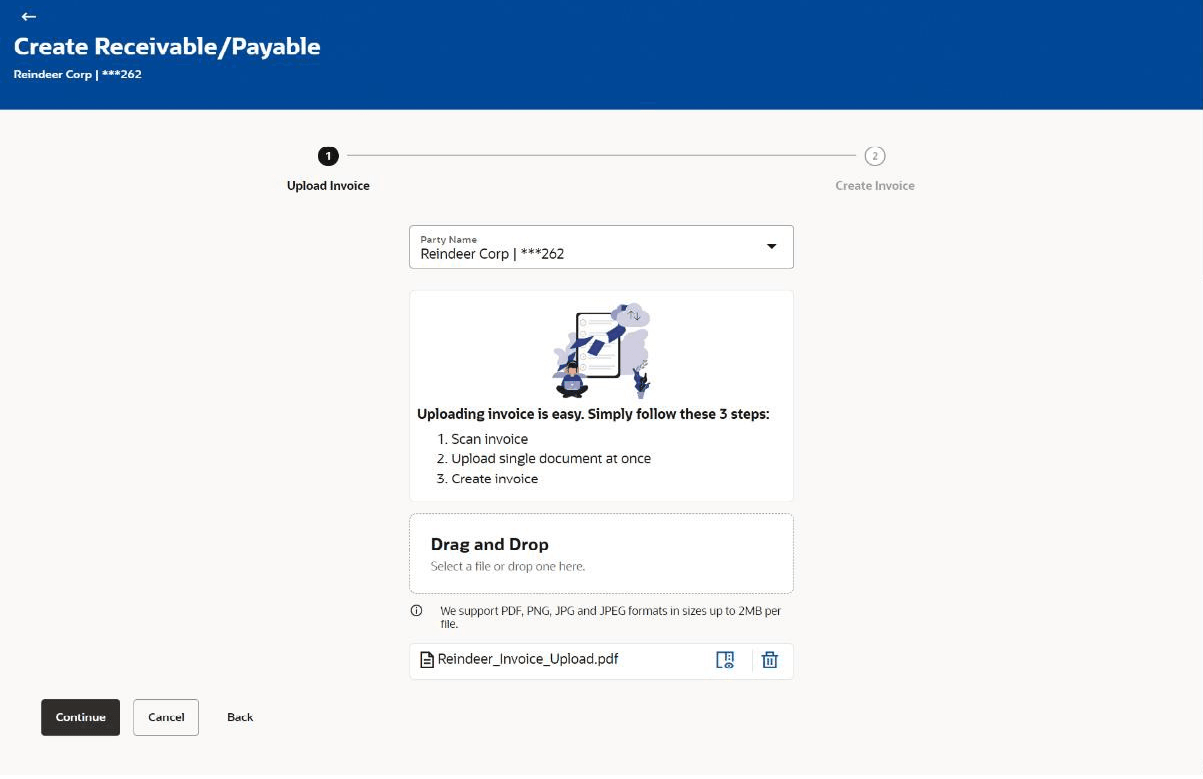

  2. In the Create Receivable/Payable screen, select the Invoice option and then click the Invoice Document Upload button. The Create Receivables/Payables screen appears starting with the Upload Invoice step.
    Figure 2-11 Create Receivables/Payables – Upload Invoice
  3. In the Upload Invoice step, either click to browse and select the required file, or, drag and drop the file in the space provided. An entry for the uploaded file appears in the section below.
    To preview an uploaded file, click the Preview link beside it. To remove an uploaded file, click Delete.
  4. Click Continue to go to the Create Invoice step. Or, do one of the following:
    • Click Cancel to cancel the transaction.
    • Click Back to go to the previous screen.

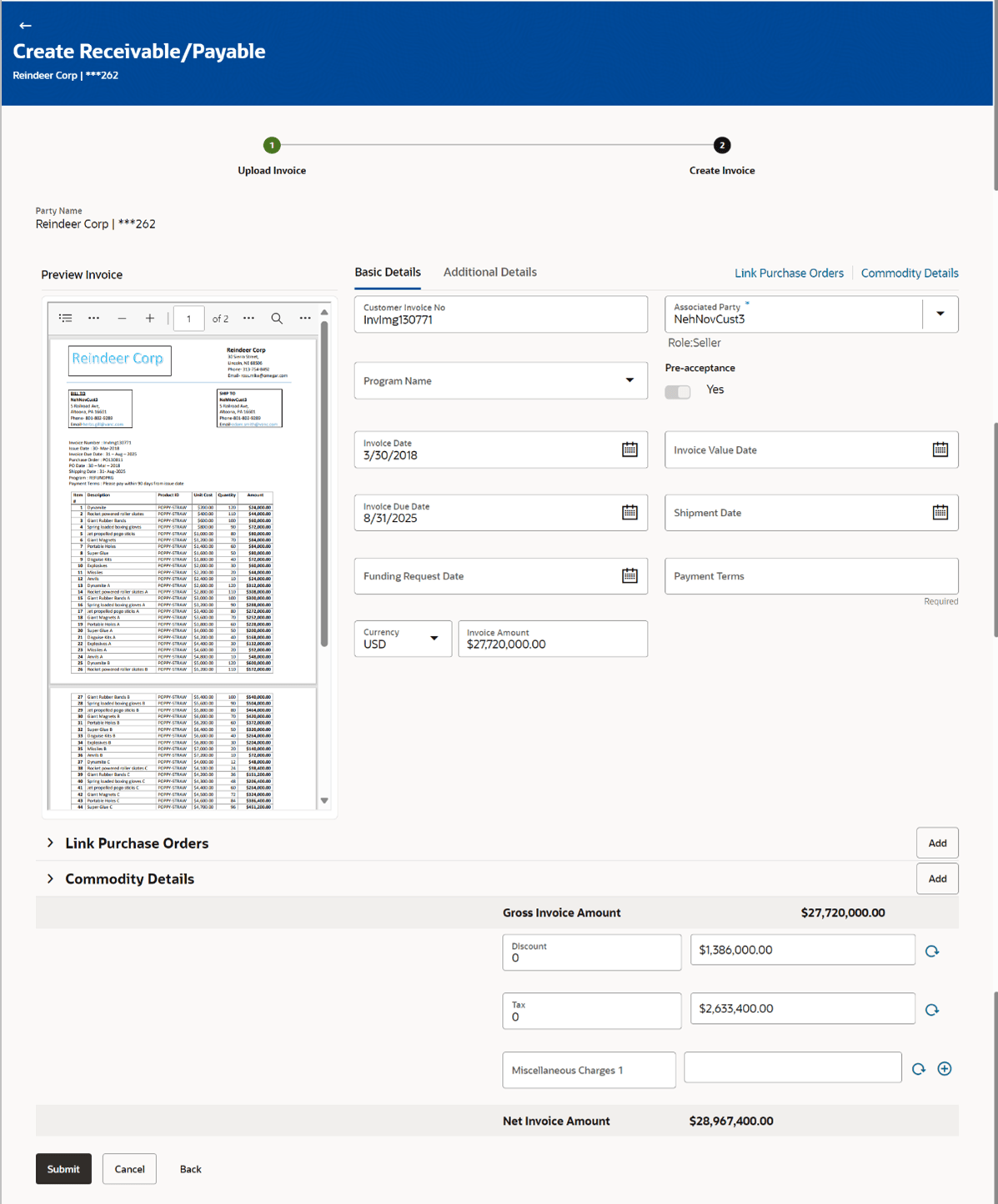

    Figure 2-12 Create Receivables/Payables - Create Invoice - Basic Details

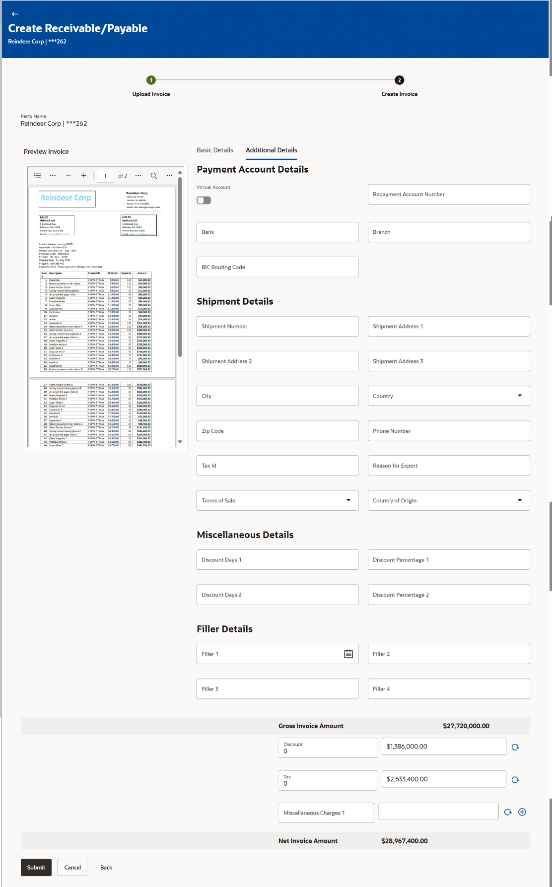

    Figure 2-13 Create Receivables/Payables - Create Invoice - Additional Details
    Table 2-8 Field Description
    Field Name Description
    Party Name & ID Displays the name and ID of the logged-in corporate party.
    Create Invoice step The values that have been extracted from the invoice image (except for commodity details) are automatically populated in the respective fields. You can edit these values, if required.
    Customer Invoice No Indicates the customer’s own reference number of the invoice.
    Associated Party Indicates the associated party with whom the invoice is to be linked. A list of all on-boarded associated parties is available for selection.
    On selecting an associated party, the role of the party as Buyer or Supplier, appears below this field.
    Program Name Indicates the program to which the invoice needs to be linked. Programs linked to the selected associated party are listed. This field is visible only if the Oracle Banking Supply Chain Finance application is implemented by the bank.
    Auto Accept Displays whether the invoice will be auto accepted or not. It is populated based on the auto acceptance setting in the program definition and is non-editable. For more information, refer the Create Program section in User Manual Oracle Banking Digital Experience Corporate Supply Chain Finance.
    Auto Finance Displays whether the invoice will be auto financed or not. It is populated based on the auto finance setting in the program definition and is non-editable. For more information, refer the Create Program section in User Manual Oracle Banking Digital Experience Corporate Supply Chain Finance.
    Pre-acceptance This toggle is set to ‘No’ and is disabled if the logged-in party is the supplier. It is set to ‘Yes’ and is disabled if the logged-in party is the buyer.
    Invoice Date Indicates the date of creation of the invoice.
    The Invoice Date should be greater than the Purchase OrderDate.
    Invoice Value Date Click the calendar icon and select the invoice value date. This date can be earlier than the Invoice Date.
    Invoice Due Date Indicates the date on which the invoice payment is due.
    The Invoice Due Date should be greater than or equal to the Invoice Date.
    Shipment Date Indicates the date when the shipment is expected to take place.
    The Shipment Date should be greater than the Purchase Order Date and greater than or equal to the Invoice Date.
    Funding Request Date Enter the date when the invoice should be funded. This field is visible only if the Oracle Banking Supply Chain Finance application is implemented by the bank.
    Payment Terms Indicates the terms agreed for the payment of the invoice.
    Invoice Amount Indicates the total invoice amount of all commodities being purchased, along with the currency.
    Additional Details Click Additional Details tab to add additional details such as payment account, shipment, miscellaneous, and filler details.
    Virtual Account Switch this toggle ON, if the account is a virtual account.
    Repayment Account Number Specify the account number to send the repayment amount to.
    Bank Specify the bank name of the repayment account number
    Branch Specify the branch name of the repayment account number
    BIC Routing Code Specify the BIC or SWIFT code of the financial institution, to send the payment amount to.
    Shipment Details This section displays Shipment details.
    Shipment Number Specify the shipment number.
    Shipment Address 1 - 3 Specify the shipment address in the fields provided.
    Shipment City Specify the city to ship the goods to.
    Shipment Country Select the country to ship the goods to.
    Zip Code Specify the zip code to ship the goods to.
    Phone Number Specify the contact number of the person who will receive the shipment.
    Tax Id Specify the unique tax ID if the shipment charge includes tax amount.
    Reason for Export Specify the relevant reason of export.
    Terms of Sale Specify the applicable 3-digit Incoterms code. The available values are:
    • EXW | Ex Works
    • FAS | Free Alongside Ship
    • FCA | Free Carrier
    • FOB | Free On Board
    • CPT | Carriage Paid To
    • CFR | Cost and Freight
    • CIP | Carriage and Insurance Paid To
    • CIF | Cost Insurance and Freight
    • DAP | Delivered at Place
    • DPU | Delivered at Place Unloaded
    • DDP | Delivered Duty Paid
    Country of Origin Specify the country from where the shipment will originate.
    Miscellaneous Details This section displays the Miscellaneous details.
    Discount Days 1 Specify the primary discount days.
    Discount Percentage 1 Specify the primary discount percentage.
    Discount Days 2 Specify the secondary discount days.
    Discount Percentage 2 Specify the secondary discount percentage.
    Filler Details This section displays the Filler details.
    Filler Fields 1 to 4 This section displays the Filler Label Fields. The bank can configure these fields on Day 0, based on their requirement.

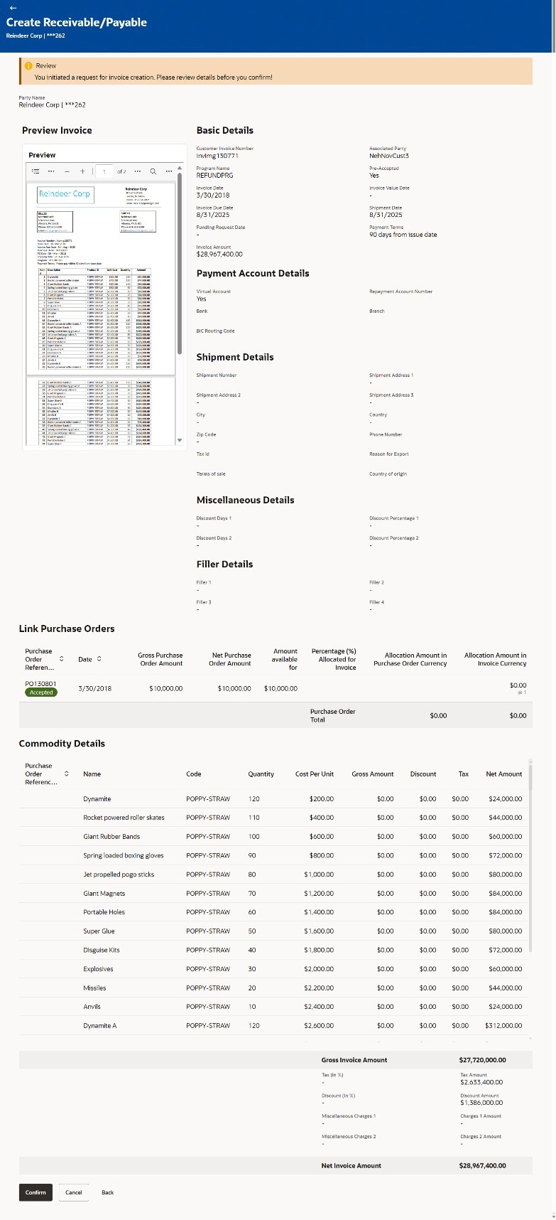

  5. Click the Add button to link the purchase orders to invoice.
    The Link Purchase Orders overlay screen appears.
Link Purchase Orders Overlay
This overlay window appears when you click the Add button in the Link Purchase Orders section.
You can now link purchase orders of a different currency to an invoice. If multiple purchase orders are linked to an invoice, then the purchase orders should be of same currency.
Figure 2-14 Link Purchase Orders Overlay

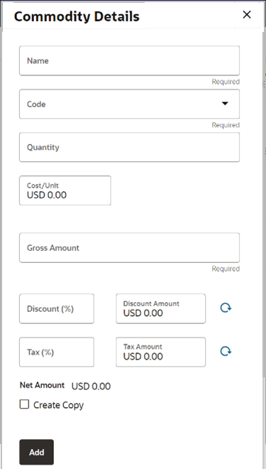

  4. To add a commodity, click Add in the Commodity Details section.
    The Commodity Details overlay window appears.
    Table 2-10 Field Description
    Name Specify the name of the commodity.
    Code Select the code of the commodity. This value should be selected from the commodity code list.
    Note: This drop-down field displays the list of commodity code(s) maintained for the selected supplier party.
    Quantity Specify the quantity of the commodity being purchased.
    Cost/Unit Specify the cost per unit of the commodity.
    Gross Amount Specify the gross commodity amount. It also gets auto calculated if quantity and cost per unit are entered. It is the product of the entered quantity and cost per unit.
    Gross Amount = Cost/Unit * Quantity
    Discount Specify any discount being offered on the commodity. You can either enter the percentage of discount (in the first field) or the actual discount amount (in the second field). When you enter any one of these values, the other value is automatically calculated and displayed.
    Note: This field is auto populated if a discount percentage is maintained for the selected commodity code.
    Click Reset to reset the values.
    Tax Specify any tax being charged on the commodity. You can either enter the percentage of tax (in the first field) or the actual tax amount (in the second field). When you enter any one of these values, the other value is automatically calculated and displayed.
    Note: This field is auto populated if a tax percentage is maintained for the selected commodity code.
    Net Amount Displays the net commodity amount. This is automatically calculated as follows:
    Net Amount = Gross Amount – Discount + Tax
    Create Copy Select this check box to create a copy of the commodity details entered.
    On clicking the Add button, a commodity record is created in the Commodity Details section.

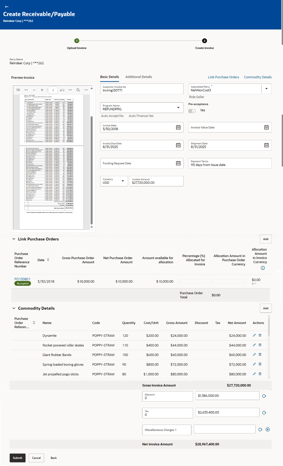

  5. Check all the extracted details and add or modify any value, if required.
    Figure 2-16 Create Receivables/Payables – Link Purchase Orders to Invoice and Commodity Details
    Table 2-11 Field Description
    Link Purchase Order This section displays the list of purchase orders to be linked to the invoice once you add them.
    Purchase Order Reference Number Status Displays the unique reference number of the purchase order. Also displays the status of the purchase order below the reference number.
    Date Displays the date on which the purchase order has been created.
    Gross Purchase Order Amount Displays the gross purchase order amount.
    Net Purchase Order Amount
    Displays the total purchase order amount, after deducting the discount and then applying the tax.
    Note: The Net Purchase Order Amount gets automatically calculated as follows:
    Net Purchase Order Amount = Gross Purchase Order Amount - Discount Value + Tax Amount
    Amount Available for Allocation Displays the purchase order amount available for allocation to Invoice.
    Percentage (%) Allocated for Invoice Enter the percentage of available purchase order amount to be allocated for invoice. This value is automatically calculated and displayed if you enter the amount allocated for invoice.
    Allocation Amount in Purchase Order Currency Displays the purchase order amount allocated for invoice in purchase order currency. This value is automatically calculated and displayed if you enter the percentage allocated for invoice.
    Allocation Amount in Invoice Currency Displays the purchase order amount allocated for invoice in invoice currency. This value is automatically calculated and displayed if you enter the percentage allocated for invoice.
    Purchase Order Total Displays the total amount allocated from purchase order to the invoice in invoice currency. This value is automatically calculated and displayed.
    Commodity Details This section displays the commodity detail records once you add them. Multiple commodities can be added.
    Name Displays the name of the commodity.
    Code Displays the code of the commodity.
    Quantity Displays the quantity of the commodity being purchased.
    Cost/Unit Displays the cost per unit of the commodity in the invoice currency.
    Gross Amount
    Displays the total gross amount of the commodity being purchased. It is the product of the entered quantity and cost per unit.
    Gross Amount = Cost per unit * Quantity
    Discount Exchange Rate Displays the discount amount and percentage being offered on the commodity. The exchange rate between invoice currency and purchase order currency is displayed if a purchase order is linked to an invoice.
    Tax Exchange Rate Displays the tax amount and percentage being charged on the commodity. The exchange rate between invoice currency and purchase order currency is displayed if a purchase order is linked to an invoice.
    Net Amount
    Displays the net amount of the commodity being purchased. It is automatically calculated as follows:
    Actions
    Indicates the actions that can be performed on the commodity record.
    • Click Edit to edit the record.
    • Click Delete to remove the record.
    Gross Invoice Amount Displays the total gross amount of all the added commodities.
    Discount
    Displays the total discount amount of all the commodities added. The average discount percentage of all added commodities is also displayed.
    Click refresh to reset the values.
    Total Discount % = (Total discount amount / Total invoice amount) *100
    Note: When commodity records are not added, the discount value of the purchase orders is populated here.
    Note: When commodity records are added, the discount value of each commodity is aggregated and populated here. This value cannot then be modified. However, if commodity records are not added, then this field is editable, and the discount value or percentage can be entered here.
    Tax
    Displays the total tax amount of all the commodities added. The average tax percentage of all added commodities is also displayed.
    Note: When commodity records are not added, the tax value of the purchase orders is populated here.
    Note: When commodity records are added, the tax value of each commodity is aggregated and populated here. This value cannot then be modified. However, if commodity records are not added, then this field is editable, and the discount value or percentage can be entered here.
    Miscellaneous Charges
    Add the name and amount of any other miscellaneous charge applicable.
    Use Add to add another charge. A maximum of 2 miscellaneous charges can be added.
    Note: If a purchase order is linked to an invoice, the miscellaneous charge amount is inherited from the purchase orders.
    Net Invoice Amount
    Displays the total invoice amount that the buyer must pay, after deducting the discount and then applying the tax.
    Note: The Net Invoice Amount gets automatically calculated as follows: Net Invoice Amount = Gross Invoice Amount - Discount Value + Tax Amount + Miscellaneous Charges
  6. Click Submit to submit the transaction. The Review screen appears. Or, do one of the following:
    • Click Back to navigate back to the previous screen.
    Figure 2-17 Create Receivables Payables – Link Purchase Orders to Invoice and Commodity Details - Review

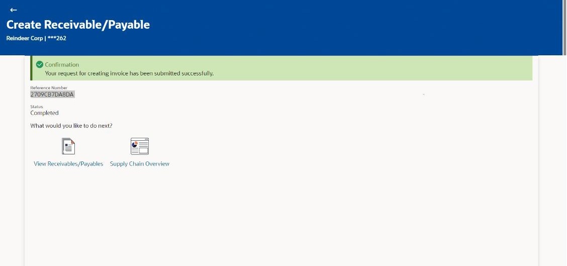

  7. In the Review screen, verify the details, and click Confirm. A confirmation message appears with the reference number and status of the transaction.
    Figure 2-18 Create Receivables Payables – Link Purchase Orders to Invoice and Commodity Details - Confirmation
  8. Click View Invoice link to view a list of existing invoices. Or, click the Supply Chain Overview link to go to the supply chain dashboard.
The invoice is created and submitted for authorization.
