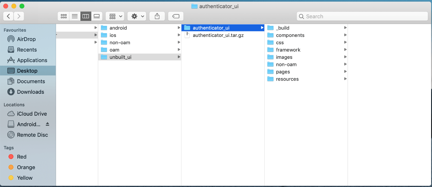

  1. Extract authenticator_ui.tar.gz from OBDX_Patch_Mobile\authenticator\unbuilt_ui.
    The folder structure is as shown:

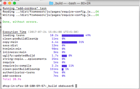

    2. Open the terminal at “_build” level.
    3. Run the following commands:
          sudo npm install -g grunt-cli
      sudo npm install
      node render-requirejs/render-requirejs.js
      grunt authenticator --verbose
    4. After running above commands and getting result as “Done, without errors.” A new folder will be created at “_build” folder level with name as “dist”.
