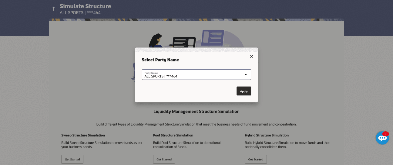

  1. On the Simulate Structure screen, click Get Started under the Pool Structure Simulation section.
    The Simulate Structure - Select Party Name screen displays.
    Figure 3-16 Simulate Structure – Select Party Name
    Table 3-12 Simulate Structure - Select Part Name - Field Description
    Field Description
    Party Name Select the party name and ID from the drop-down list in which the simulation structure must be created.
    By default, the primary party of the logged-in user is selected.
    Note: Only accessible parties are displayed to the user.

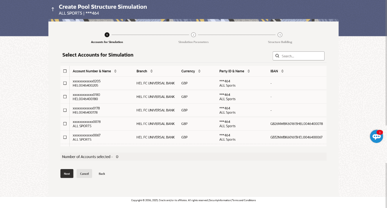

  2. Click Apply, based on the part name selection the mapped account structures are displayed.
    The Create Pool Structure Simulation – Accounts for Simulation screen displays.
    Figure 3-17 Create Pool Structure Simulation – Accounts for Simulation
    The first step of pool structure simulation creation involves searching and selecting multiple accounts from the list to build the pool simulation structure.
  3. Click Search to search and select the accounts to be added for the structure simulation.
  4. Click Next to navigate to the simulation parameters screen.

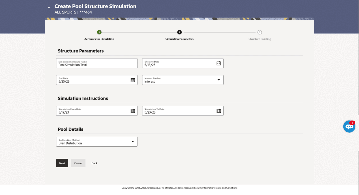

    The Create Pool Structure Simulation – Simulation Parameters screen displays.
    Figure 3-18 Create Pool Structure Simulation – Simulation Parameters
    Table 3-13 Create Pool Structure Simulation - Simulation Parameters - Field Descriptions
    Field Description
    Structure Parameters Information specified in below fields are related to structure simulation parameters.
    Structure Name Specify the name of the pool structure simulation that is to be created.
    Effective Date Select the date from which the account structure execution should take place.
    End Date Select the date till which the account structure execution should take place.
    Pool Details Information specified in below fields are related to pool details.
    Reallocation Method Select the method in which the interest is shared with the participating accounts within the account structure.
    The available options are:
    • Absolute Pro-Data Distribution – Absolute balances of all accounts are considered, and the interest is shared proportionally to all accounts.
    • Central Distribution – The interest arrived at is credited to one central account, which can be any one of the participating accounts or a separate account.
    • Even Direct Distribution – Interest reward is evenly spread across all accounts with positive balances
    • Even Distribution – The interest is evenly distributed among the participating accounts.
    • Fair Share Distribution – If the interest is positive, it is distributed among the positive contributors in the ratio of their contribution and if the interest is negative, it is distributed among the negative contributors in the ratio of their contribution.
    • No Reallocation – No interest is paid back to the child accounts
    • Reverse Fair Share Distribution – If the interest is positive, it is distributed among the negative contributors in the ratio of their contribution and if the interest is negative, it is distributed among the positive contributors in the ratio of their contribution.
    • This field is disabled if the Interest Method is selected as Ratio.
    • The Percentage Reallocation method is also available, but it can be defined only at the pair parent level in Select Reallocation Method & Link Accounts.
    Central Account Number Specify the account in which the interest arrived is credited to one central account, which can be any one of the participating accounts or a separate account.
    This field appears if the user selects Central Distribution from the Reallocation Method list.
    Note: User can search the central account number by account Name, account Number, branch or currency based on the parameters set in the system configuration and displays these details in the search results and the respective fields once the required account is selected.
    Central Account Currency & Branch Displays the currency and branch of the central account.
    This field appears if the user selects Central Distribution from the Reallocation Method list and select central account number from drop-down.
  5. In the Simulation Structure Name field, enter the name of the account structure.
  6. From the Effective Date and End Date list, select the appropriate date to set up the instruction.
  7. From the Interest Method list, select the appropriate method for interest calculation.
  8. In the Simulation Instructions section, select the From Date and To Date for the structure simulation.
  9. From the Reallocation Method list, select the appropriate reallocation method.
    1. If the user has selected central distribution option, select the appropriate account from the Central Account Number list.
  10. Perform any one of the following actions:
    • Click Next to navigate to Create Pool Structure Simulation – Build Structure screen.
    • Click Cancel to cancel the operation and navigate back to Dashboard screen.
    • Click Back to navigate back to the previous screen.

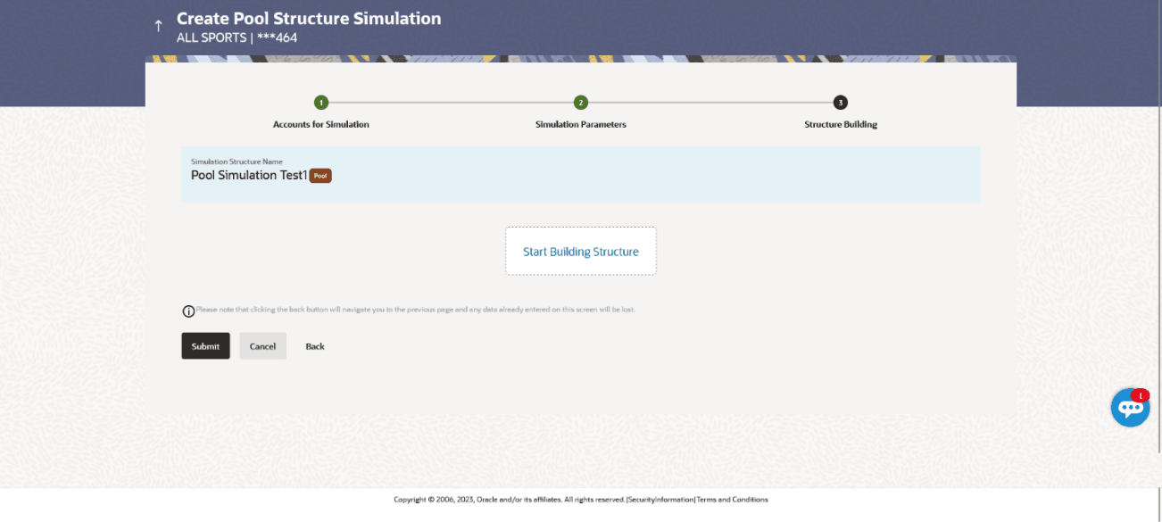

    As a part of following step, the user can build the structure by adding the header and child accounts.
    By default, the Build Structure screen displays in tree view.
    Figure 3-19 Create Pool Structure Simulation – Build Structure
    Table 3-14 Create Pool Structure Simulation - Build Structure
    Field Description
    Simulation Structure Name Displays the name of the simulation structure.
    Simulation Structure Type Displays the type of the simulation structure.

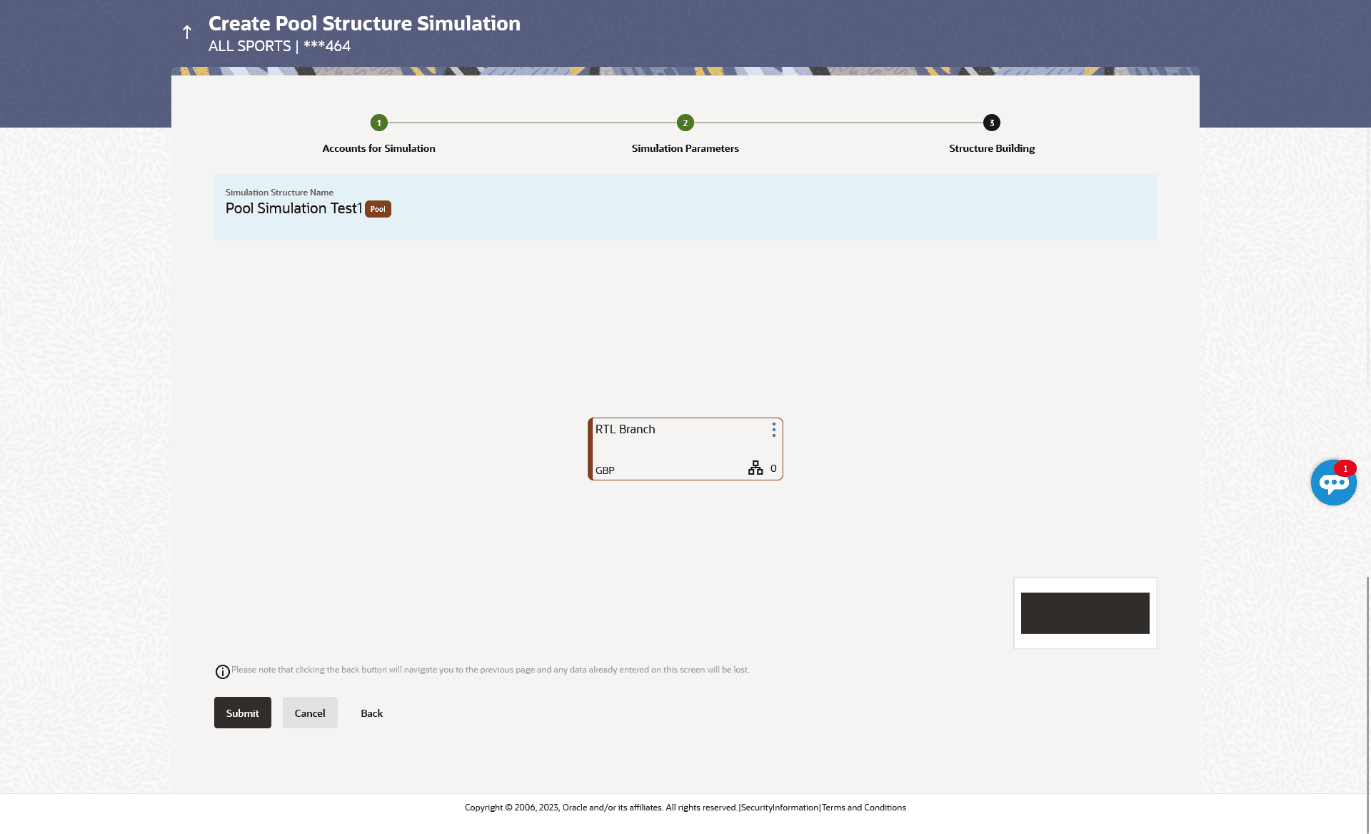

  11. Click Start Building Structure to build the structure.

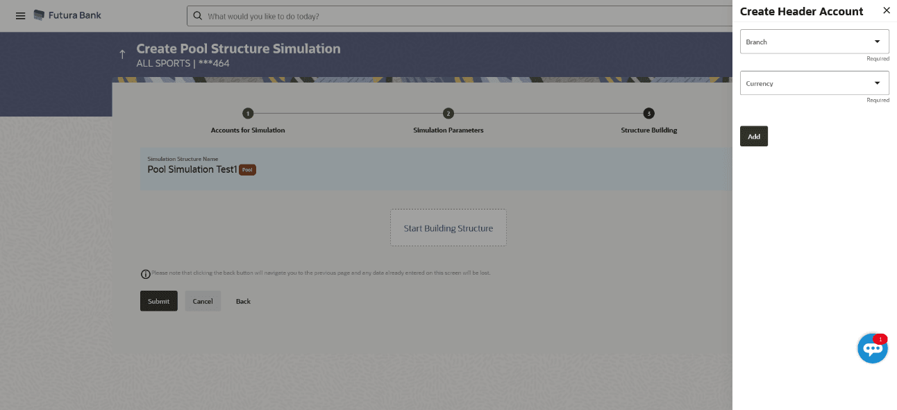

    The Create Pool Structure Simulation – Create Header Account overlay screen displays.
    As a part of following step, the user can create the header account in which the funds will concentrated.
    Figure 3-20 Create Pool Structure Simulation – Create Header Account
    Table 3-15 Create Pool Structure Simulation – Create Header Account
    Field Name Description
    Branch Select the branch name for the header account.
    Currency Select the currency for the header account.
  12. In the Branch field, select the branch name for the header account.
  13. In the Currency field, select the currency for the header account.
  14. Perform any one of the following actions:
    • Click Add, the header account is created and added to the Create Pool Structure – Added Header Account screen.
    • Click Close to close the overlay screen.
    Once the header account is created, the user can further link the child accounts. This screen is available in tree view.
    Figure 3-21 Create Pool Structure Simulation – Added Header Account – Tree View

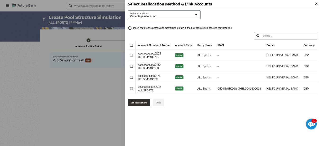

      The Create Pool Structure Simulation - Select Reallocation Method & Link Accounts pop-up screen displays.
    • Click Delink. A delink account pop-up displays confirming the removal of selected account and all the linked child accounts under it.
      1. Click OK, if the user want to remove the added header account.
      2. Click Cancel to cancel the removing process.
    The user can search and select the accounts to be linked to the selected header/parent account. The accounts selected for simulation will appear for linking the accounts.
    The user can either select the accounts directly in the overlay or can use the UI search to filter and select additional records. In this case, the accounts that were filtered using UI search will appear at the top, while those selected before applying UI search will appear at the bottom.
  16. From the Reallocation Method list, select the reallocation method.
    1. Select the accounts that the user want to link to the header account.
    2. In the Search By Party Name, Account Number field, specify and search the complete or partial account details.
      The list of accounts that matches across the fields in the table and select the accounts that the user want to link to the header account displays.

  17. Click Set Instructions. This button is enabled only if the Reallocation Method is selected as Percentage Allocation.
    The Create Pool Structure Simulation –Reallocation overlay screen displays.
  18. Click Build to add the child accounts to the header account.
  19. Click Close to close the overlay screen.

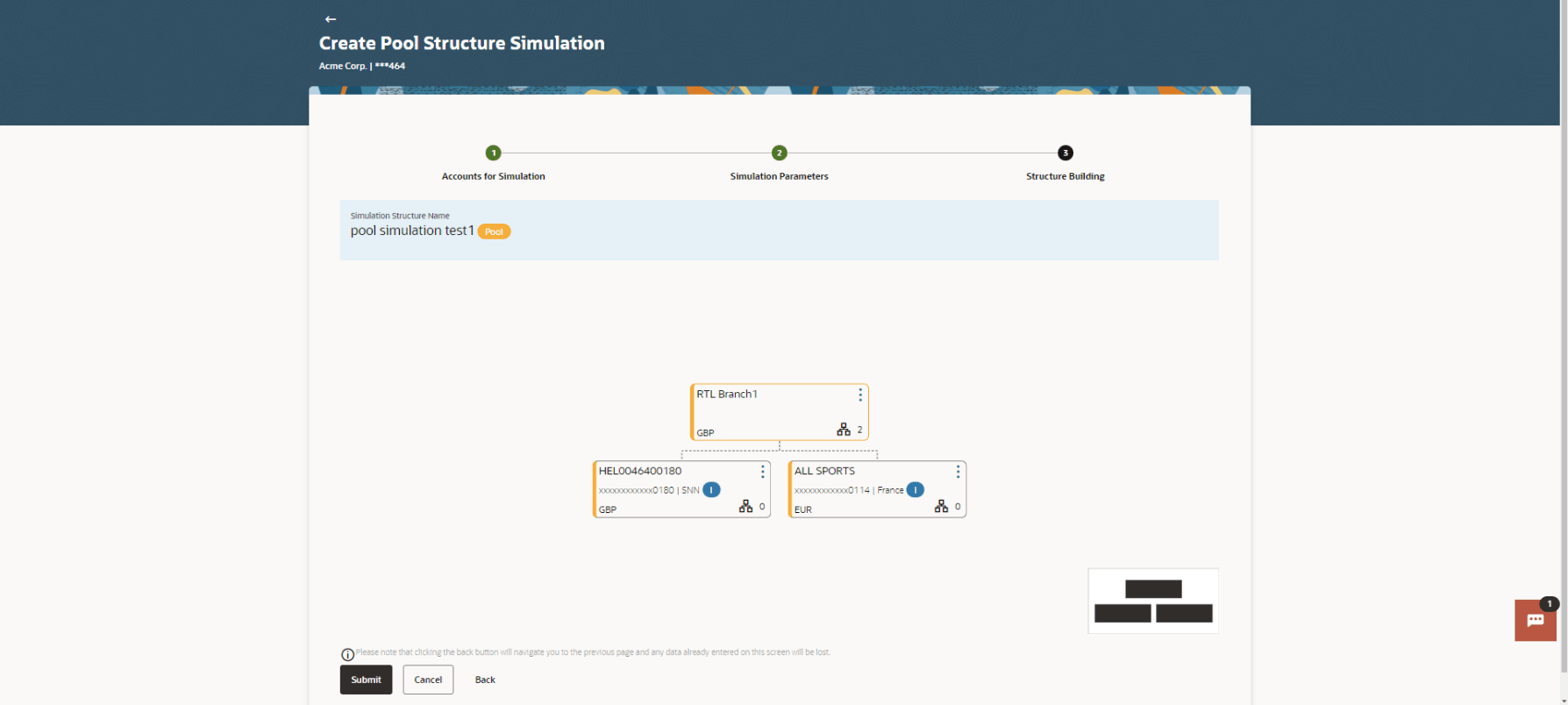

    This screen enables the user to view the added accounts in tree view.
    Figure 3-24 Create Pool Structure Simulation – Submit - Tree View
    Table 3-19 Create Pool Structure Simulation - Submit - Tree View – Field Description
    Field Description
    Notional Header Information displayed on notional header account card in tree view.
    Branch Displays the branch name for the header account.
    Currency Displays the currency for the header account.
    Link Displays the number of the child accounts linked to the parent account.
    Real Account Information displayed on real account card.
    Account Name Displays the name of the account.
    Account Number Displays the account number of the user in masked format.
    Location Displays the location of the account.
    Account Type Displays the type of account.
    The available option is:
    • I: An account which is internal to the bank.
    Account Currency Displays the currency of the account.
  22. Click Kebab and then;
    • Click Link to add the additional child accounts for the selected parent account.
      The Create Pool Structure – Select Reallocation Method & Link Accounts overlay screen displays.
    • Click Reallocation to view the reallocation details for the account pairs. This option will appear only for the parent accounts with the child accounts.

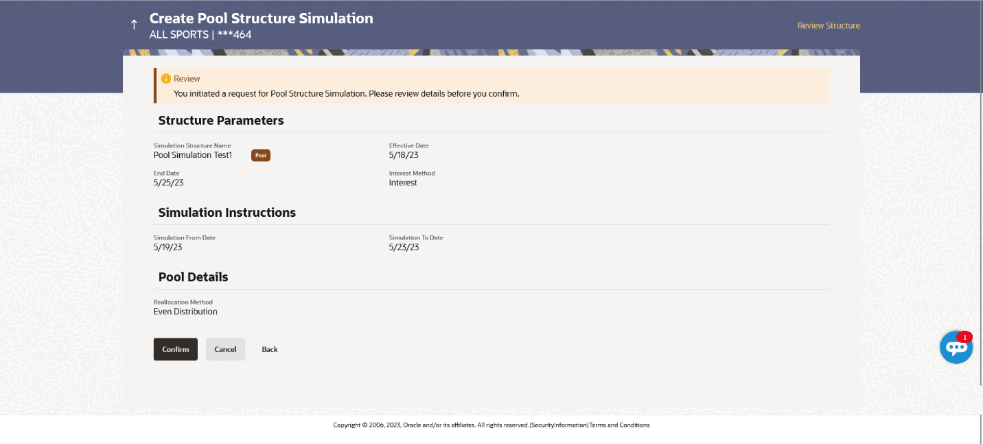

  23. Perform any one of the following actions:
    • Click Submit to submit the pool structures.
      The Create Pool Structure Simulation – Review screen displays.
    • Click Cancel to cancel the operation and navigate back to Dashboard.
    This screen enables the user to review the updated structure simulation details in the new structure.
    Figure 3-25 Create Pool Structure Simulation – Review
  24. Perform any one of the following actions:
    • Click Confirm to create the pool structure simulation.
      The Create Pool Structure Simulation – Confirmation screen displays the success message along with the status and simulation structure details.

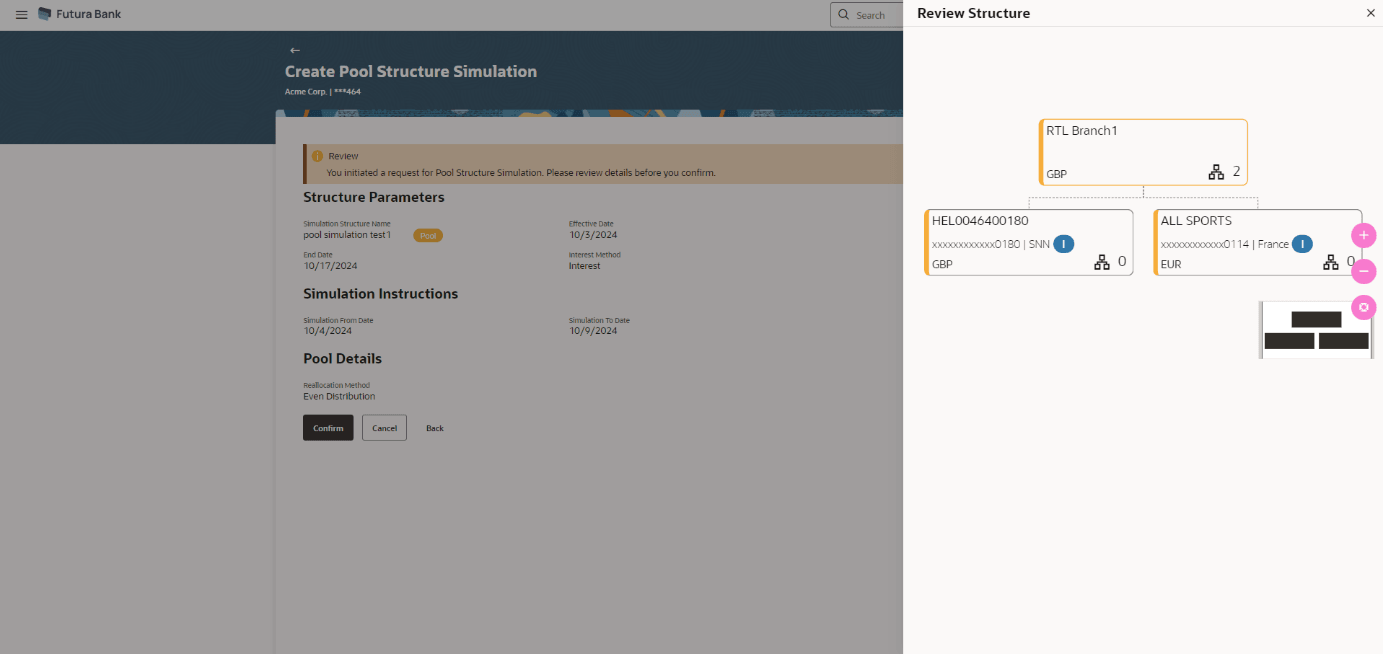

    • Click Review Structure to review the structure.
      The Create Pool Structure Simulation – Review Structure overlay screen displays.
    Figure 3-26 Create Pool Structure Simulation – Review Structure
    1. Click + to zoom in the structure.
    2. Click to zoom out the structure.
    3. Click Fit to fit the structure to screen.
    4. Click Close to close the review structure overlay screen.
