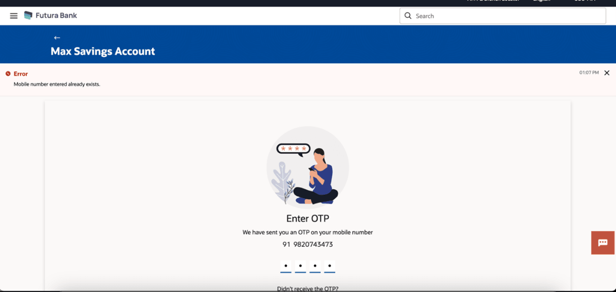

  10. Issue: Mobile number entered already exists
    Assumption: This issue occurs when an existing customer tries to initiate a new application using the prospect flow with an existing mobile number.
    Steps to Troubleshoot: An already onboarded user attempting to use the same mobile number to initiate the prospect flow is an invalid use case. Ask them to log in and initiate the application.
