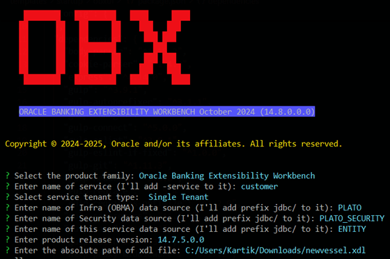

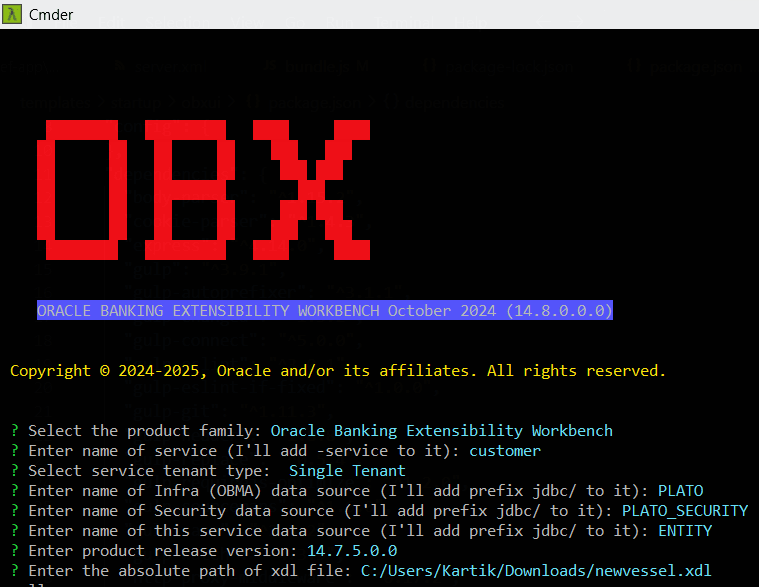

  2. Use the command obx service mn -c.
  3. Once this command is fired, this will take you to next section where it will prompt other set of questions. Answer them accordingly to your setup and requirement.
  4. Once all the questions are answered and path of XDL is given, it will generate a folder inside the extension_home folder.
    Figure 3-9 Extension Home Folder
