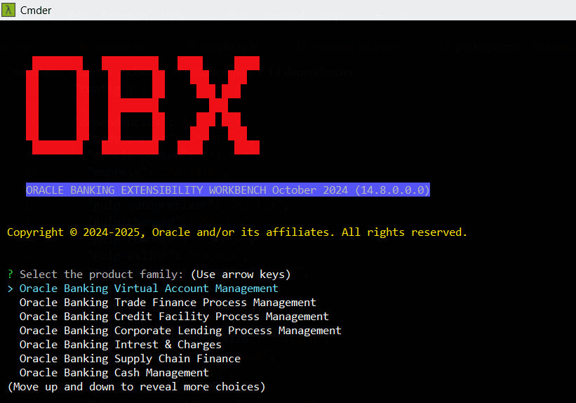

  1. Navigate to same extension_home folder using cmder.

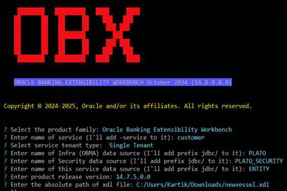

  2. Use the command obx service new -c.
  3. Once this command is fired, this will take you to next section where it will prompt other set of questions. Answer them accordingly to your setup and requirement.

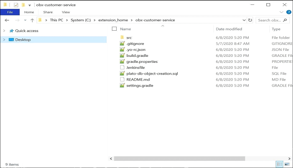

  4. Once all the questions are answered and path of XDL is given, it will generate a folder inside the extension_home folder.
    Figure 3-5 OBX Customer Service
  5. Select the option based on your requirement for question Do you want to create UI component for this service? (Y/n).

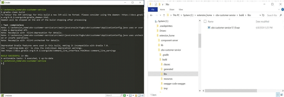

  6. For building the service go into the service folder from cmder and run the command gradle clean build.
  7. This will build the service and we can find the war of the service getting created inside the build/libs directory.
  8. Use this service and deploy it in your environment.
  • DB scripts for the service will be generated inside the folder: \extension_home\obxcustomerservice\src\main\resources\db
