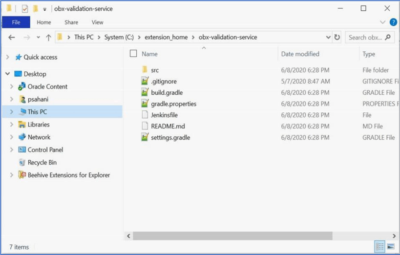

  1. Navigate to same extension_home folder using cmder.
  2. Use the command obx validation -c.
  3. It will generate a folder inside the extension_home folder with obx-validation-service.
    Figure 3-27 OBX validation service

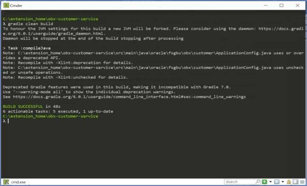

  4. For building the service, go into the service folder from cmder and run the command gradle clean build.
  5. This will build the service and we can find the war of the service getting created inside the build/libs directory.
  6. Use this service and deploy it in user environment.
