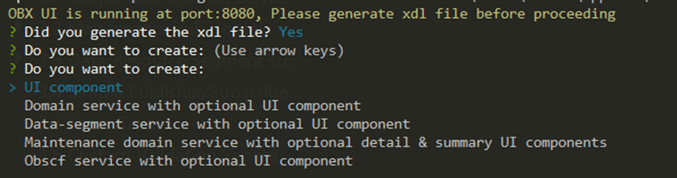

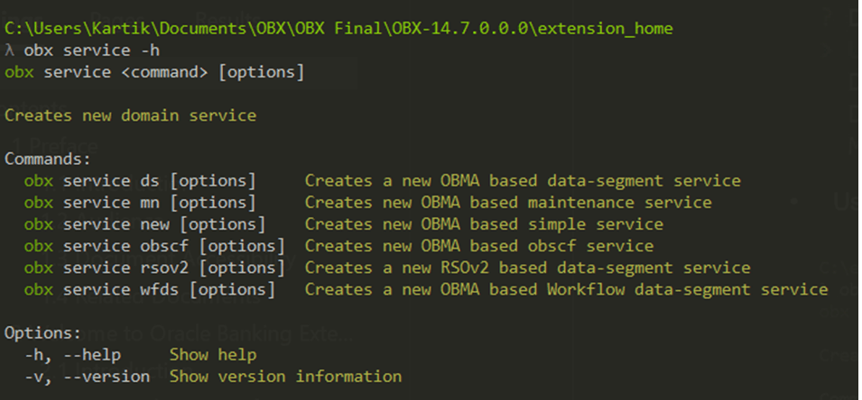

There are two ways to generate the service artifact:
- Select the category immediately after generating the XDL file and proceed.
- Use the service specific command to generate different types.
Both above ways will generate the same artifacts.- Simple Sub Domain Service
