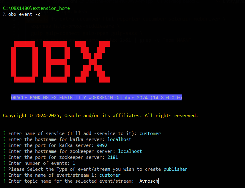

  1. Navigate to same extension_home folder using cmder.
  2. Use the command obx event -c.
  3. Once this command is fired, this will take user to next section where it will prompt other set of questions. Answer them accordingly to user setup and requirement.

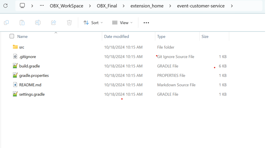

  4. Once all the questions are answered and path of XDL is given, it will generate a folder inside the extension_home folder.
    Figure 3-21 Extension Home Folder
    Figure 3-22 Extension Home Folder
