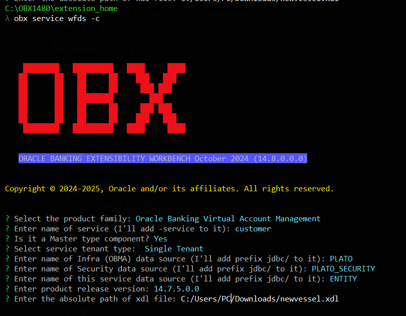

    2. Use the command obx service wfds -c.
      Figure 3-16 OBX service wfds -c
    3. Once this command is fired, this will take user to next section where it will prompt other set of questions. Answer them accordingly to user setup and requirement.
    4. Select the type of component according to user requirement.
