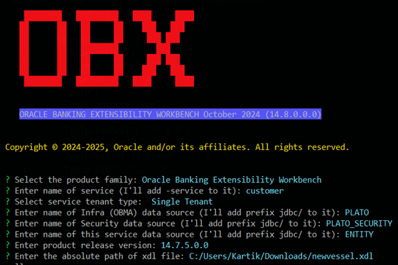

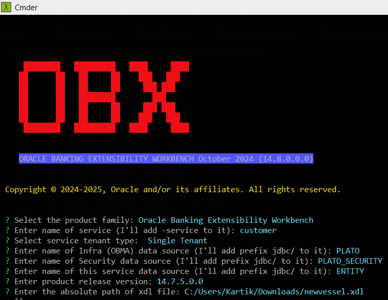

  2. Use the command obx service mn -c.
  3. Once this command is fired, this will take user to next section where it will prompt other set of questions. Answer them accordingly to user setup and requirement.

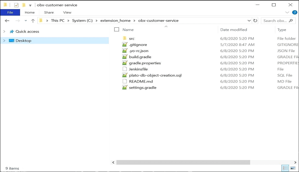

  4. Once all the questions are answered and path of XDL is given, it will generate a folder inside the extension_home folder.
    Figure 3-9 Extension Home Folder

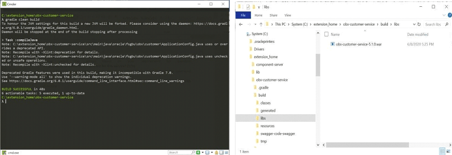

  6. For building the service go into the service folder from cmder and run the command gradle clean build.
  7. This will build the service and we can find the war of the service getting created inside the build/libs directory.
