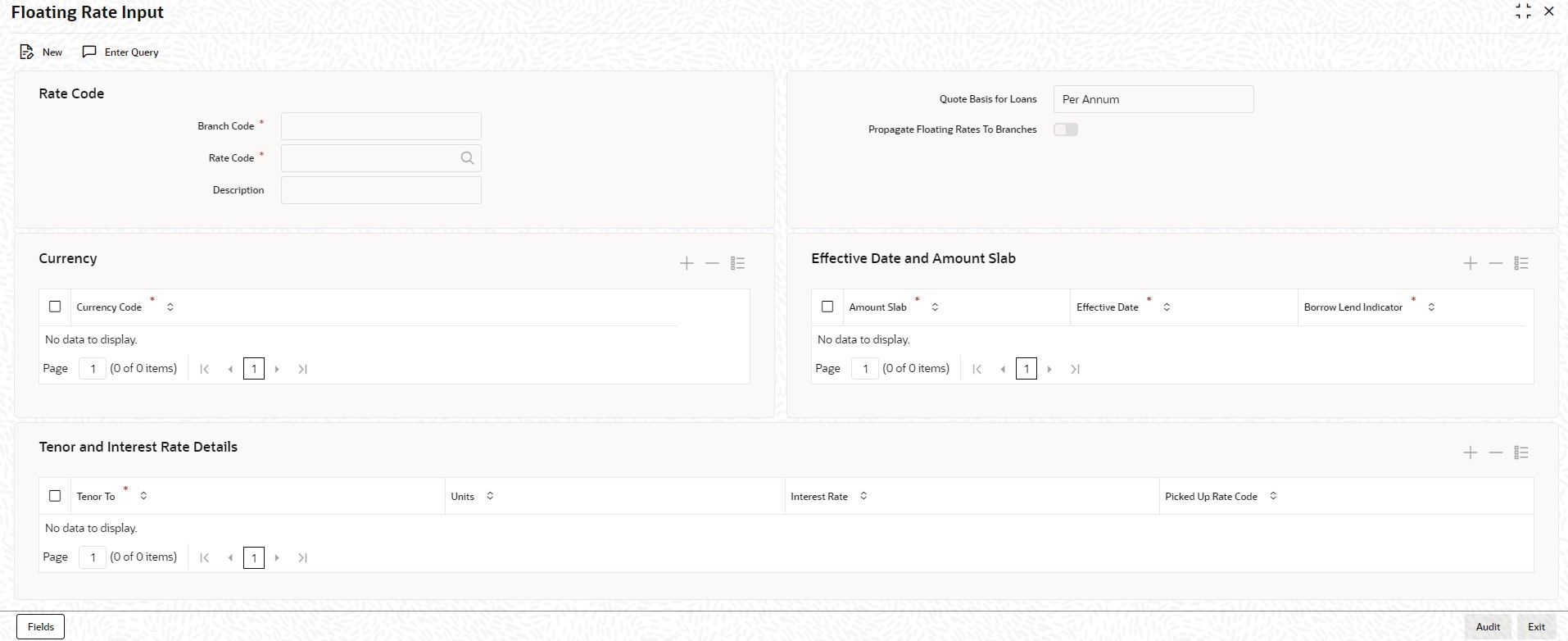

- On Homescreen, type CFDFLTRI in the text box, and click Next.The Floating Rate Input screen displays.
Figure 1-19 Floating Rate Input
- On the Floating Rate Input screen, specify the fields.
The fields, which are marked with an asterisk, are mandatory.For more information on fields, refer to the field description table.
Table 1-22 Floating Rate Input - Field Description
Field Description Rate Code Click Search and specify the rate code to identify the floating rate being defined from the list of values. The list displays all valid rate codes maintained in the CFDFRTCD (Rate Code Definition) screen. Branch Code The system displays the branch code. Description The system displays the description of the rate code. Quote Basis for Loans Select the quote basis for loans from the drop-down list: - Per Annum
