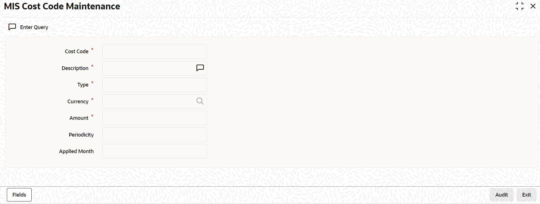

  1. On Homescreen, type MIDXCODE in the text box, and click Next.
    The MIS Cost Code Maintenance screen displays.
    Figure 1-57 MIS Cost Code Maintenance
  2. On the MIS Cost Code Maintenance screen, specify the fields.
    Table 1-71 MIS Cost Code Maintenance - Field Description
    Field Description
    Type Specify the type from the drop-down list.
    1. Number of Transactions -
      This applies to calculating the cost of processing a transaction involving an account.
      The user can indicate the amount to be considered as the notional cost for each transaction.
      For example, The user may incur a certain amount for every transaction process of savings account in a particular category. This cost could be different for processing transactions in a different type of savings account or for current accounts. The user should define different MIS Cost Codes and link them to the appropriate account classes.
    2. Number of Events -
      The notional cost applicable for processing an event can be defined as a cost code. This applies to a contract.
      For example, for processing an event in the life-cycle of a loan, the user may want to attach a certain cost. The user can define a cost code for it and link it to the product.
      Similarly, The user can define a different notional cost for different events in the life cycle of a contract. Thus, the user can have a cost code for initiating a loan, one for liquidating interest, and so on, and link them to the product with the appropriate event codes.
      The defined notional cost will be taken as the cost per event.
    3. Duration -
      These changes are applied to a contract. The notional cost, in this case is calculated on the basis of a specific duration. This notional cost is defined by a cost code. The following example illustrates how this cost is applied to a contract.
      For example, if a loan is live for a month, the notional cost incur is a specific amount. The user would define a duration-based cost code, define the periodicity as monthly. For every month a loan linked to the cost code is live, the notional cost will be applied.
    Cost Code Specify the cost code. The notional cost, along with the currency in which it is expressed should be indicated in the cost code. The cost will be applied based on the Cost Code type, Refer to the following table unresolvable-reference.html#GUID-C1C4BE2C-FC39-49AB-8F74-A342A9F1B8CE__TABLE_AQM_4D4_BTB
    If a currency conversion is involved during reporting, the prevailing conversion rate will be used.
    Description Enter the description of the cost code.
    Periodicity Select the periodicity from the drop-down list:
    • Monthly
    • Quarterly
    • Half Yearly
    • Yearly
    This is the periodicity at which the costs defined have to be applied. In the profitability report, the notional cost reported would depend on the periodicity defined for the cost code. For a Quarterly, Half Yearly, or Yearly periodicity, specify the first month of application. The subsequent application months would be computed based on this.
    Currency Click Search and specify the currency from the list of values.
    Amount Specify the amount.
    Applied Month Select the applied month from the drop-down list.
    • January
    • February
    • March
    • April
    • May
    • June
    • July
    • August
    • September
    • October
    • November
    • December
    Table 1-72 Cost Code and Description
    Cost Code Type Description
    Number of Transactions The amount is taken as the cost per transaction.
    Event The amount is taken as the cost per event.
    Duration The amount is taken as the cost for the period defined as the periodicity, for the cost code.
